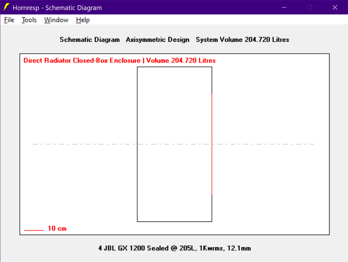

I just built a simple box and put the woofers on the opposite sides. Some pictures here: https://www.diyaudio.com/community/...-or-any-other-suggestions.393398/post-7235632
The box looks the same on the other side except there is a Speakon socket.
Thanks, that's interesting. Are the drivers opposing? Like: <- | box | -> with driver faces? Or -> -> ? Do you have to change phase for this to work and not cancel out the wavefront? I'm curious how this would work if expanded to 4 drivers in a tall skinny obelisk on a footer. It could still technically lay on its side too with the drivers facing out.

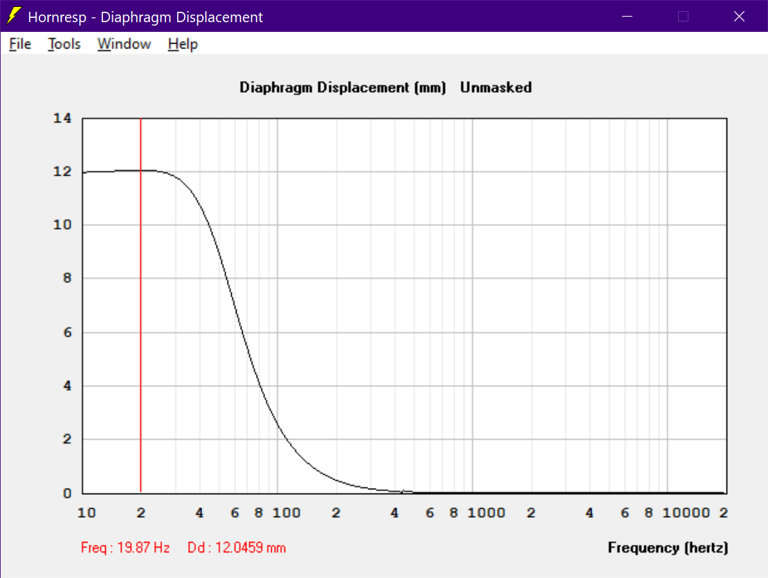

I guess my only last hurdle is the idea that my current ported subs tuned at 20hz will have a phase change at 20hz. So adding some sealed cabinets may be a challenge. I've not mixed before. Most folk straight up just recommend against it and just go all sealed. Any practical ways to integrate a bunch of 12" drivers in sealed cabinets like this with my current ported 20hz subs? I suppose if it's too much trouble, I may just explore sealing those subs to make it a non-issue or re-purpose.
