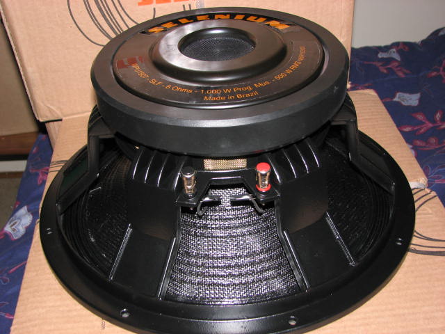

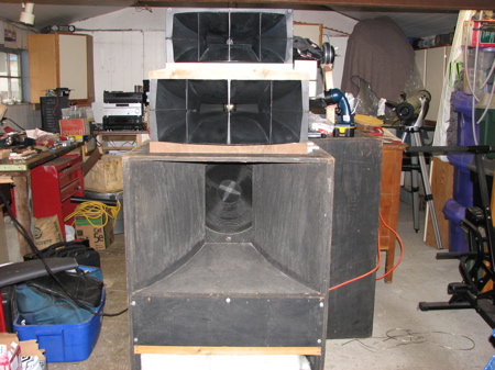

Perhaps, and I have been known to take things to an extreme. I really don't need deep bass. 40 or 50Hz is fine for me. In my big system I use the A7 cabinets with a Selenium woofer for my 'satellites'. That woofer has more oomph than the 515, albeit at the compromise of the vocals, but many are happy with that as a stand alone speaker. I just like to take it up a notch and add that same woofer in the A4 cabinets to 'fill-in' the low end rather than add EQ and possibly overwork the woofer. To each his own M and no one here can tell you what sounds good to you. Either way, the 515 is a great driver, no bones about it.
