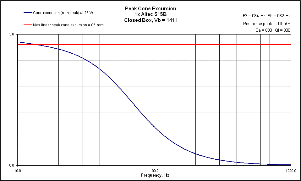

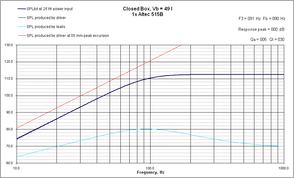

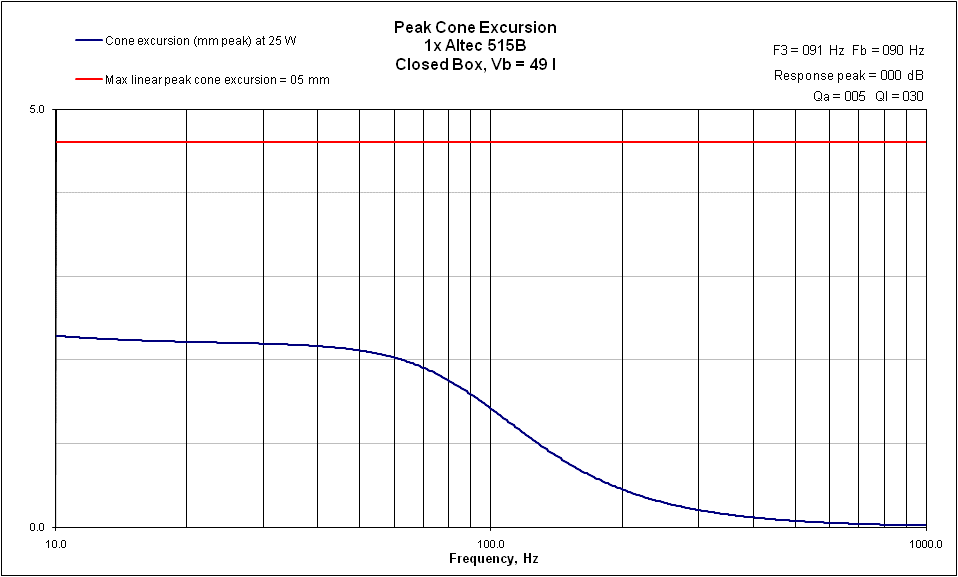

this is my first attempt at designing a sealed enclosure for Altec 515B. I have done some search and the overall conclusion was that "no bass can be obtained" from the driver.
Based on attached model from Unibox, I am confused by the statement, because according to the model, at the design frequency of 40 Hz, the woofer can be equalized to 100dB, without exceeding the Xmax. Thus the overall response is still 100dB.
The parameters used were:
Fs 24.30 Hz
Re 12.00 Ohm
Qms 6.62
Qes 0.23
Sd 890.0 cm2
Vas 757.0 l
Xmax peak 4.60 mm
(Le) 0.01 mH
(Le2) 0.00 mH
(Re2) 0.00 Ohm
Nominal Power 25.0 W
If there is any better sealed alignment, please let me know.
What am I missing?
Kindest regards,
M

You aren't missing anything and your simulaion looks correct. A little mental math would confirm: in a sealed box fs and Qt track for resonance frequency changes. That is the ratio of fs to Qt is fixed. If you start with a Qt of about 0.2 (a little less than Qes) you want to raise it to 3 or 3.5 times that. That would require a box that shifts resonance from 24 to the 75 to 90, as you have done. No more variables to play with, so that is about the only allignment available.
The "no bass" comment comes from the 3dB down at 90, simulated response that you see. The woofer was designed for high efficiency and possible horn loading, so it not a natural subwoofer. If you want to go the EQ route, that will be fine, assuming you have the excursion to get the output you need.

I figured when I read this earlier that the idea was that 100db was enough for the OP and that with the 25W posted, that corresponded to around 45 Hz.
If the speaker was eq'ed down above 45Hz (as opposed to being boosted at low frequencies) to be flat from about 45Hz up then the -10db point would be around 25Hz. Whether that can be achieved however I'm not certain.
That should result in something that can produce 100db at 1M with 25W input (and stay below xmax)... Was that the intention?

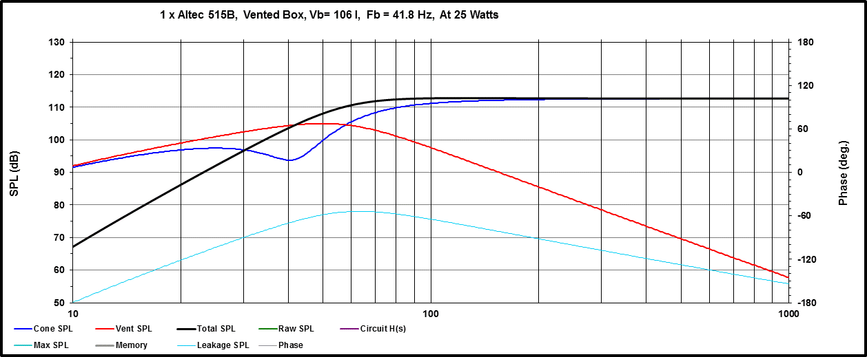

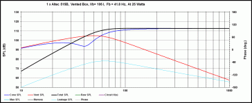

Why have you chosen a sealed enclosure?
I have built hundereds of enclosures for the 515 and it's brother the 604e-g and vented always gave the best LF response.
The 515 has a very low cone mass and gets it's low free air resonance from the spension elasticity thus sealing the enclosure negates the elasticity of the suspension and the low mass cone develops little enertia to extend the bass.
There is a bunch of science to ponder, once a transducer has fallen below it's piston cuttoff, wavelength/pistion size it moves from "constant velosity to constant accelarator" IE above cutoff motion to output is a factor of 2 and below that ratio is squared, factor of 4.
This is a long way to say that sealed box loading of the 515 interfears with the designers cone mass to suspension elasticity to get the best constant acceleration lf extension

Hi M.
The enclouser we used for studio monitors with 515 or 604 (identical LF transducer) was a 6 cubic ft box with a 3/9 inch port with a port depth of 2 inches, tunes to 37hz.
Looking for enclouser info on the 604 could be valuable as it's LF driver is identical to the 515
If I was going with a sealed box 5-6ft is where I would go.

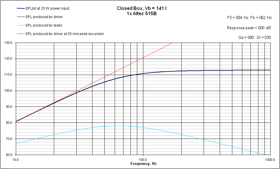

Hi Greg,
I have simulated sealed enclosure with 5 cu ft per your suggestion. Can you please help me understand the graphs. It appears that my Qtc now is about 0.545; consequently, the output is higher at the lower frequencies for the price of earlier roll-off at higher frequencies. Additionally, I am exceeding Xmax at the lower end. But, I can adjust the enclosure volume down to be within the Xmax.
So the only improvement I see from the simulation is higher output at lower frequencies at the nominal 25 W.
Am I overlooking something? One more question - I have found inconsistent specifications regarding maximum power 35W and 75W. Do you know which is correct?
