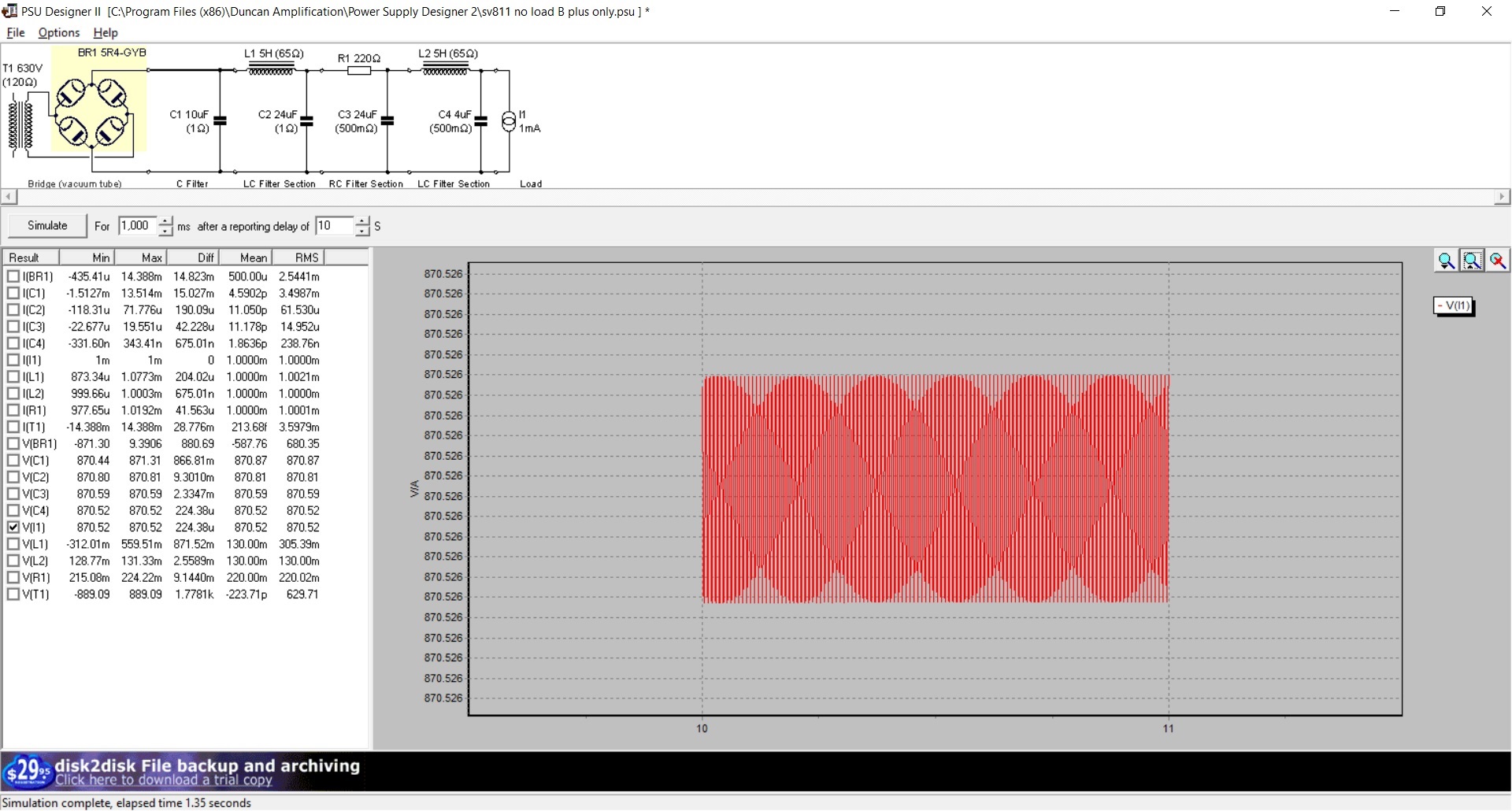

I modeled my latest design for the B+ power supply in PSUD. Took a screenshot of how it shows the PS will perform at no load (actually a 1mA load). Runs about 870V. Then I breadboarded it and got 865V. Pretty close!
When loaded, I think I will get a bit over 600V B+. The schematic calls for 500, but the SV811 seems like it would be happy with 600. Am I wrong about that?

I was surprised to see this statement in the help section on the transformer/rectifier: "For full wave rectifiers, use the voltage for one side only. For example, if the transformer off load voltage is 350-0-350V (700V end to end), the correct value to enter is 350."
Does that seem right? Isn't that for a half wave rectifier?
Think about it this way:
For a full wave rectifier with the CT grounded, fold it in half and it kinda looks like two half wave circuits in parallel.

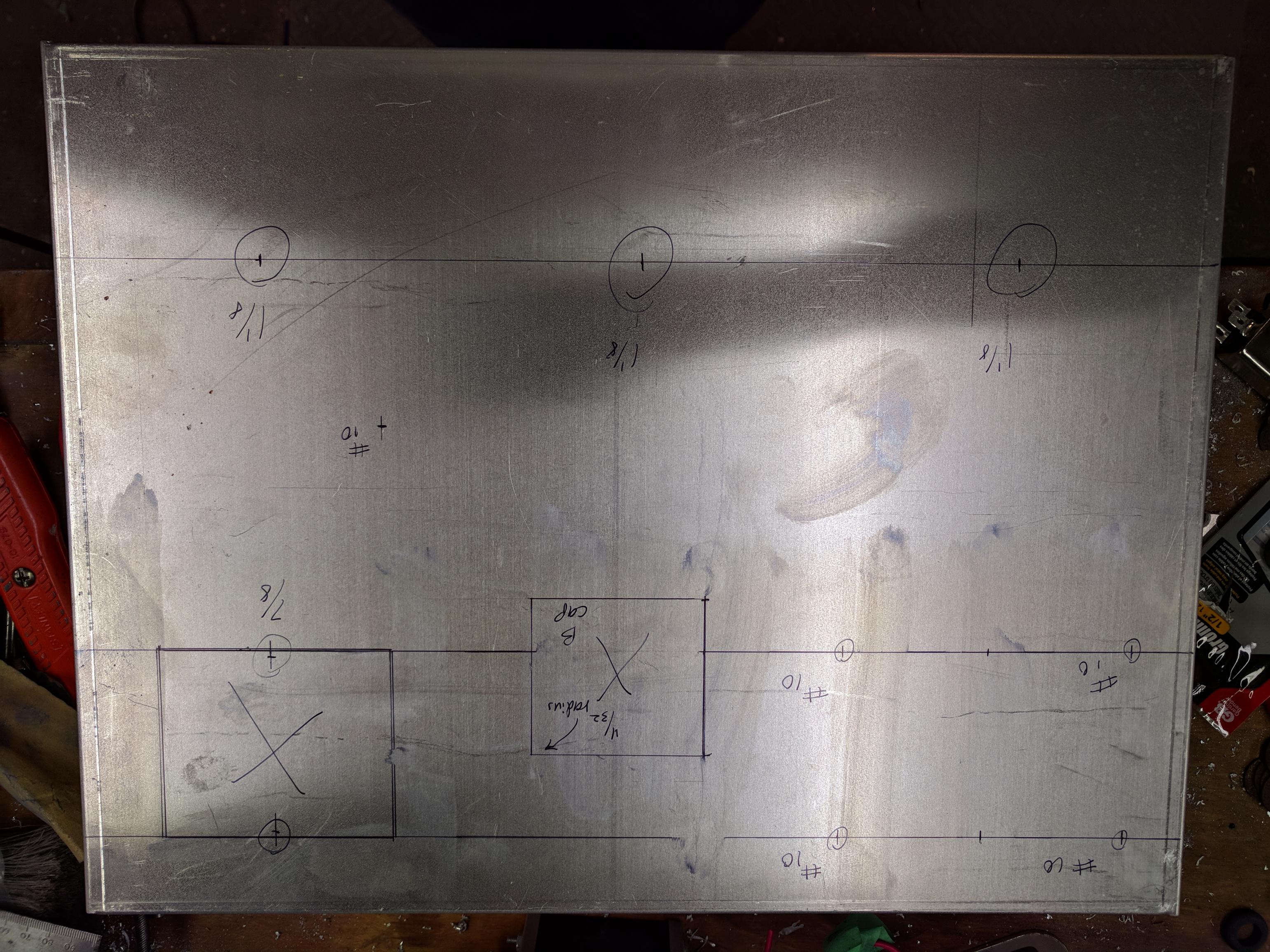

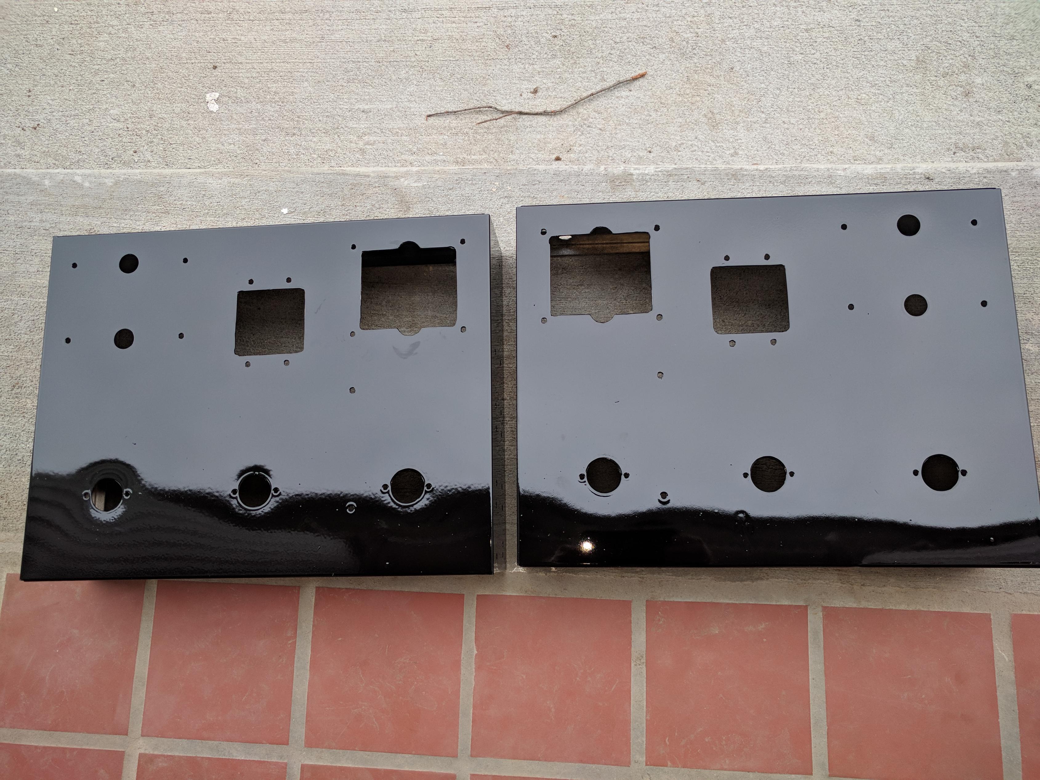

Making some progress on the SV811-10 monoblocks. Pics show one chassis with the layout diagram drawn directly on it. Then I skipped over a lot of tedious cutting, drilling, sanding, priming and painting to show the bookended pair after shooting with a couple coats of two-part urethane.

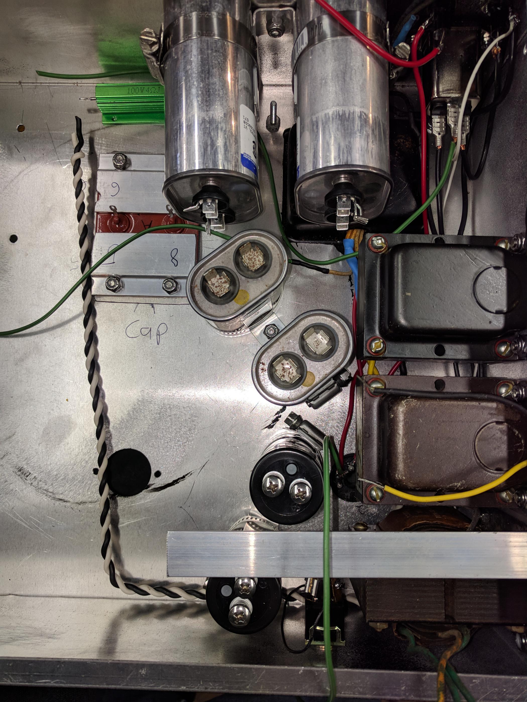

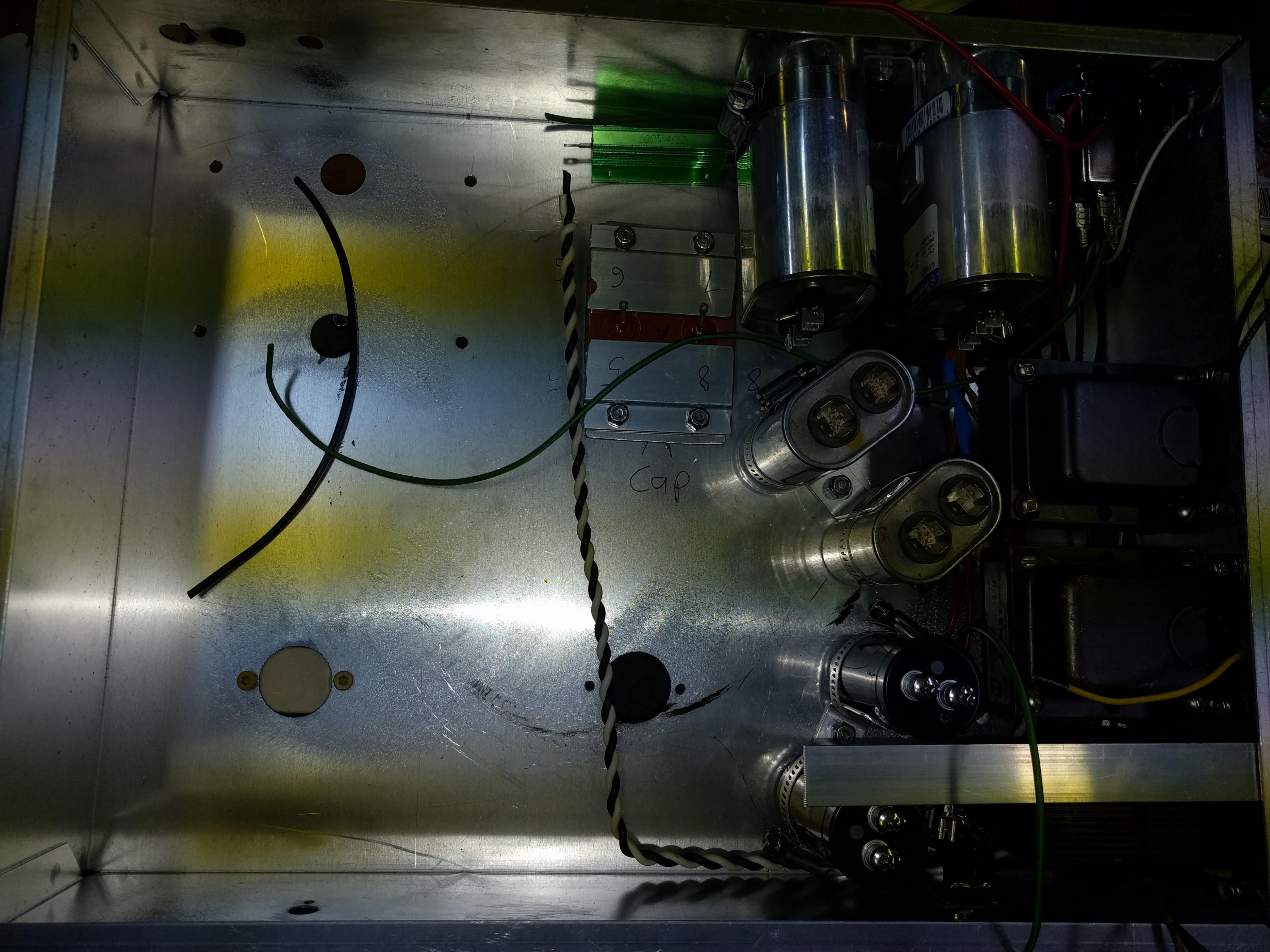

Power supply coming along
Then the last two are bottom views showing most of the power supply components squeezed in. I was able to get everything into the outside third of the chassis, with a little distance from the driver tube.

Because of the tube layout, there will be a few inches between the 6EM7 and the SV811. Where should the coupling cap go? Close to the driver? To the SV811? In the middle? Or does it matter?

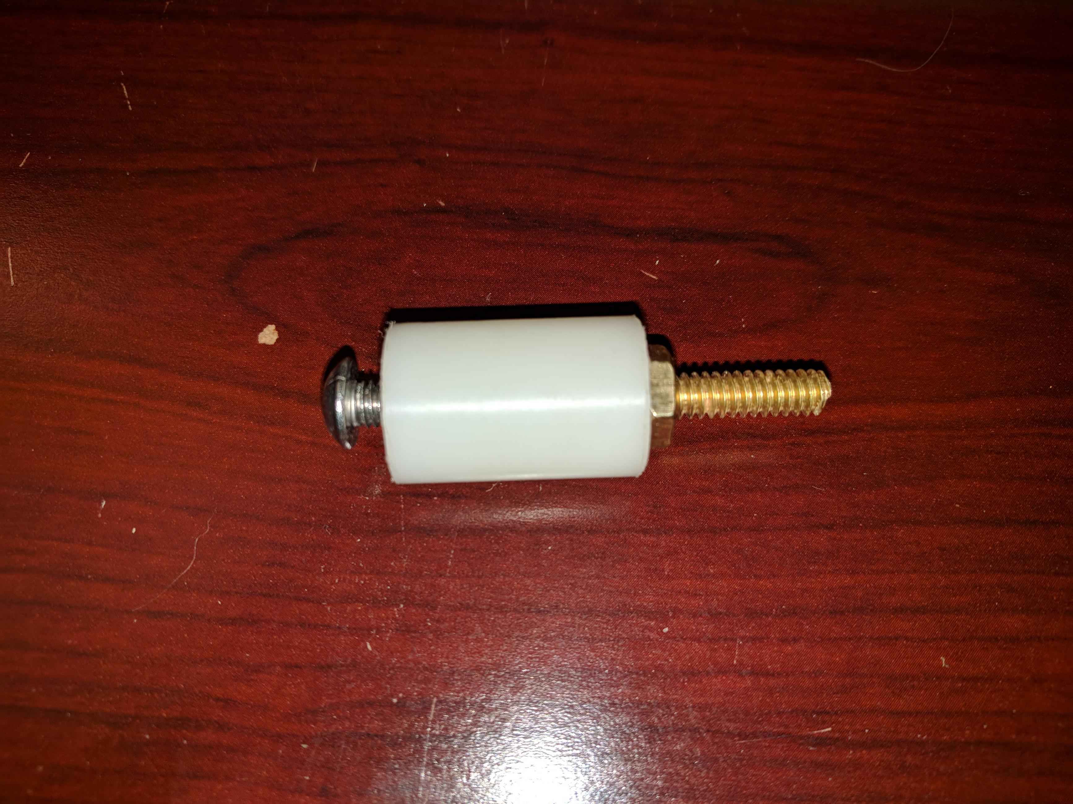

Tonight's winner in the category of "ridiculously over-engineered"
I want a point to bring all the power supply grounds to, and I want it off the chassis. I didn't have anything suitable, so I made a pair of the little guy in the pic. It's a piece of acrylic stock, center drilled on the lathe, then tapped 10-32 on one end for a button-head machine screw to attach to the chassis, and tapped 10-24 on the other end for a brass stud to collect all the ground leads. Ain't DIY great? Imagine a production shop taking an hour to make a pair of stand-offs!
That’s the best fun of this pursuit, taking care of the unique needs of ones own design. Nice work!

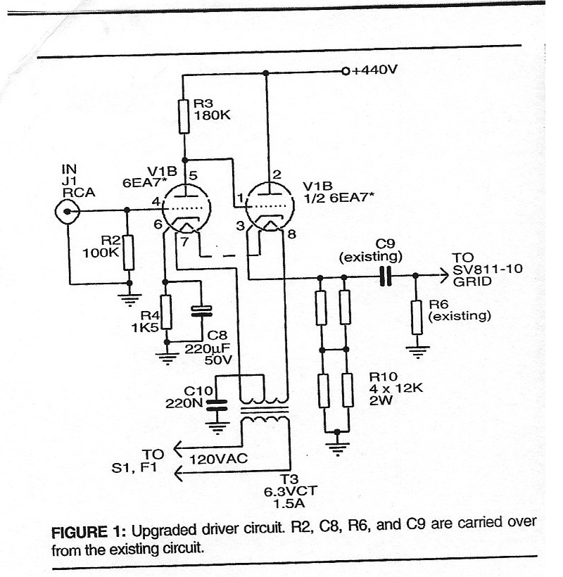

In the Vacuum Tube Valley schematic (SV811/SV572 SE1), Eric Barbour uses 4 33k resistors in parallel to get to 8.25k.
In the second Glass Audio schematic attached here, he uses 4 12k resistors in parallel/series to get to (I think) 12k.
I'm sure there is a good reason for the multiples, but what is it? Is it just a power handling consideration? But even if that's the point, couldn't I just use a single 5W or 10W of the appropriate value?
Lewis

Some well respected designers have asserted that paralleled resistors sound better... but in this case I’m pretty sure it was a cost saving measure. The design was intended for a budget minded builder. And too, the number is sometimes hard to hit with a single piece.
