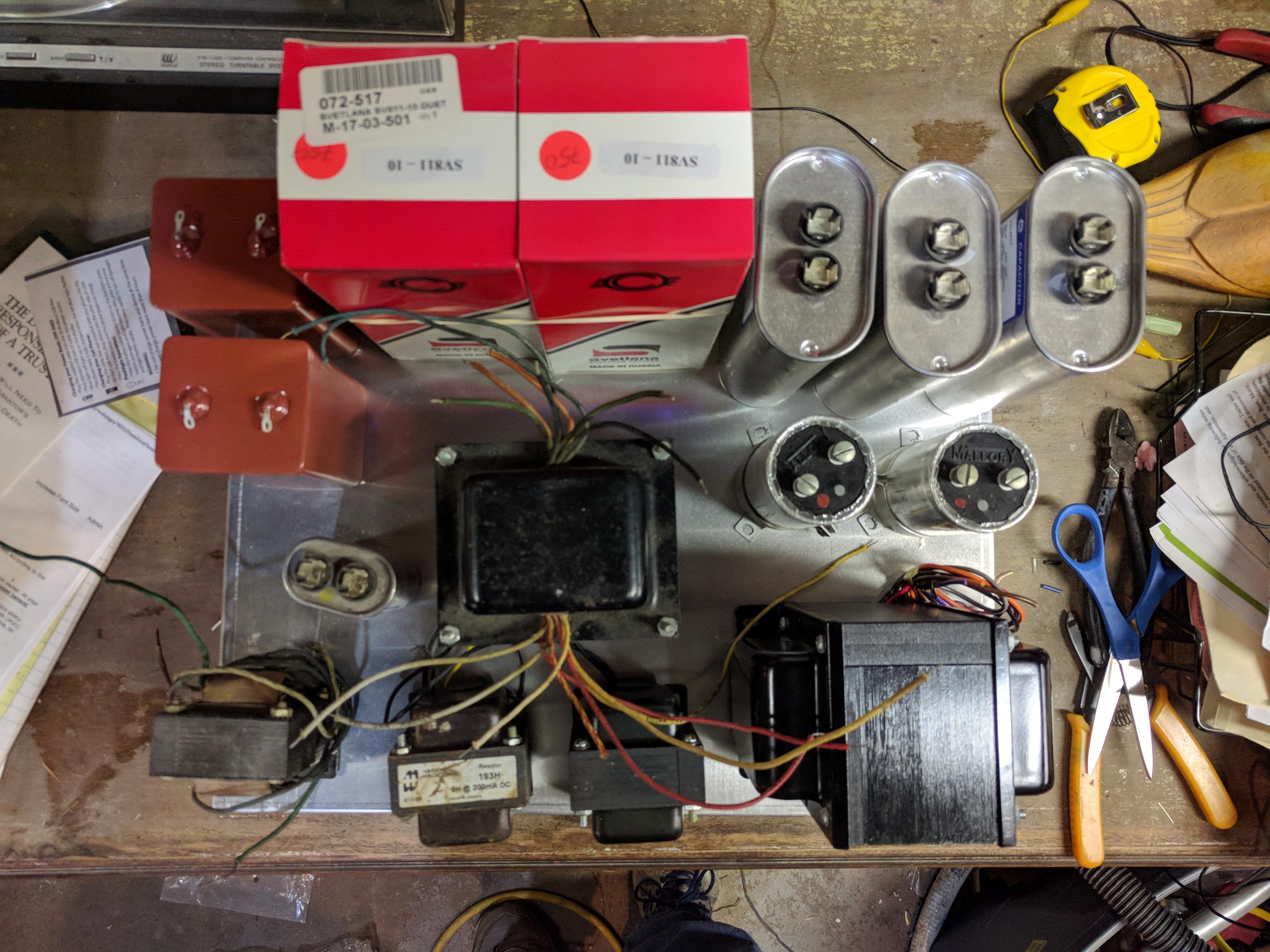

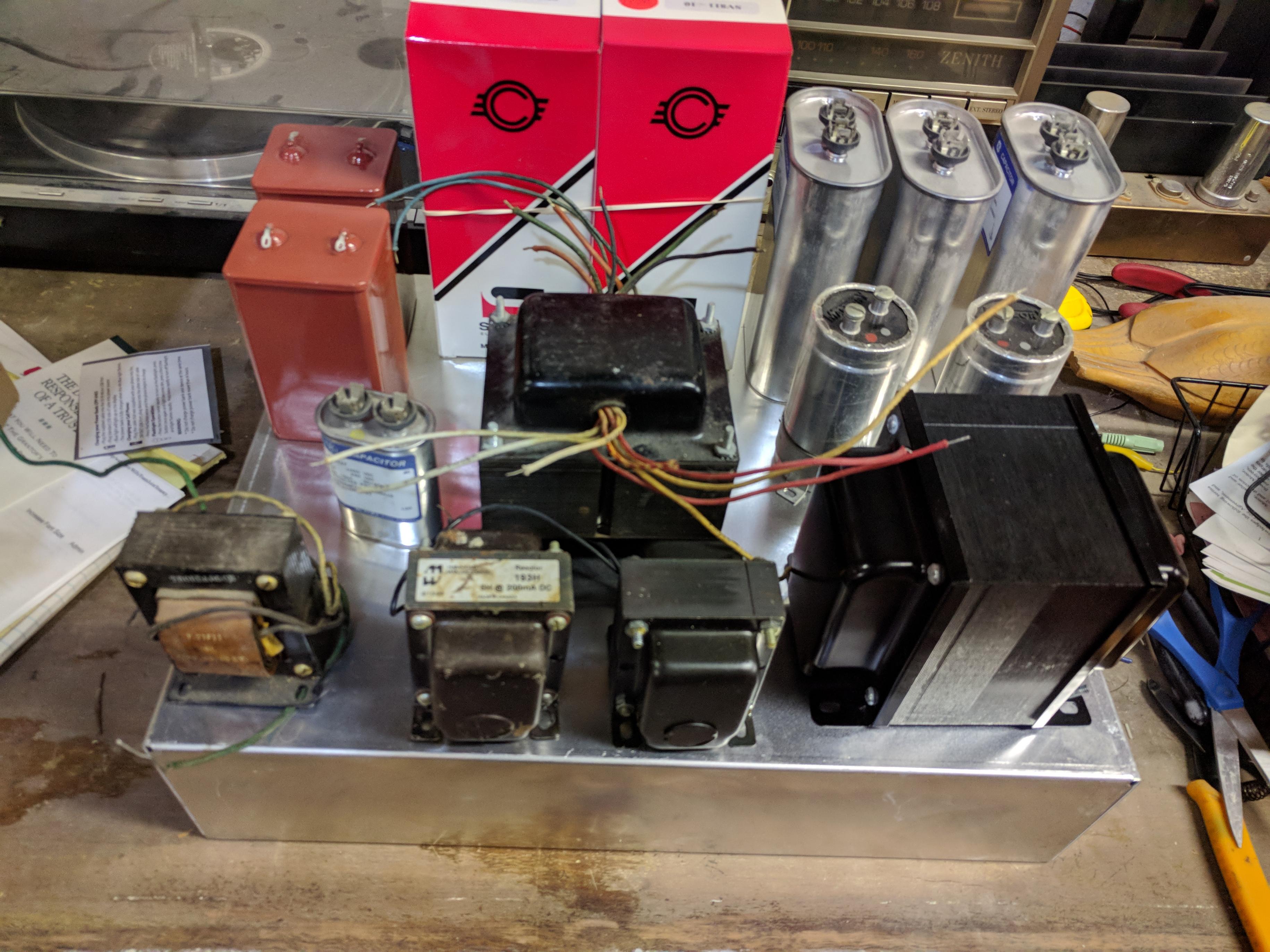

In a sort of pre-layout exercise, I put most of the big items on one of the 17 inch by 13 chassis that I'm planning to use for these monoblocks. Some of these things will be mounted inside, like the filament transformer, the chokes, some of the "smaller" caps, but it's still kind of daunting from just sheer space considerations, not to mention actual thoughtful layout considerations!
It look good Lewis!
I’d call that compact. My last monoblocks used twice that surface area! You can see pictures under a search: Plitron SE outputs...

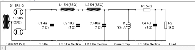

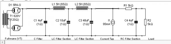

Full wave rectification in PSUD
I was surprised to see this statement in the help section on the transformer/rectifier: "For full wave rectifiers, use the voltage for one side only. For example, if the transformer off load voltage is 350-0-350V (700V end to end), the correct value to enter is 350."
Does that seem right? Isn't that for a half wave rectifier?
The help page is correct.

The only downside to full wave rectification is that your transformer has to be larger in that you can only use one side at a time. With bridge rectifiers you need physically less iron.

Thanks, jdg123.
After I thought about it a bit, I had one of those light bulb moments. I understood this stuff better 20 years ago, but it is slowly coming back. I still don't know exactly how to model the loads, but I think I'm close enough on the design that I can breadboard it and see how it actually measures.
