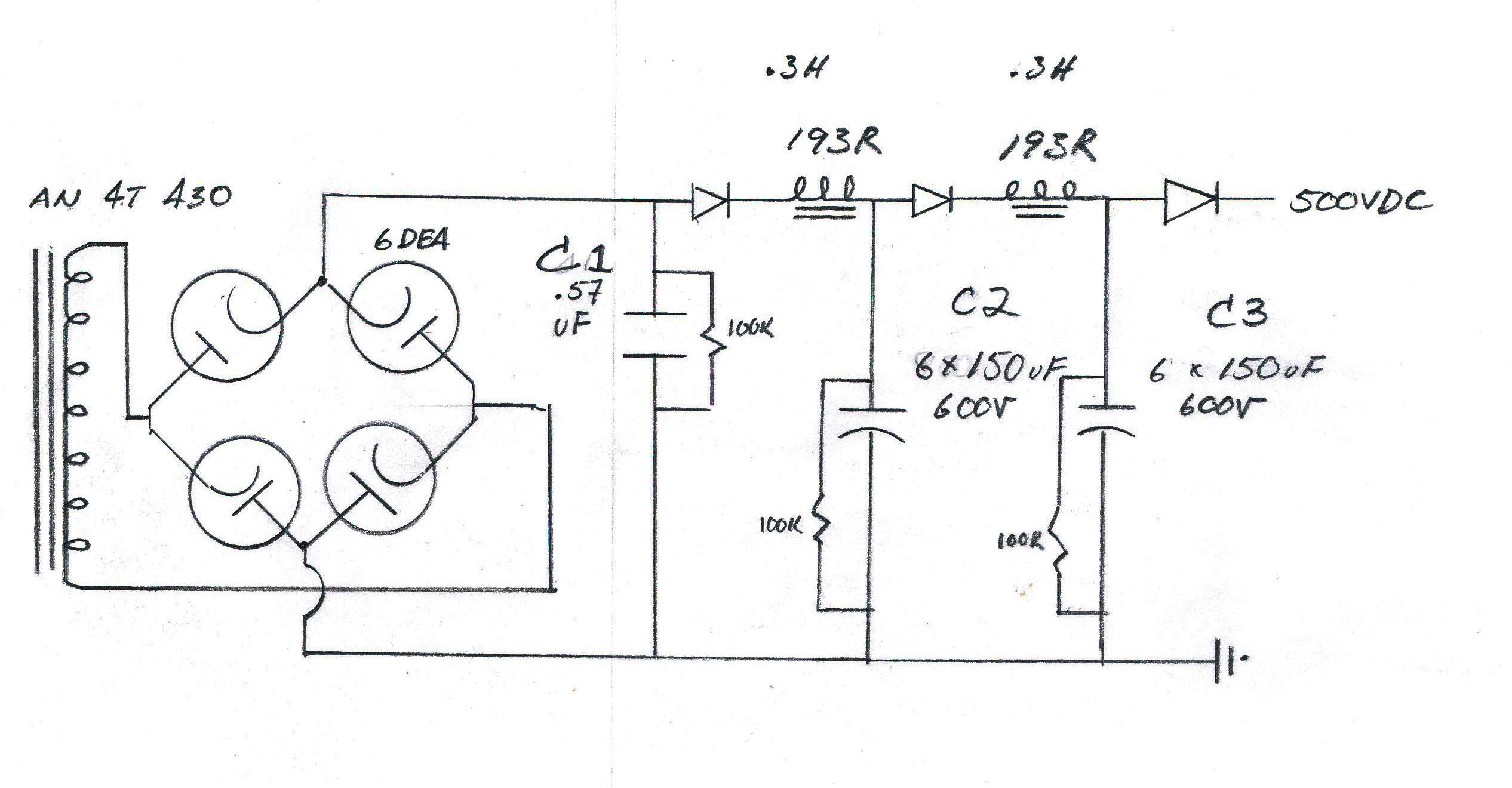

jdg,
Interesting stuff. I flipped through all the VTV issues this afternoon looking for a follow-up, because I remembered that there was one. Just didn't realize it was in a different mag! I'll have to pull out my stack of GAs to see if I have that issue.
Pardon my ignorance, but what are the 6DEAs in your PS schematic?

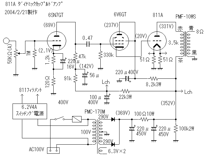

that’s a nice project, but it will not work with SV811-10.
Best regards
Karsten
Yes this is for 811a.
