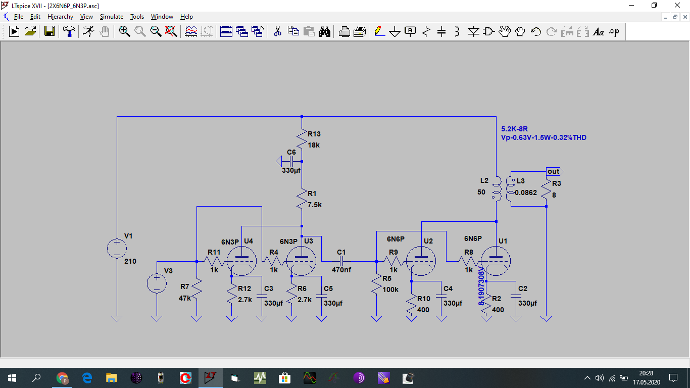

rplate,

rplate,In your first post you ask for help and some fine experienced people have come forth to lend a hand and you question what they have to say.
I meant no disrespect by any means, so please excuse me, if it felt that way from my previous posts.
I would suggest that unless your hell bent on using the tubes you have a quantity of you simply listen to those with experience.
I hear you.
Let's put it this way at this point in my shoe box I have GU-50, 6P1P, and 6P3S output tubes, are they worth trying? Maybe I can use 6N6P as a driver?
Or should I look for different tubes to obtain satisfactory results?
6P1P are nice little tubes of the 6V6/6P6S family (basically 6AQ5 with the noval base). Search for El Cheapo amp on this forum, for example.
6P3S are of 6L6 family - not great, not terrible (that's my personal opinion, a lot of folks love them).
GU-50 are actually very good (though ugly), but they are not for beginners.
You can, but that would be very far from optimal.
As I understood El Cheapo could work with 6P1P and 6NxP (x = 1,2,3)? Are there any good examples of 6P1P in SE configuration? Or it lacks power?
You can probably make it work with those tubes, but all three of them are sub-optimal.
12AT7/ECC81 is quite unique - it has high amplification factor (which you need for this design) while plate resistance is still reasonably low (which is also a good thing).
If I absolutely had to stick with 6Ns, I would probably choose 6N2P (with appropriate schematics modifications, of course)
Look for 6V6 or 6AQ5 SE amps.
Or it lacks power?
1.5-2W in triode mode, about twice as much in tetrode.

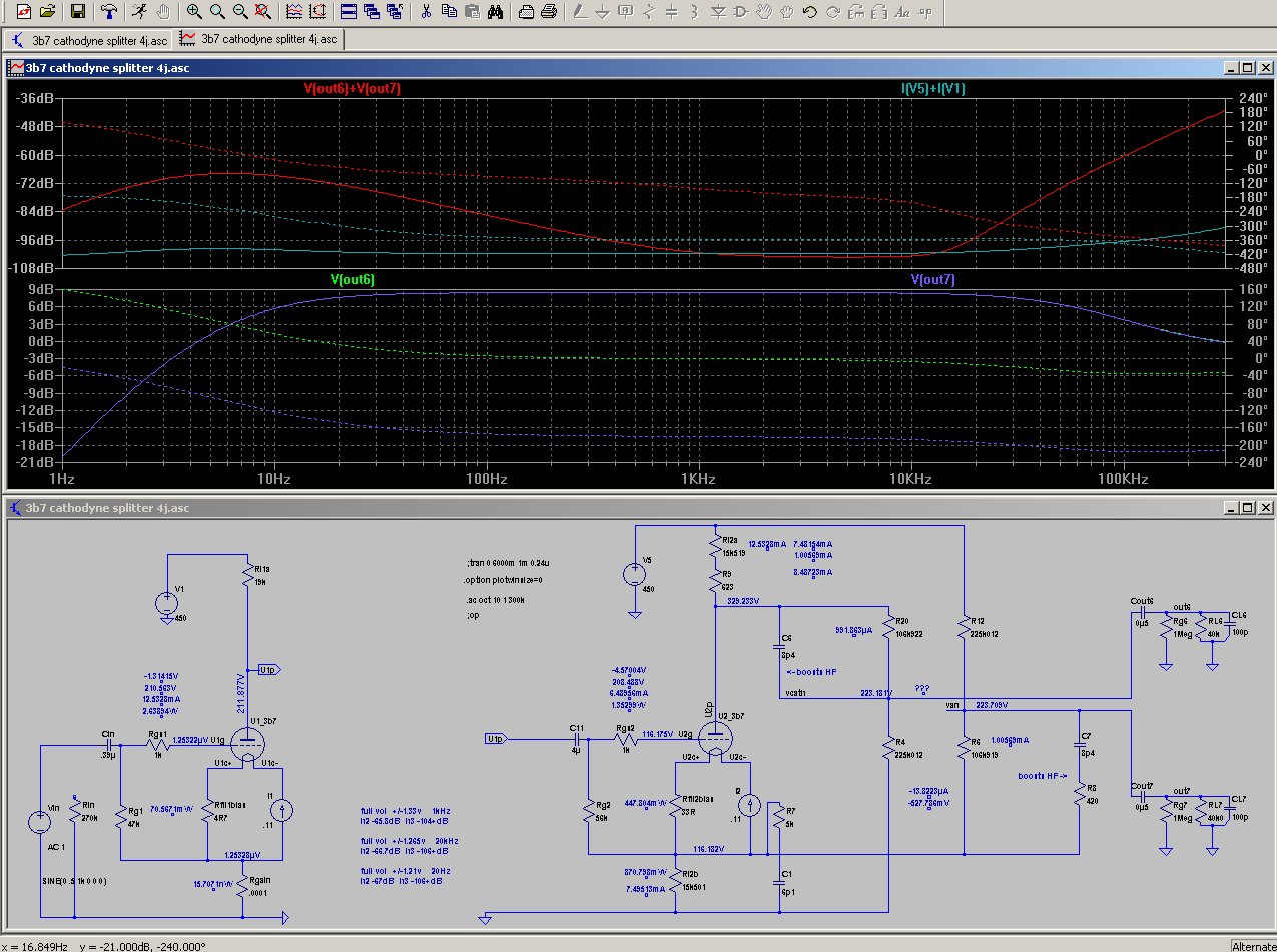

If there is one thing you should learn it is that current travels in loops. This has massive implications on physical circuit design, and particularly layout. The same schematic can sound completely different when lain out differently, mostly around hum, noise and stability.
Given that current travels in loops, try and find two operating points for your valves such that the variation in the current usage of the second stage is exactly equal and opposite to the usage in the first stage, powered from a common source.
This means the current now simply circulates within the circuit, no matter what the volume is set to, and all that your power supply ever does is provide a steady constant bias current.
Sound quality should thus be less dependent on how good the power supply and earthing arrangements are, because no signal is sharing that loop.

MarekH,
Usually the driver stage has less quiescent current than the output stage quiescent current.
And usually the driver stage signal current is less than the output stage signal current.
You are not going to get any power drain cancellation that way.
Please give us an example of a 2 stage amplifier where the currents are opposite in phase and equal signal current values (and I do not mean the obvious topologies of a Push Pull Output stage, nor of an LTP phase invertor stage).

6A3sUMMER,
The first stage and splitter on Norman Koren's TENA amplifier is an example where you have both gain and run at constant current. The variation in current usage by his first gain stage is equal and opposite the variation in his splitter so the whole lot runs at constant current.
We were asked for opinions and as I see it, the fundamental flaw in single ended designs is that they modulate the power supply. The fundamental flaw in push-pull designs is that they start equally unbalanced.
What I'd was suggesting was to design that away.
The following attached sacrifices most of its gain to set up a directly coupled push-pull next stage (although that's not exploited here - this is just an example building block with the values tweaked to prove a point). It takes a 0.5v unbalanced input and outputs balanced 1.3v outputs sat on a 223v dc rail to hang the next stage on.
The stated objective was to have a bit of fun designing something and having access to LTSpice means being able to test it and see how the dynamics move around long before having to worry about committing to hardware.
