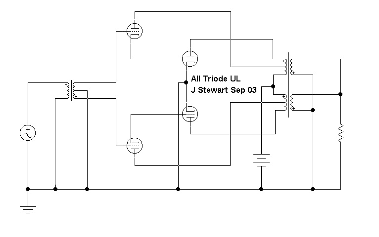

All Triode UL
Something for the experts here on to puzzle over.😀
Well John,
1) I expect the output triodes are transmission tubes that idle with a positve grid; and a lot of grid current (say 2-5 mA).
I gave my pair of 100TH to Peter van W. He trades valves; I did not want a transmission studio after all . .
I have used 814 in the past with a ECC88 white-cathode follower with direct coupling.​
So that explanes the output drive;
2) next the connection of the input cathode follower to the UL tap . . . There is a whole lot of thinking around so called super-triode outputs (or named different, I cannot recollect quickly enough, but bear with me); where there is a triode that is used as anode resistance of a pentode input (high Rp) where the anode is connected to the output transformer primary; the result is a feedback loop. The feedback forces a triode even while the output also is a pentode . So this connection can have a effect in the loop of really giving feedback.
3) to finalize the puzzle, the input transformer must give all the gain, say allow an output well above +26 dB. I am no certain if that input stage to the coupling transformer should be with a pair of pentodes or that the input could be a triode.
Anyway, it looks like Mr Nelson Pass gave us a new puzzle. . .

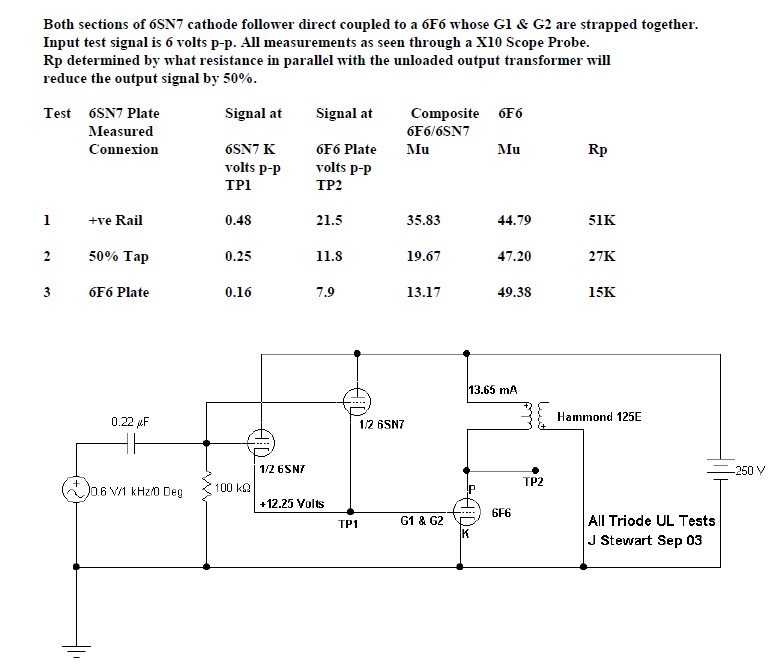

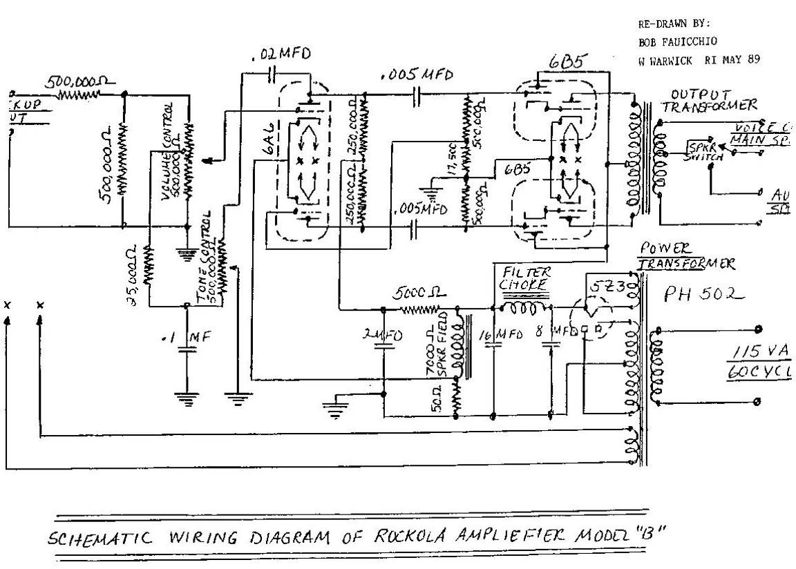

Triode Al is on the right track. So here is the real deal-
All Triode Distributed Load & Class A2 Positive Biased Triodes July 2017
The all triode distributed load (UL) circuit is something I looked at about 15 years ago. I had seen in the old tube manuals back more than 60 years ago some rather odd power tubes. These would include the 6AC5 & 25AC5, a pair of very high mu power triodes. Others are 6B5, 6N6G & 25B5, 25N6G.
All are now quite expensive, I guess the collectors need them to keep the old stuff running. I wondered about simulating them with easy to get tubes. If one thinks of it, most power pentodes when run as triodes with G1 & G2 strapped together have quite a high mu. I checked some 6F6s in that mode & found mu to be about 50, so OK for some kind of trial. If we check the old tube manuals we find that the recommended driver for the 6AC5 was the 76, a medium mu triode. The 76 is the same as the 6P5G but on the older base.

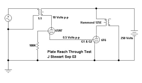

The trial circuit is quite simple, a 6F6 DC driven by the cathodes of parallel sections of a 6SN7GT. The anodes of the 6SN7GT could be alternatively connected to the B+ supply, the OPT CT or the plate connexion of the 6F6. That varies the amount of NFB applied to the anodes of the 6SN7GT. The resulting reach thru to the 6SN7GT cathode is (1/mu). I’ve put the test circuits & results into attachments.
I never did build the complete PP UL circuit. I realized that the driver plate(s) direct to B+ version was used commercially in some radios in the 30s. If you look at the base connexions on the octal 6N6G & 25N6G they are identical to many common power tubes such as the 6F6GT, 6K6GT, 6V6GT & so on. In the circuit they are self biasing, no cathode resistor required. But they did not catch on. Probably more expensive to build these tubes than the corresponding pentodes with there two cathodes, etc. An interesting exercise.
Here are links to a family of tubes suitable for an all triode PP UL amp.🙂 The Rockolab amp could easily be modified for UL. Or a similar amp with discrete triodes. So all triode UL is a project for the keeners on DIY.

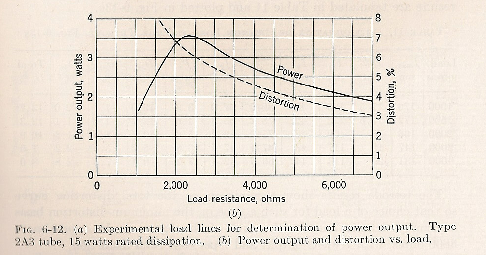

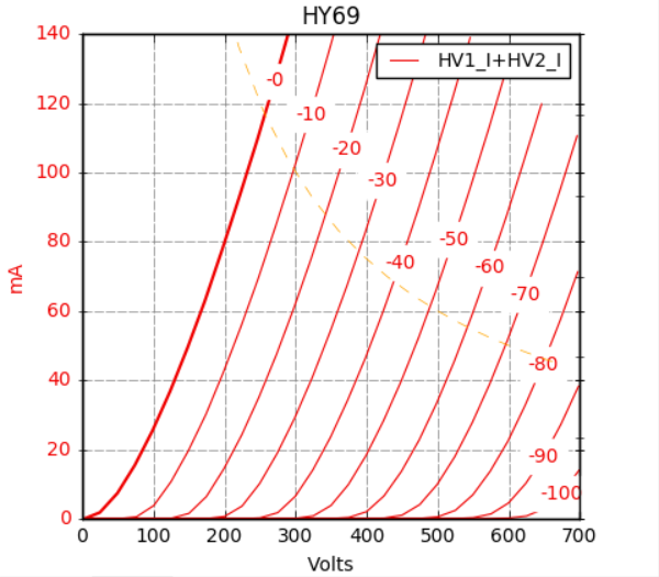

Theory shows max power for an ideal triode occurs at Rl = 2rp. For practical toobs that would be closer to Rl = 2rp. If the Rl is pushed lower D% increases rapidly. Applies to All Triodes, whether voltage or power amps. All well covered in something called a book!😀

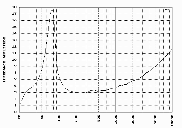

Triodes can be loaded over a wide range, keeping in mind a lower limit on Rl.
Pentodes are very particular. Since the load will probably be a loudspeaker, pick a steeper than recommended load (lower impedance). That will allow for the speakers impedance in its enclosure to go high at the ends of the spectrum as it often does. I use a speaker simulator network to test amplifier stability.😀
