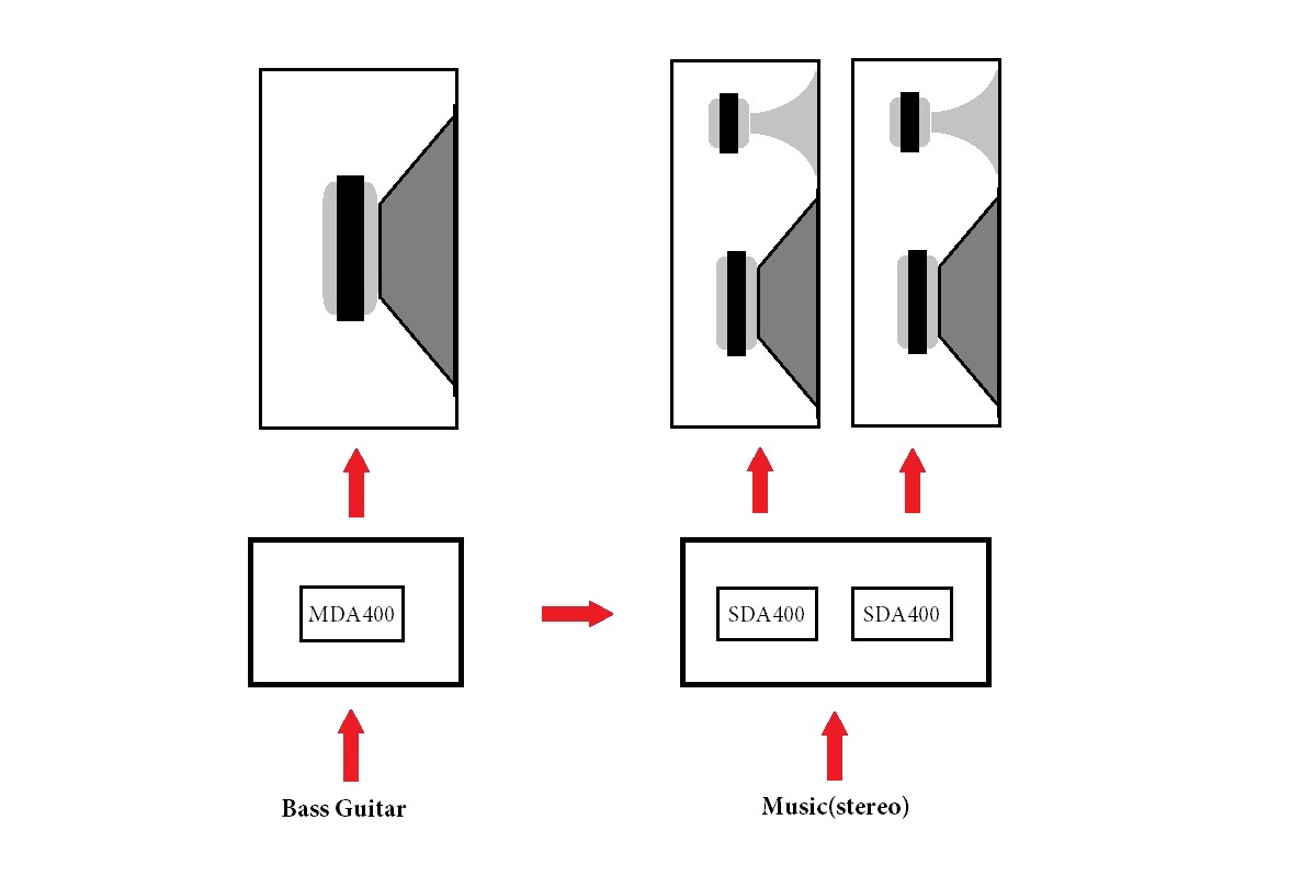

FYI , I will use a Kit1(52v) + 2 othrr sda for 4 woofer, then the 2 remaining dps (42v) for the 4 VSSA, so 8 chanels in total with 4 dps, 4 sda and 4 vssa
Ah.. yes, then i send 2xDPS-400 (as KIT-8) for VSSA amp at 42V with +12V regulated well filtered, REF to GND. (this mean that not running with a SDA-400). you agree??
regards

Well, at end I'm sure that you change ..case eheh!
Then...you have listen your guitar bass with mda-400 at end??

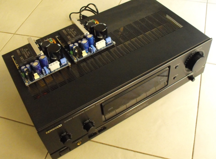

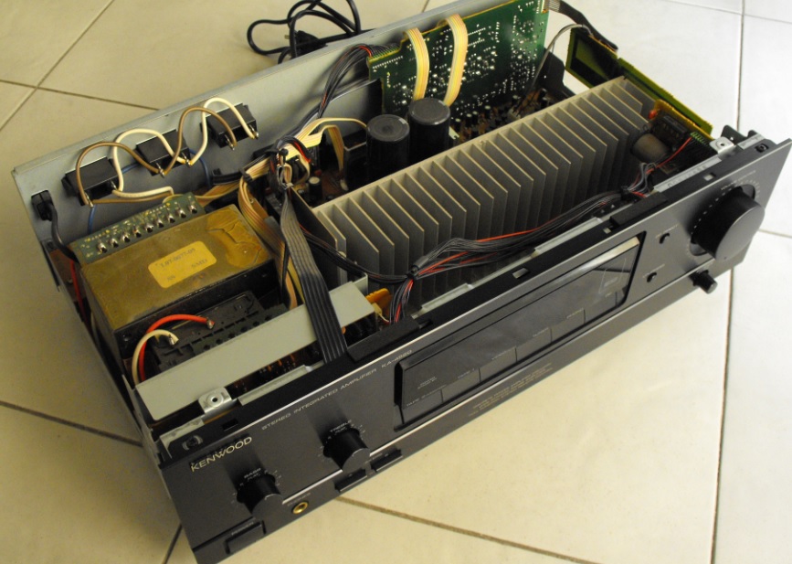

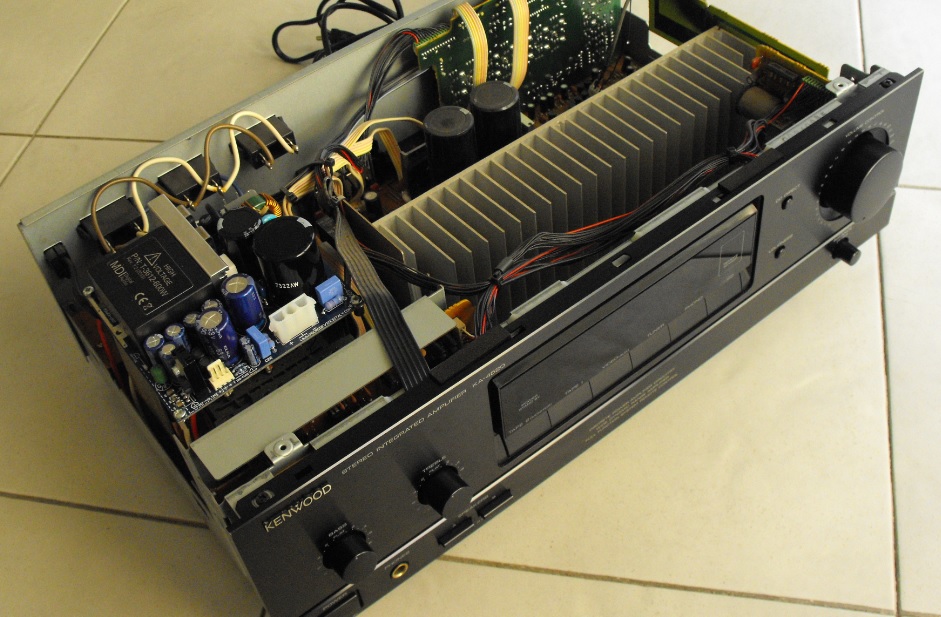

Later today, I will show an important audio measurements, on a Kenwood KA-4520 amp 2x110w rms. (fft + thd at 3w and 50w) before replacing the original transformer with two DPS-400 at 52V + PBTU-3 (one for smps) vers.2x10000uF.
various photos before and after the change.
Listening is completely different a lot
, power increase also to 150w rms. 🙂
As write in various forum, this amp have very generous trafo also.
This simple two measure,
definitely eliminates all doubt. (if someone have)
P.S. Amplifier as virgin,open for first time as new.
Listen in Audio room with Phono MM. zero problem and noise,
the dynamic is great, very fast amplifier as 50Khz.

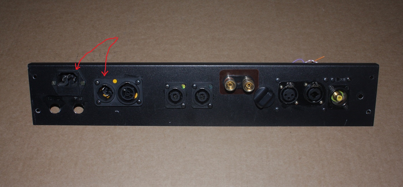

Hello,
yes :
one kit1, standard in 52V
the other kit 1 spread like this:
-2 DPS in 42V with V2 and V3 ref GND , (like a kit 8 in fact)
-2 SDA 400 (which will be connected on the DPS of the first kit 1)
for this second kit 1, I do not need the PCB with POT and XLR so you could save money if you whish 😎

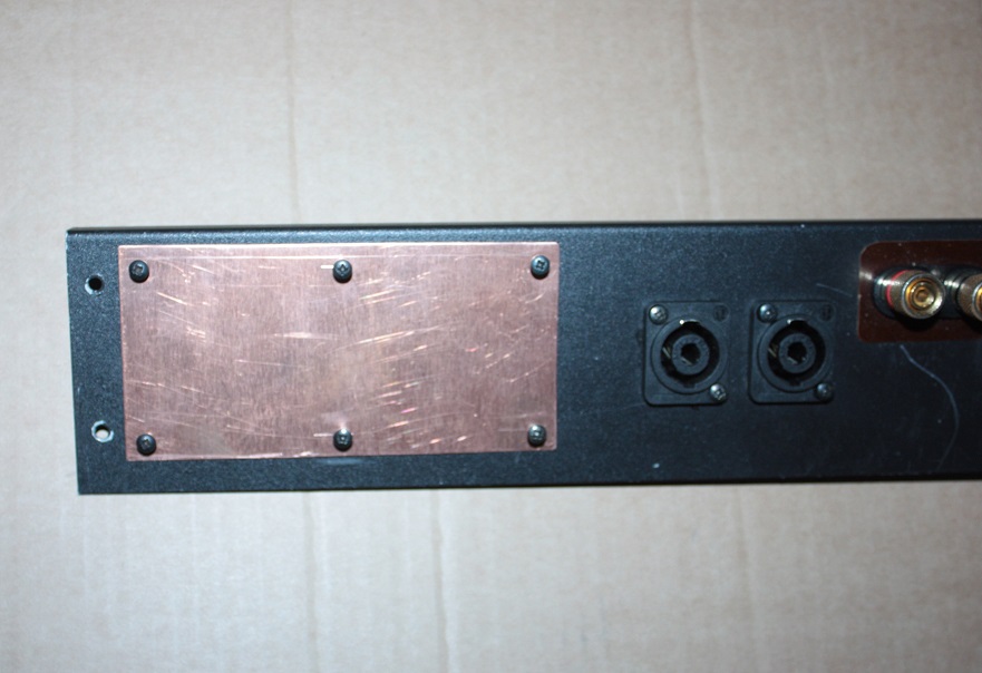

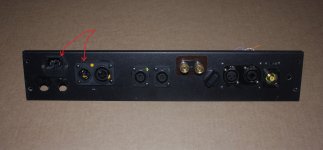

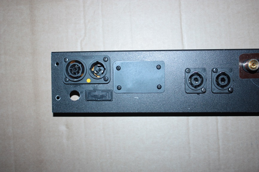

Just now noticed it's dangerous to have two input plugs with mains voltage 😱
not good 😡
Dangerous yes,especially if it is connected to the speakon and the other remains free. remove the traditional AC Main, then.
Populate well the rear panel, what type of connector is the couple in the center (copper)? use for?

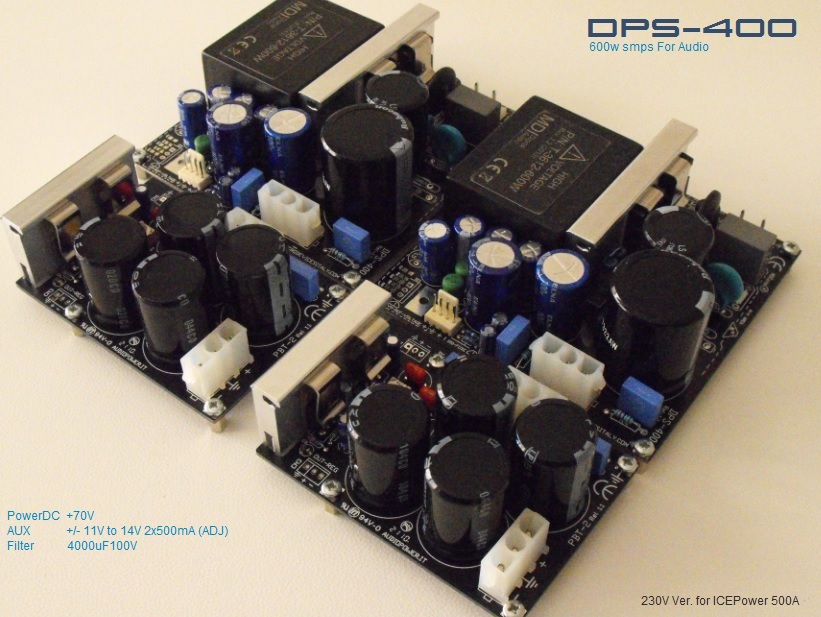

Danco.vim SMPS for ICEPower500A
I put in the thread, as requested by Danco.vim, but also for others who do not know this version, well tuned for ICEPower-500A.
... The best for Audio 🙂
