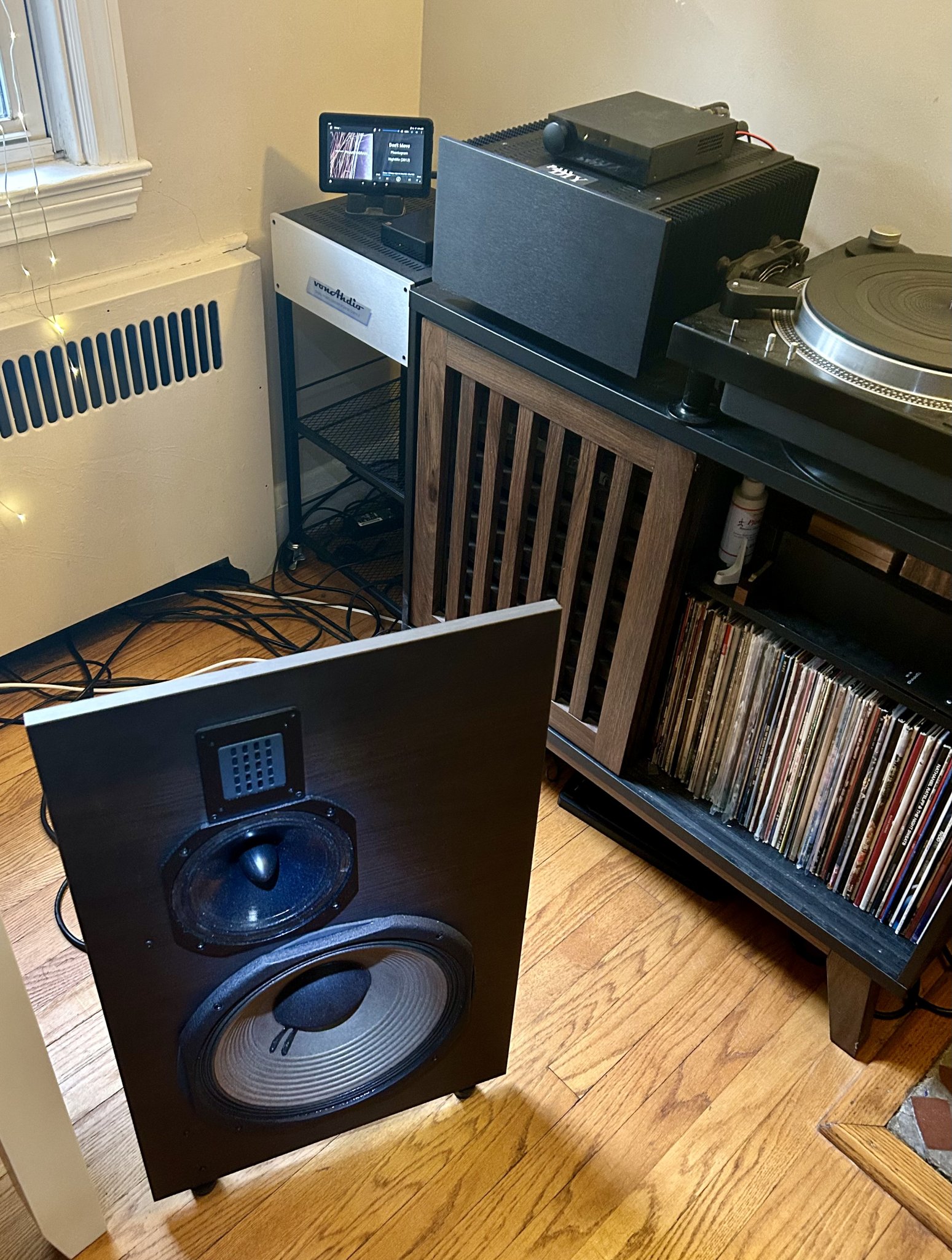

My Scryer is back in the main system today.
PLUS, I made my signature Frutti Di Mare dinner for me and my son.
Now enjoining the Scryer and my updated OB speakers after the gustatory delight. Life is good. Cheers.
