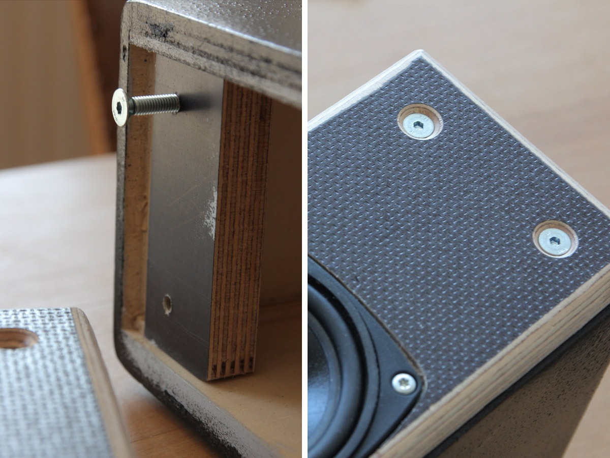

I use little pieces of birch plywood glued firmly inside the baffle, cut metal threads and insert metal screws. This is very solid, even after several times of screw loosening and tightening again. In my experience T-nuts tend to get loose after some screw loosening/tightening cycles, specially in mdf.

A very good idea but it takes more time and often requires longer driver mounting screws. Not to mention potential for future fastener back-out.I use little pieces of birch plywood glued firmly inside the baffle,
Well I this case is not MDF but plywood ,I use little pieces of birch plywood glued firmly inside the baffle, cut metal threads and insert metal screws. This is very solid, even after several times of screw loosening and tightening again. In my experience T-nuts tend to get loose after some screw loosening/tightening cycles, specially in mdf.
Can you elaborate more on the cut metal threads in the wood, does a metal screw works just fine in wood?
Does normal wood glue works fine to attach metal thread inserts for metal screws ?
Also if I turn the driver so the magnet is facing the mouth , that will easy vibration or get a lower freq response ?

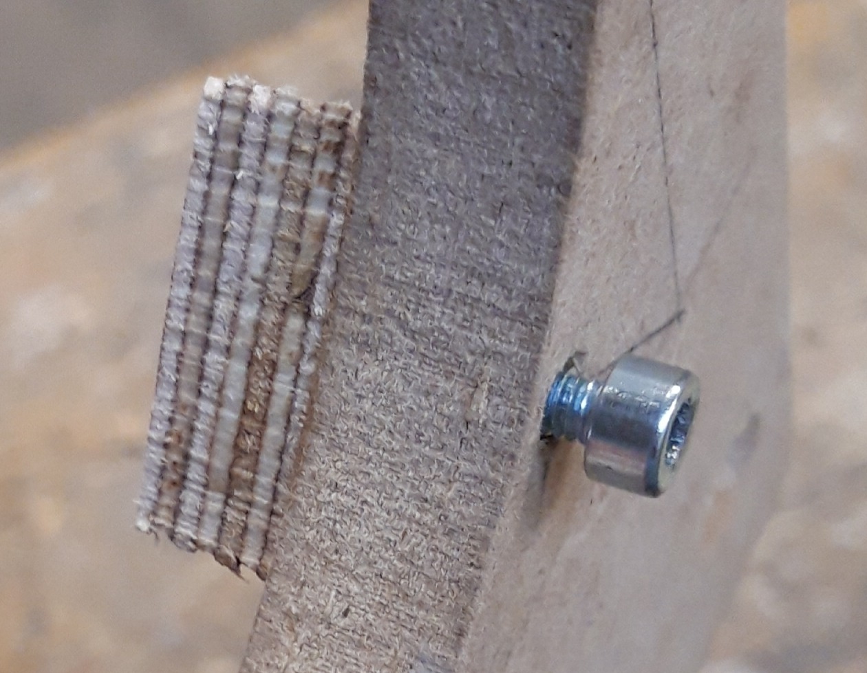

one more picture of metal screws in plywood used to attach a baffle to the box.
the screws are metric M5, plywood is 12 mm thick.
i drilled a 4 mm hole before cutting the thread (the hole can and should be smaller than the suggested diameter for metal).
the screws sit quite tight and can also be fastened tightly.
plywood obviously has to be strong and allow cutting of the metal thread, so birch plywood works best in my experience.
in your case (case made of plywood) it might be possible to cut threads directly into the baffle. I suppose it will be difficult to use the existing holes, so the suggestion to rotate the drivers is probably best!
