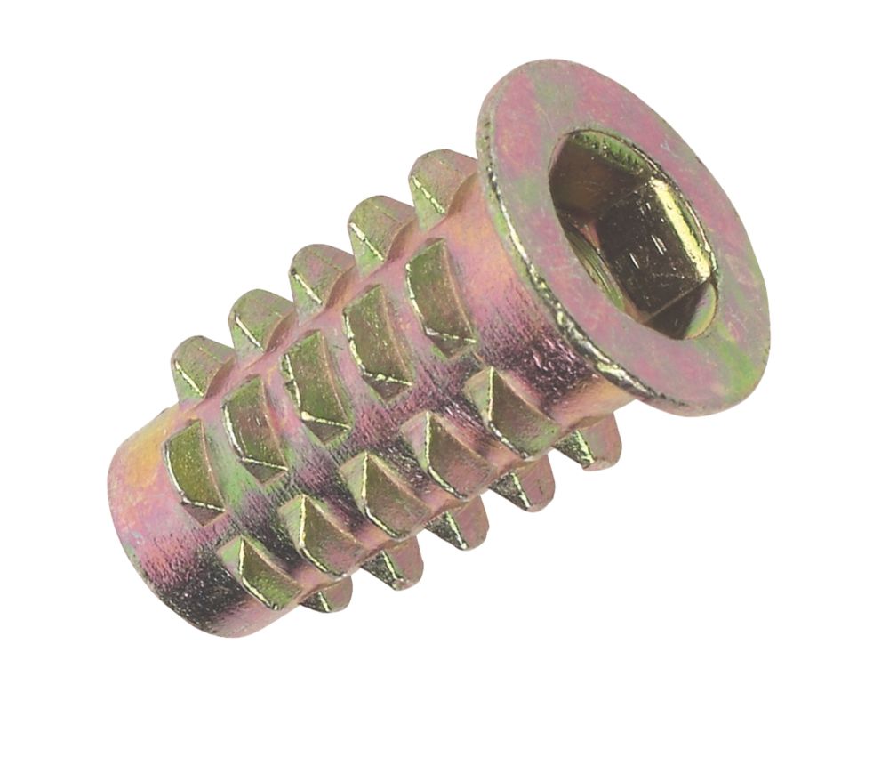

If you need to re-use the same holes (rather than rotate the driver, so the holes are over fresh wood), then the T-nuts are probably the best option. Another possibility, which can be used from the front, are 'threaded inserts' - look at the ones designed for wood (there are versions for metal., plastic etc too).
ae235
They have a big wood thread on the male/outside, and a machine screw (bolt) type thread on the female/inside. Edit: check if their extra size would be okay though, some driver holes are big enough to be very close to the screws.
Reactions: 1 user

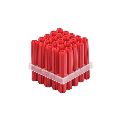

T-nuts, hurricane nuts and threaded inserts are usually unnecessary for your use.
Hole fillers, starting with toothpicks and PVA glue and working up to the plastic expanding sleeves are your best bet from what I have read in your posts.
If you choose the simple yet effective toothpick method, make sure you lay the speaker on its back and tape off the back of the hole before adding the glue and toothpicks. Use yellow glue if you have it and leave it for a good 20 minutes before installing the screws.
