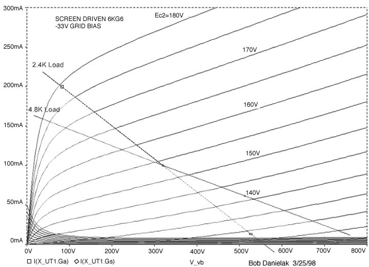

quite some discussions on this board deal with screen driven sweep tubes. I would like to draw your attention to my observation, that when screen-driving certain types which make use of beam forming plates for secondary electron emission suppression one rather obviously loses the benefits of said secondary electron emission suppression - at least this is my interpretation of the plots I made, please correct me if I am wrong.
In datasheets or application notes, plots for screen drive of sweep tubes are not that commonly published. The 1st attachment shows a graph for a screen driven sweep tube from an application note.
Only few Spice models are available, but they give an extremely over-simplified view on reality; I suppose the curves from the 1st attachment were generated by such a model.

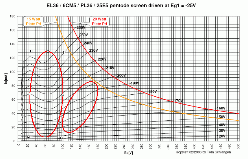

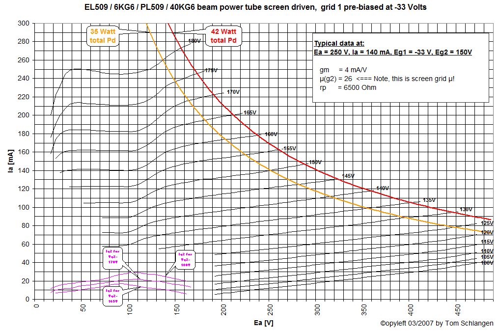

When measuring and plotting the same type of tube in real life using the same conditions (like prebiasing @ -33V Eg1) I get what you see in the 2nd attachment.
Now you can argue I didn´t connect the beam forming plates to the cathode with this certain sweep tube type, but I did. Just to make sure, I attached the plot of a sweep tube type which has an internal connection between the beam forming plates and the cathode, see 3rd attachment. Please note there is not only one massive kink, but also a much slighter additional kink (both marked red).
How do you interpret these graphs, what is your theory about the physical effects that (seemingly) cause the return of the evil tetrode kink when screendriving such sweep tube types? (Bonus points for giving an explanation of the much slighter 2nd kink).

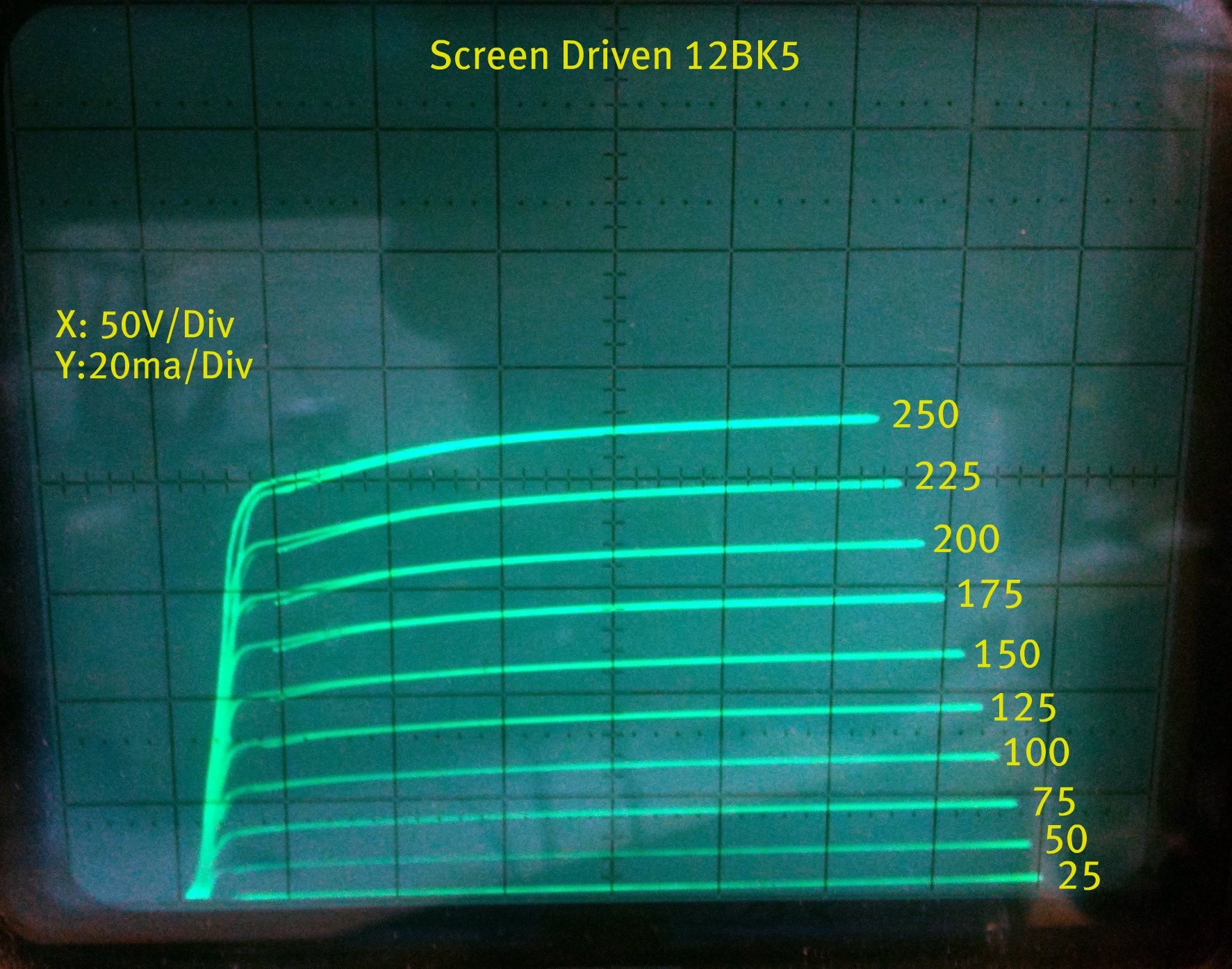

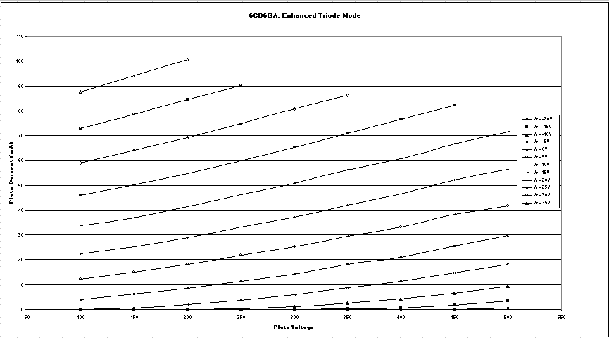

Shown below are the results I got measuring a 6CD6GA in screen driven mode. These were static measurements taken a point at a time, rather than swept.
A source follower was used to drive the screen grid.The control grid was tied to cathode. I should probably try the tube in question at the beginning of this thread, as I have a few handging around.

The pink curves in the EL509 plot show Ig2 at least over a small range where I expected something interesting to happen. In the kink valley area, you see Ig2 rise when Ia falls. Simplified, Ia + Ig2 = Ik still holds true within expectations, supposing Ig3 to be negligible. I didn´t measure Ig3, though.
For the other specimen EL36, there is no chance to change Ug3 from Uk, since the beam plates are connected to the cathode internally.
Extending your measurements with Ua below 100V down to, say, 10 or 20V would be most interesting, since the kink valley area with types EL509 and especially EL36 showed up below Ea=100V, unfortunately not covered by your plot. Also, prebiasing g1 with a constant voltage (as in my graphs) might make a difference. This g1 prebiasing is recommended in real world circuitry (using auto / cathode bias) to keep those fat sweep tubes from current runaway....
Same measuring method used with my plots. I don´t trust swept measurements for power tubes, because average Pa will be much less than when when running power tubes at, say, 80% Pa iddle in a real world amp circuit. Swept measurements just don´t show the real world thermic effects on internal electrode geometry, often causing a steeper gm close to the Pa,max hyperbole. Think "thermal runaway".

Mr. Danielak (EL509 Svetlana app report) and Mr. Paravincini (EAR) used the auto prebiasing to keep these fat sweep tubes from thermal runaway, both used about Eg1= -33V, that´s why I used this also for the EL509 plot shown above. If prebiasing really is the cause of the kink, the (computed) "plot" from the Svetlana app report shown above is far from reality.
