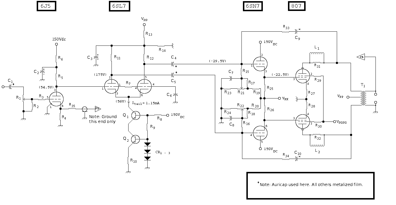

That is the Western Electric 'Harmonic Equalizer' I mentioned on post #15, original WE 300A PP type WE86 amp use 60R and WE92A amp use 85R in your R30 position. You may want to simulate higher values like 30-120R. Lynn Olson suggested adjustment by distortion measurement and listening.... I also added this 10R resistor highlighted on red square. I don't know what it's called but it helps to reduce THD considerably.

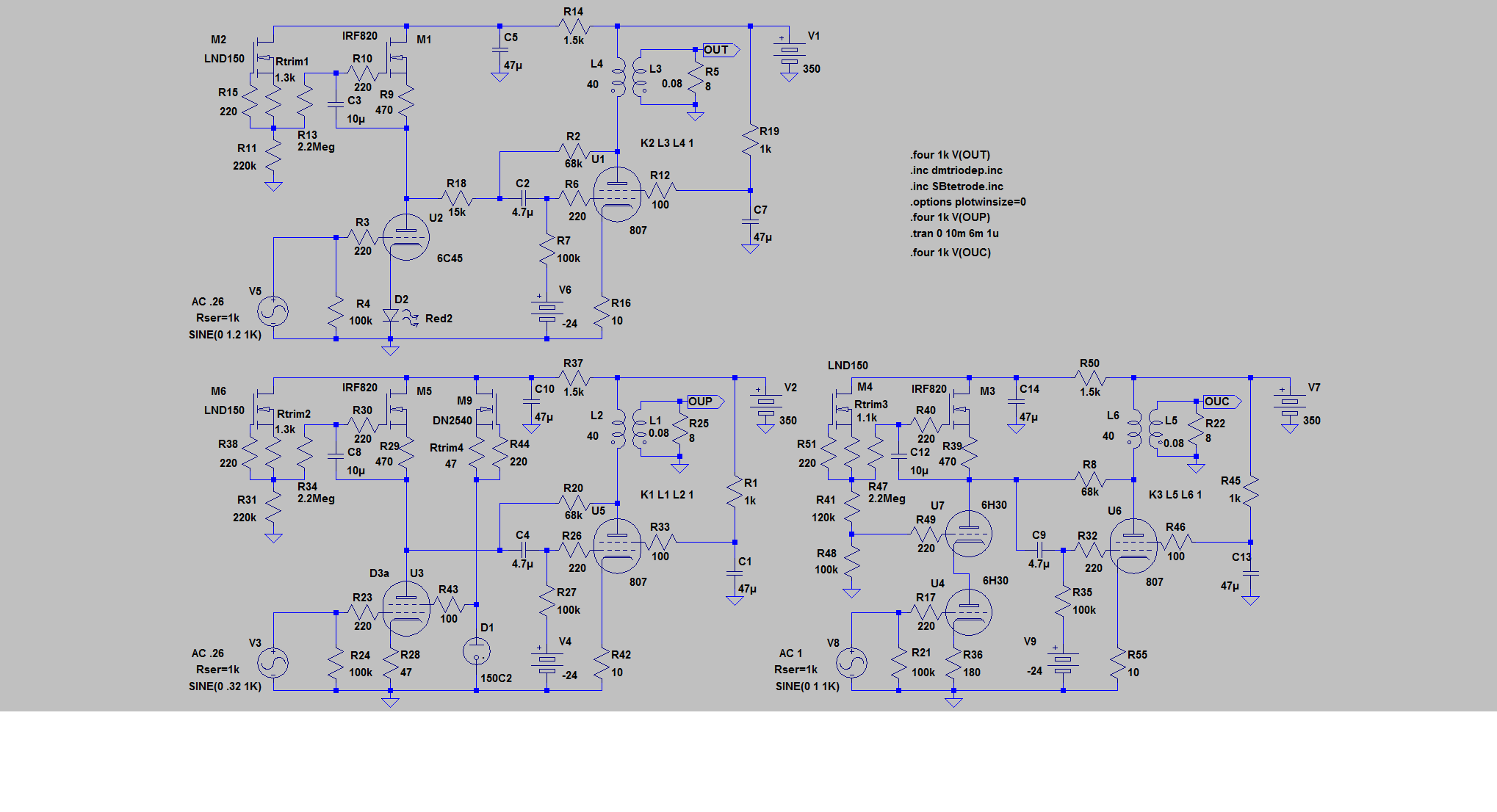

In that case, I suggest a little more simulations to consider other schemes. I noted other effective feedback scheme as expressed by kenpeter here and shown by revintage as example here relevant to your case.... I work away from my hometown and can only do this hobby within a narrow time window on weekends when i am back so i try to do as much as i can when i am away. ...
Please note the use of R18 in relation to R2 feedback on top left scheme theoretically exhibit better distortion behavior.
You may also find that for your scheme on post #36, a 220-1000uf capacitor in series with a 60-200R connected from cathodes of V2 to ground will reduce distortion.
V-I converter (R18) before going to I-V converter (R2). Interesting. Yes it would be a better scheme.. I'll give it a thought. I haven't simulated it yet but i imagine it will need more swing compared to the usual plate to plate resistor. What i really need is twin EF86 pentodes in a single envelope octal base.. lol. That way i can keep the octal spirit and provide better Schade scheme.

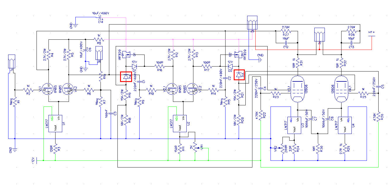

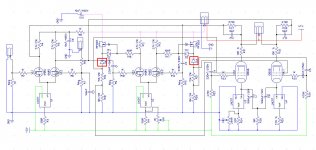

2 pictures on the bottom have obvious errors causing odd non-linearities. For better results gyrators there must be replaced by resistors.

Some points are still unclear to me. If we replace the gyrator on the 2 pictures on the bottom on post #47 with a high value resistor (or remove it altogether), we also get the plate impedance back into the equation. I've seen quoted nice results from these like Gary Pimm's 47 PP with driver biased with current from the feedback resistor and Michael J Koster drive the grid of the output tube from gyrator mu output while feedback resistor was connected to plate of the driver, while theoretically a linear resistor divider is preferred. Could you share your findings and opinion a bit more on this plate to grid feedback scheme?
Pentode or cascode with high plate impedance have to be loaded on a resistor of relatively small value. It's value with "feedback" resistor forms a voltage divider that sets the feedback ratio. But actually the pentode is loaded on even lower resistance, since it sees a dynamic resistance of the feedback resistor divided by an amplification factor of the output tube. If say amplification factor of the output stage is 10, the pentode is loaded already on 68k/10 = 6.8k resistance. What's the point of the gyrator?

I think of the use of a gyrator as a way to fix bias voltage allowing use of driver at higher current and/or as a modified source folower for A2 or screen drive. I just realized that implementation needs very careful consideratons since introduced nonlinearities could easily outweigh the advantages.

What Broskie is describing here is more like E-Linear, not parallel (aka "Schade") feedback. Parallel lNFB is implemented like this: (attached). Rf isn't doing double duty as a plate load. It does, however, accomplish the same end: linearizing a less than linear type so's you can take some of the pressure towards instability off the main gNFB loop by substituting a much shorter feedback path that contains less phase shifting reactances.
I did it this way as opposed to the E-Linear method since 5SL7s aren't real good when it comes to current sourcing, especially when the grids of the finals want to slip into Class AB2 on peaks that overdrive the grids. As a side benefit, I was able to get a few more watts of output as well. (32W as opposed to the specced 26.5W. @ 1.0KHz)

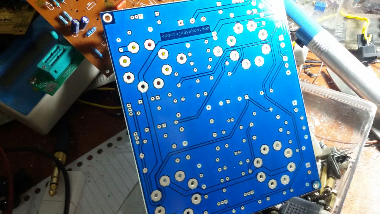

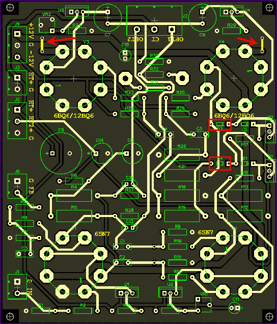

I have decided that i will keep the feedback network for now. I made some minor changes to the PCB:
1. Added some jumpers to the heater trace to allow swapping between 6V and 12V heater for the output tube. It allows me to switch between 6BQ6 and 12BQ6 and, should they become too expensive, 6P31S.
2. Added zener diode under the G2 drive source follower to allow some voltage shift and make the PCB a bit more universal. This will be a jumper as i am using the same B+ for driver and output stage.
3. Adjusted electrolytic cap dimension to the actual ones i'm using.
If there is no major mistake, i will send this design to the PCB fabricator.

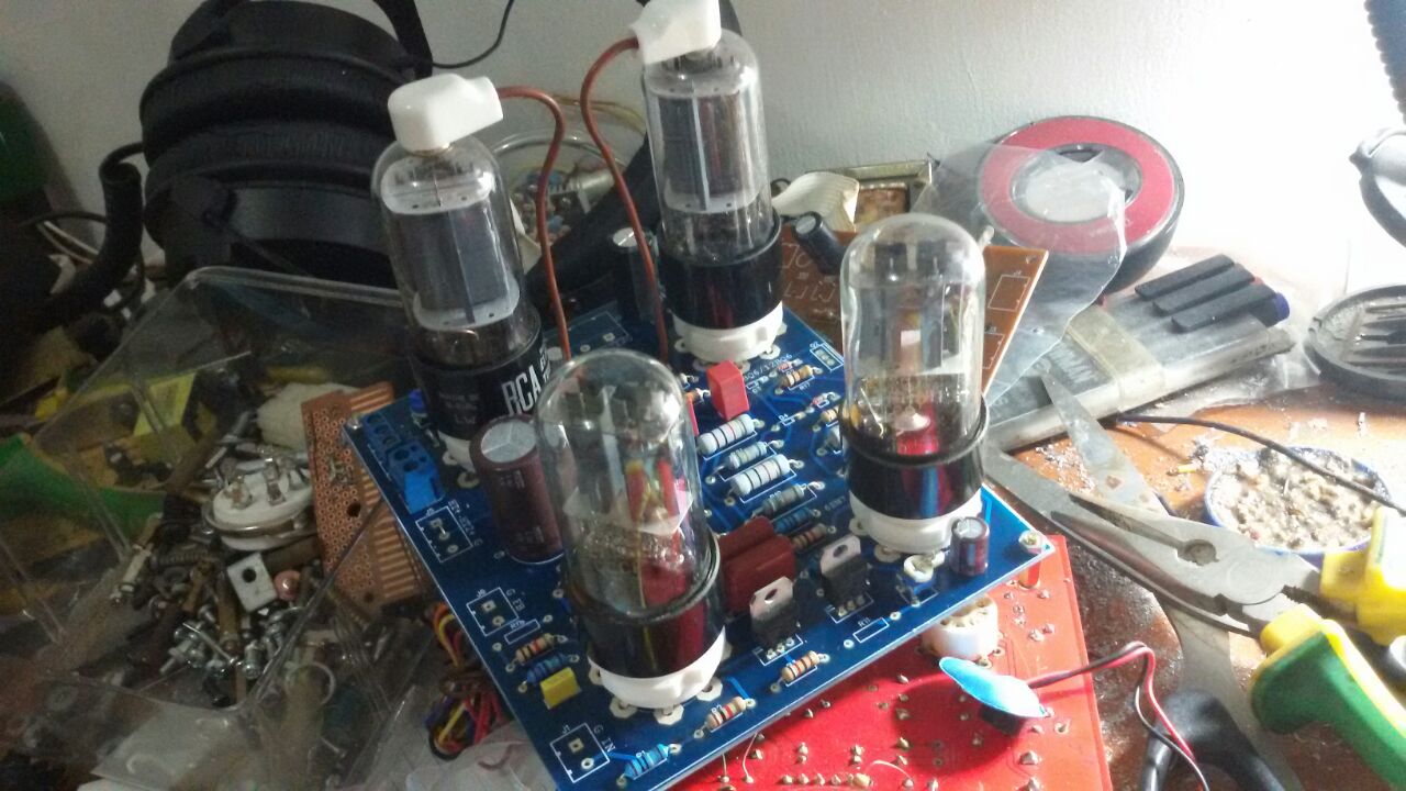

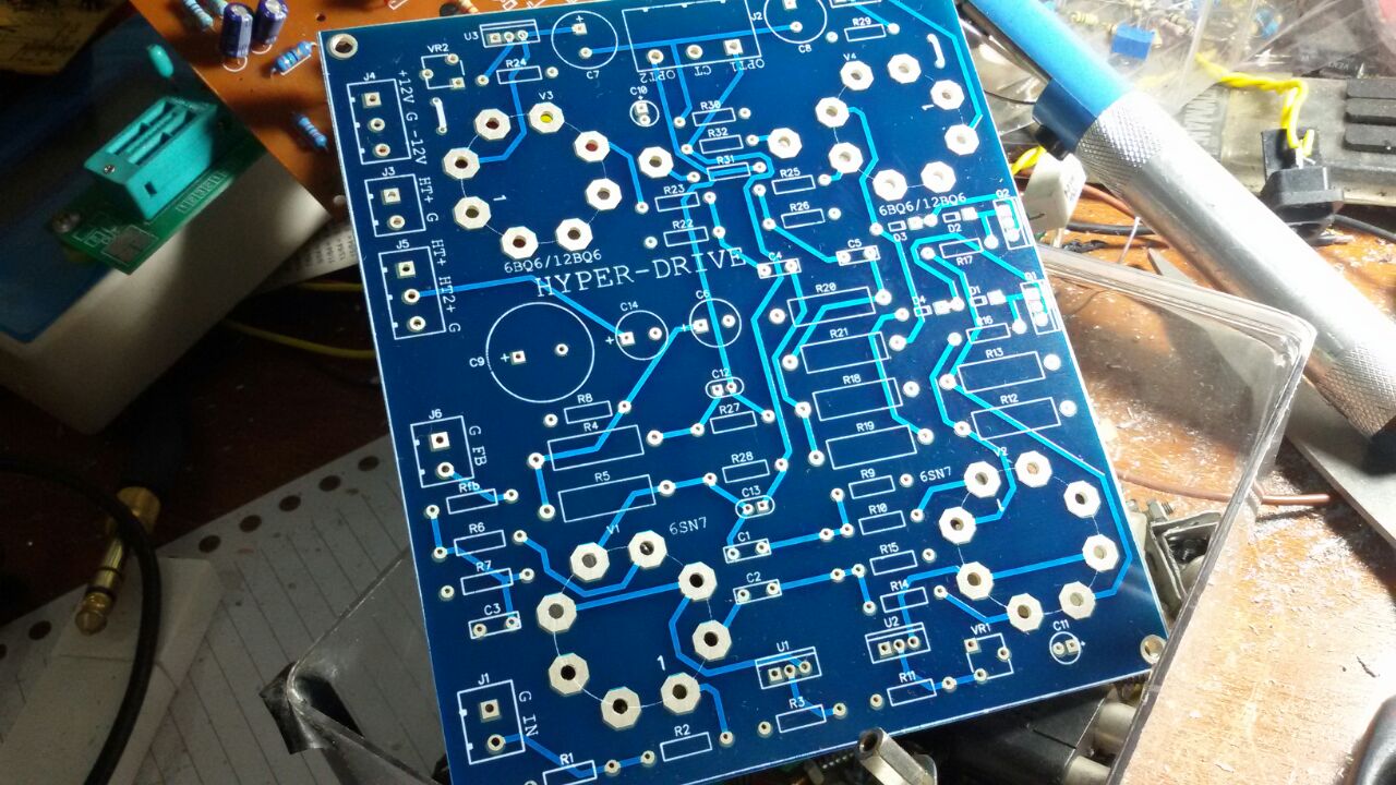

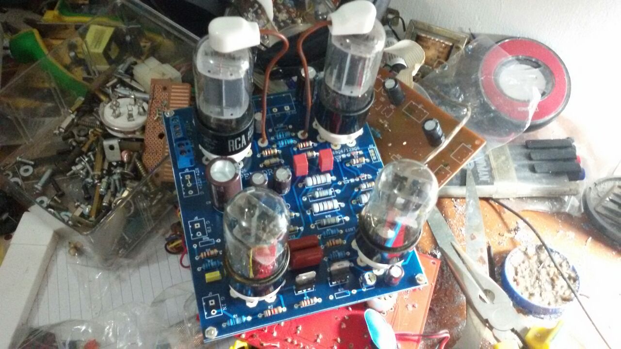

Just want to give a small update to this project. PCB's finally done (after the fabricator had to remake it as there was drill diameter mistake).. Two hours later, finished one channel for trial. Power supply is coming up next.. I have the 150VA 220V isolation transformer.. some SS diodes with several 400V caps is on the shopping list.
