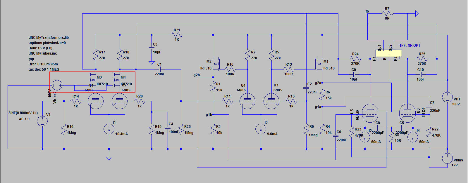

Okay.. i need help here. Basically the amp is working. Music is playing through the speaker nicely BUT there is something i can only describe as low frequency oscillation. The music mutes every 1 second and plays normally again.. so like 1-2Hz oscillation. Imagine the second hand on a clock: the music mutes everytime the hand moves and plays again everytime it stops.
I am going to try to remove the feedback resistors (the ones stretching from the output stage plates to the input LTP and see if it plays normally. Any other suggestion what to try? Schematic is on post #58. The only difference is that i am not using the 10pF caps parallel to the 270k feedback resistors. No global feedback yet.

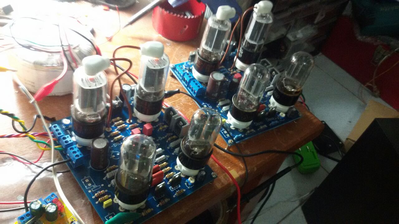

My best sounding diy amp so far! Has full authority on bass just like SS amp and i haven't put any global feedback yet. Thanks Parafeed813, your suggestion is correct. I need to fully decouple the driver from final stage. No more motorboating, even with the plate to plate feedback resistors connected.
My B+ for the final isn't as high as my plan (300VDC) but i blame my local power company for that. I am not getting the 220VAC mains i am supposed to. Try 190VAC.. sheeshh! But even with that problem, i am getting the volume i need.

I'm using a separate boost converter module to power the driver+input stage. This cures the motorboating. It's amazing how there is no hummm although i'm not using any LC nor RC filtering. There was none also when it still suffered from motorboating. I have always been intrigued by the excellent PSRR from symmetrical topology like this or Baby Huey.. now i can hear it by myself.

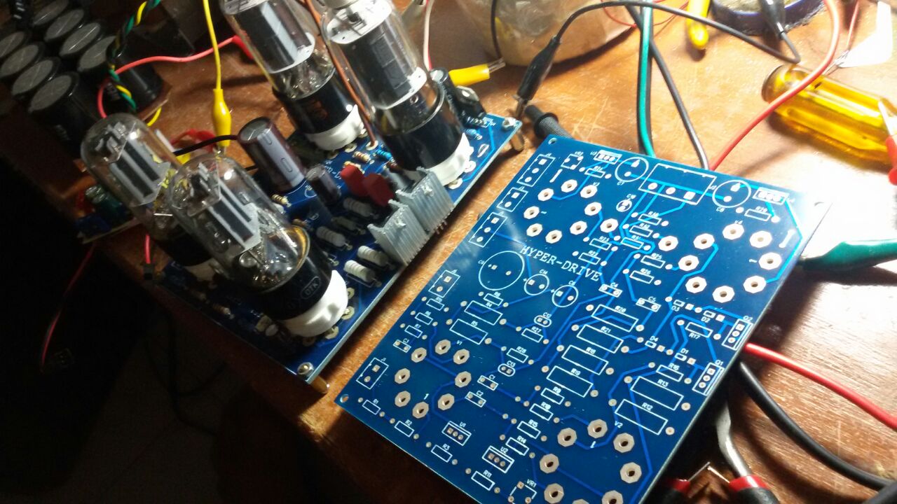

Finished the other channel and of course it works and sounds nice also. Next step is to find an enclosure. Meanwhile, i played with LTSpice a bit and realized i should have made the input stage cascodes. Oh well, perhaps next project.. Maybe a universal push pull input+driver board.
