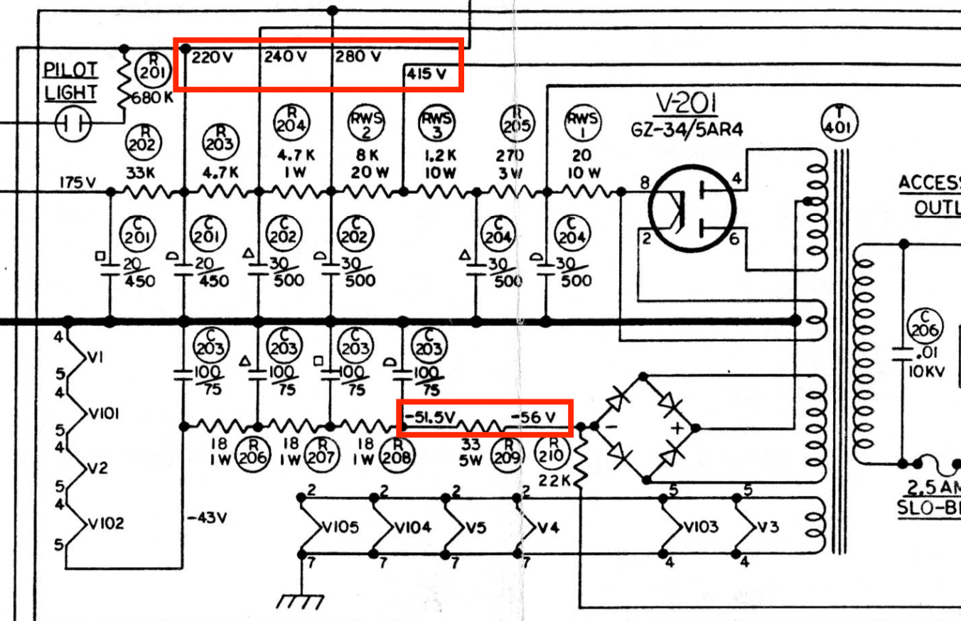

Just to confirm, is the bias supply can C203 and is it the only one that's common positive? Looking at the schematic I see that the voltages shown near the other cans are all positive, while C203 shows negative voltages. Is that how you know?"Common positive" means the usual can configuration is reversed. In most can caps, the inner tabs are positive and the can is negative. For a bias supply can, the polarity would be reversed.
Yes, though most schematics will note the orientation with a + sign at one end of the cap symbol.

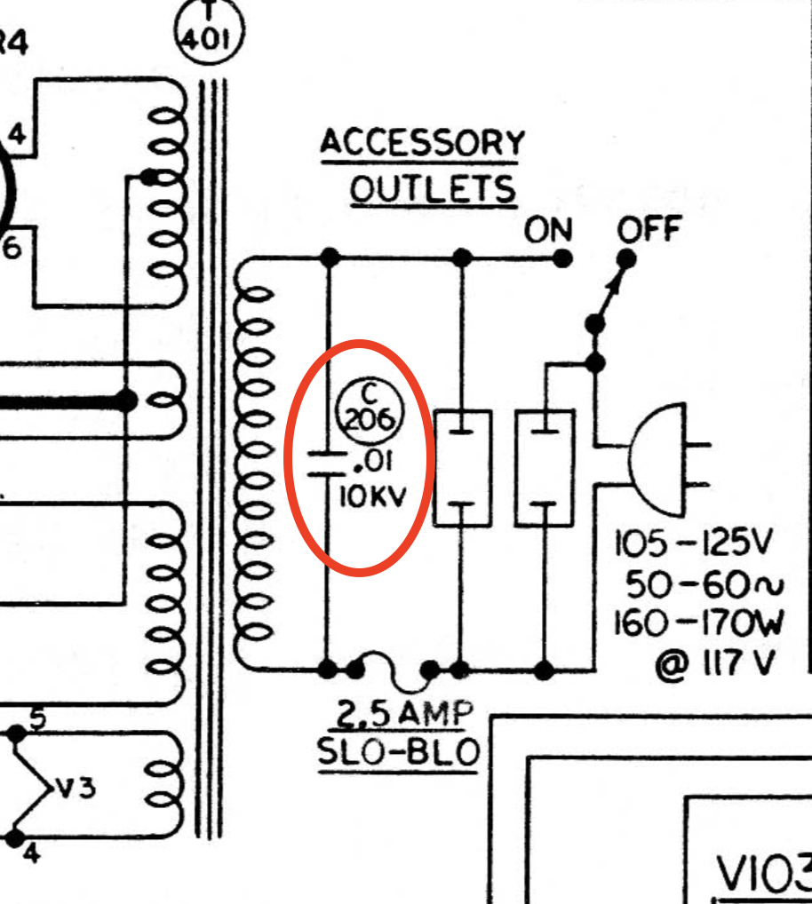

I was trying to find the post where I saw that safety cap recommended, and it was in this LK-72 restoration thread over at AudioKarma. I read further through that thread last night and saw this response saying the safety cap is not necessary because "C211 is not a 'death cap,' it's a 10KV ceramic wired across the primary (not to the chassis, as a 'death cap' is) to protect from line voltage spikes. No need to replace if so, and a bit hard to find at 10KV rating."I don't know anything about that cap except that, yes, a safety cap is recommended.
On my LK-72-B I believe the equivalent to C211 is C206 as seen below. It is also 10KV and also wired across the primary. So maybe it's not necessary to change. The safety cap I ordered is only 400/250V. So it's probably not the right one anyway.

I don't see why you can't leave the ceramic cap in place, they rarely, if ever go bad, as far as I know. As for the grid resistors, I trust whatever Dave Gillespie recommends. ;-) You can leave them or change them back. The only effect is that they might reduce the LF response a bit. Up to you.
