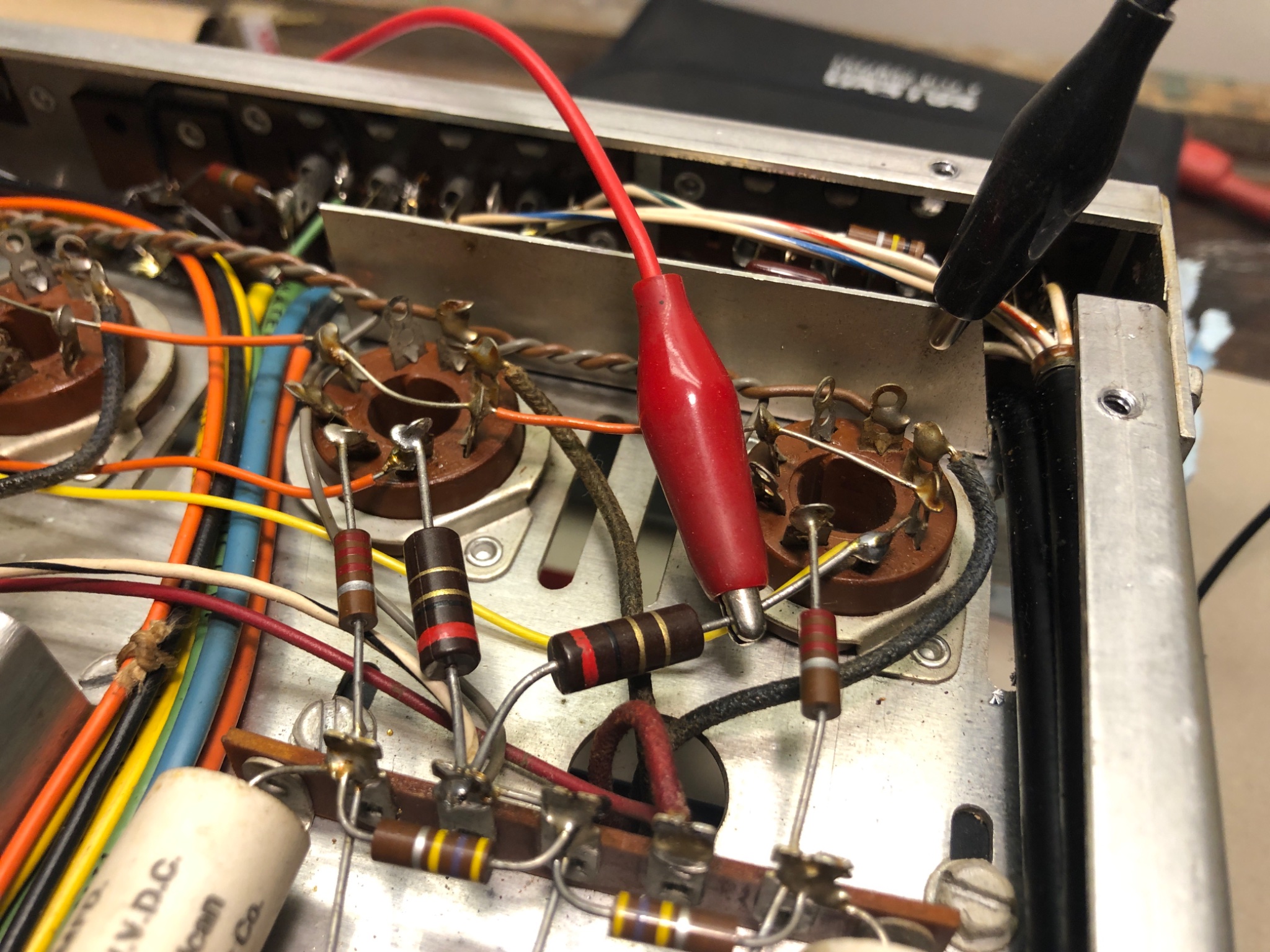

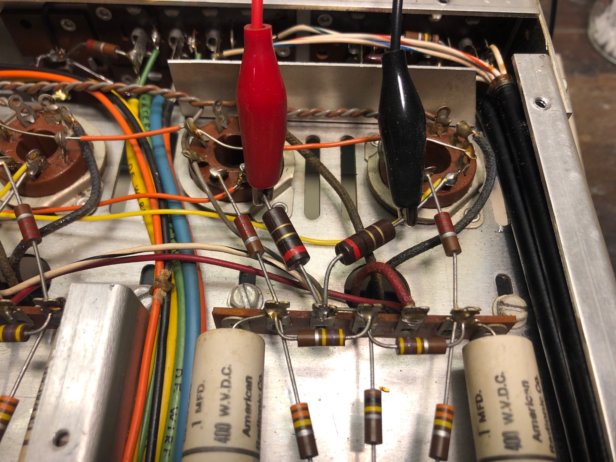

I'll try swapping some tubes and see what happens. The sound was in both channels last night, but was definitely louder on the left. There was another sound too that's hard to describe. This probably sounds odd, but the best way I can describe it is it sounds like a mouse or chipmunk nibbling on something. It's faint, but it's there behind the hum or the static when my ear is close to the speakers. I searched for a sound clip of something similar and found this clip of a mouse eating a cracker that is pretty close, lol. The irregular pace or rhythm is definitely similar. https://pixabay.com/sound-effects/mouse-eating-cracker-35523/
I still have a lot of parts to replace on this amp, so I'm probably jumping the gun again trying to track down something like this, but if anyone has an idea about the source of a sound like that, please let me know.

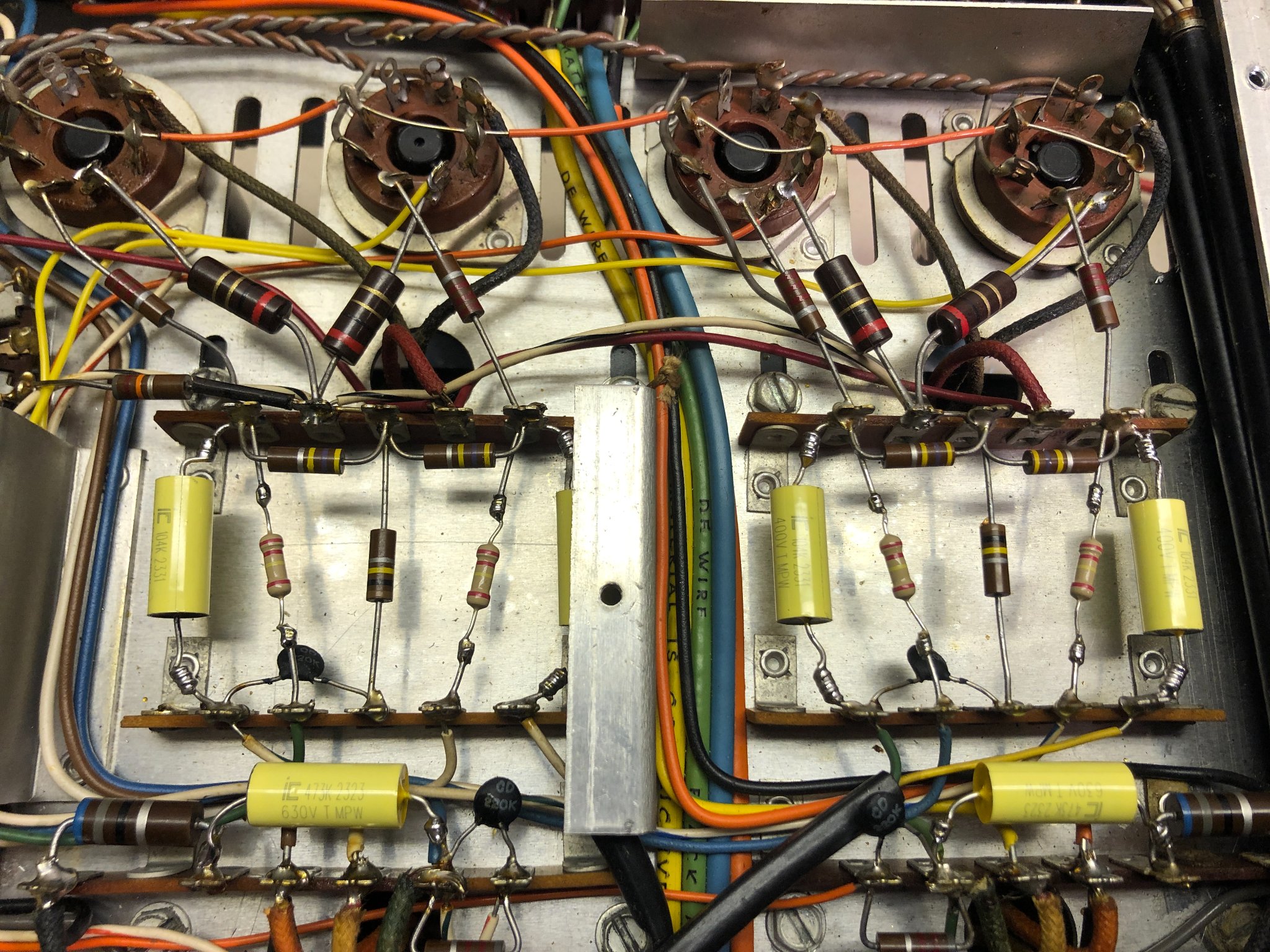

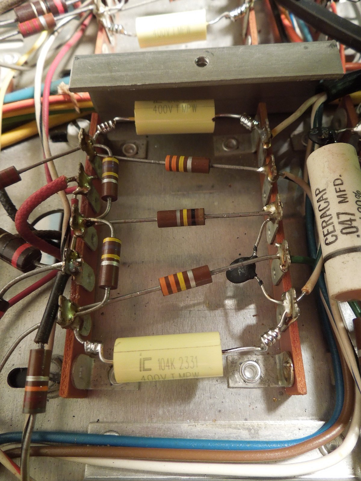

Most Scotts I have worked on suffer from the input circuitry of the phase inverter tube picking up noise from the AC switch located on the back of the level control. Since the grid of the pentode section of the phase inverter tube is not actually grounded out when the level control is full down, it is easy for this tube to pick up any stray AC from the power switch since it is in such close proximity to sensitive signal circuits, and manifest itself as a buzz in the output. Even the Scott preamps will do this as well.
The ultimate cure is to move the power switch to a different location (back panel on the power supply side), or remove it altogether and use a power strip to turn the amp on and off with. Either way, getting the AC wiring disconnected from the switch and removed from the general area will invariably solve the problem. Short of that, use the best shielding and lead placement possible for the power switch wiring, and understand that whichever channel uses the rear most portion of the level control (closest to the AC switch), will usually have the most noise as a result.
I've disconnected the switch on the volume control on my 222C and my 299B. I have them plugged into an old computer power station that was made to sit between the computer and the monitor, it has multiple switched outlets. I mounted a Corcom RFI filter from Ebay inside the box to help keep crud out of the AC supply.
The shielded wire Scott used wasn't the greatest but there were probably fewer home noise makers back in those days. I've replaced that with some better coax shielded wire, you can get short lengths about 10' long in various colors on Ebay.
Scott's engineers did a pretty good job of star grounding with the main ground point under the phono preamp tubes which are most susceptible to noise. That's why it's important to keep the insulating wafers under the can caps so that the ground is only connected at that one point.
The LK series were sold in kit form, so it's a good idea to check over the wiring carefully for bad solder joints or misplaced ground wires. You can find assembly manuals online to check that whoever made that kit did it correctly. Although I've heard that some were built at the factory.
One problem I've seen is that the AC heater wiring isn't adequately twisted to reject noise. The preamp tube heaters use DC, they used the bias supply for those to keep the noise lower, but the power amp tubes are AC from the transformer.

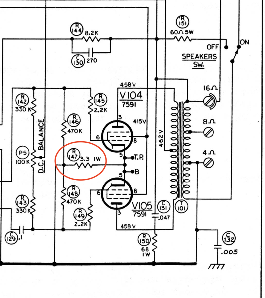

I may try replacing the 33ohm 5W resistor in the bias circuit with a 40ohm as suggested earlier. Also debating whether I should remove the 220K grid resistors I installed earlier and go back to original value of 330K. I do have some new 5% metal film for replacements. I also have 1% replacements for some of the plate resistors as recommended in the website therling shared earlier.
If there is anything else I should be considering, please let me know. Also wondering if there are any tests I could do with my oscilloscope to determine how well the amp is operating. I used the scope to identify the foil side of the new caps, but would like to learn other ways to use it.

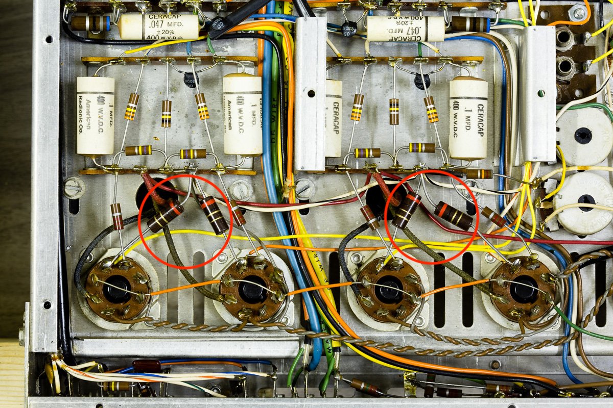

No problem at all. Scott amplifiers were originally in wooden cases with much less ventilation than in your setup.
Modern resistors have much higher power ratings for their size but they do this by running HOT. It's an immutable Law of Nature.The three 18ohm resistors attached to this can tested 19-20ohms. So I ordered some 18ohm, 1w, 5% replacements, but they are tiny compared to originals. Is there any concerns using resistors like this, or is it just a matter of appearance?
This does not matter if they don't dissipate much power. But if they do (eg Cathode resistors on the final output), I would use several resistors in parallel to make up the original value in about the same size package ... or a modern resistor of about the same physical size even if its power rating is much higher.
There's also where and how they are mounted and if the higher temperature might affect nearby stuff adversely. A common case is if the Cathode Resistor is decoupled by an Electrolytic.
