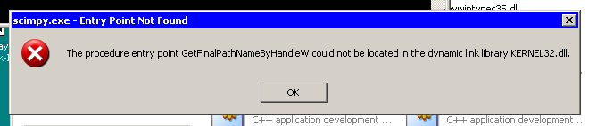

I'm looking for something like this Scimpy.
Where is this software available? I've been to the links listed but can't find any way to acquire it. It sounds like it might be more than I need but I like the graphics. Does it use the Thiele and Small parameters for box design and alignment? I've resurrected an old Basic program I used 35 years ago from a David Weems book. The box parameters section works fine but I can't seem to interface the graph section with the GUI on my Mac (Leopard OS). Back in the day I had it on my Apple IIC and the theoretical frequency response graphs were quite good (for the time). They were only "ball park" estimations but you could tell if you were going in the right direction. It saved a lot of trial and error work and the results were darn good. I'd sure like to try Skimpy if it will work with my Mac.
