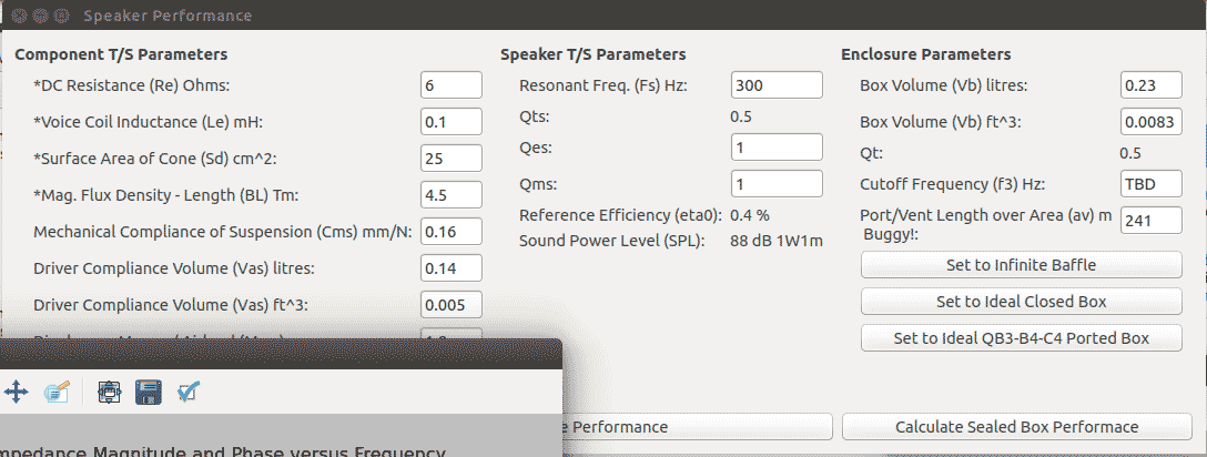

Also, updating with a new screenshot of a the measured data from a Dayton 8" woofer downloaded from parts express and fit with scimpy. The top plot shows both the measured and extracted model from the raw data - they lie right on top of each other. This is what is needed to extract TS from the measurements from the sound card. Bottom plot is calculated predicted SPL.

Hello all - haven't had time to respond to previous posts, but wanted to share this:
First driver measurements, it works 😀! A crappy 8 ohm disposable driver <$10, a usb sound card (~$15), a 12 ohm test resistor, one 3.5 mm jack cable, and five alligator clips.
I'm just adding plotting the phase and giving the option to use the fitting system with measured results to extract TS parameters! I'll check up on the bug reports, but I think this is now approaching 1.0 release.
Some todos for 2.0: baffle step/diffraction, passive radiators, cross-over circuits
