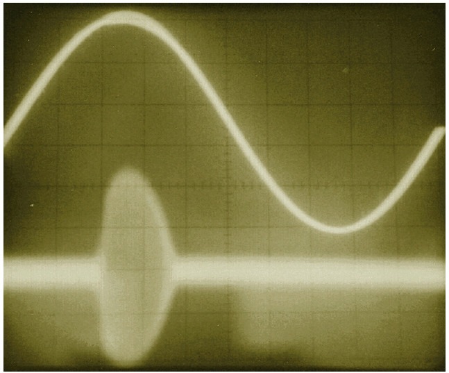

A power amplifier ringing or oscillating in the low megahertz range is never a good thing.I would worry at RF anything only if it causes any audible effect within the Audio band.
Otherwise ... it becomes irrelevant by definition.

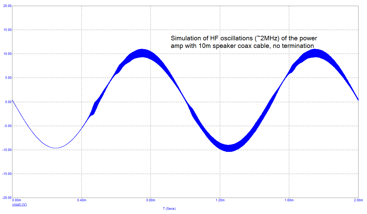

The second picture is from Cyril Bateman's article on blowing up power amps with seemingly decent cables: https://www.waynekirkwood.com/images/pdf/Cyril_Bateman/Bateman_Speaker_Amp_Interaction.pdf
That is a fascinating article. The moral appears to be "don't design speaker cables to act like low-impedance transmission lines".
In RF, transmission lines are always terminated into their characteristic impedance to prevent the transmitter's output energy from being reflected back into the transmitter (which would cause a disaster). Apparently, audio amplifiers are susceptible to the same problem. The audio amplifier's own negative feedback is creating the RF energy.

I agree, it's a fascinating article thanks to DSP Geek for the link.That is a fascinating article. The moral appears to be "don't design speaker cables to act like low-impedance transmission lines".

How would you design a speaker cable not to look like an RF transmission line?
You could design it to look like a higher impedance RF line, but that might make it better at picking up stray RF.
It should be possible to filter the speaker connections at the amp. The passband might need to go up to some tens of kHz? The stop band might have to include long wave, but the serious problems might start in the MHz?
A few simple ferrite beads which become very lossy in the MHz area and above maybe?
Some work on matching the line to the speaker was done by @Hans Polak in another thread. https://www.diyaudio.com/community/threads/zip-cord-for-speaker-test.371099/
Turns out the TL impedance needs to be low for the speaker not to cause reflections.
Higher (>100 ohm) cable impedance is fine. Impedance matching works only for pure resistive loads. The problematic cable not only couldn't match the speaker but had so much capacitance as to destabilize the amplifier.
