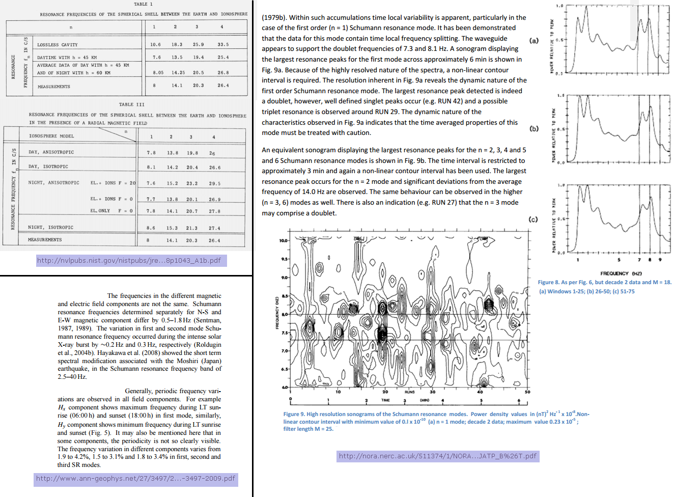

Having not sat down to write the equations out, my gut instinct (subject to being VERY wrong) would be that a change from 7.8 Hz to 7 Hz would require a bit more than seasonal/local fluctuations in the ionosphere. And Google has been utterly crippled by, ahem, on the entire subject.
People who listened to short wave radio may have unknowingly gathered a lot of evidence that the altitude of the Ionosphere, which is given here
Tracking Solar Flares
as 46-621 miles, can wander around quite a bit.
I cut and pasted portions from post #14 links, where the variation in frequency of the lower S.W. modes is discussed, the 1st mode in particular.
George
Thanks, George. Good thing I put my "subject to being utterly wrong" clause in there.
