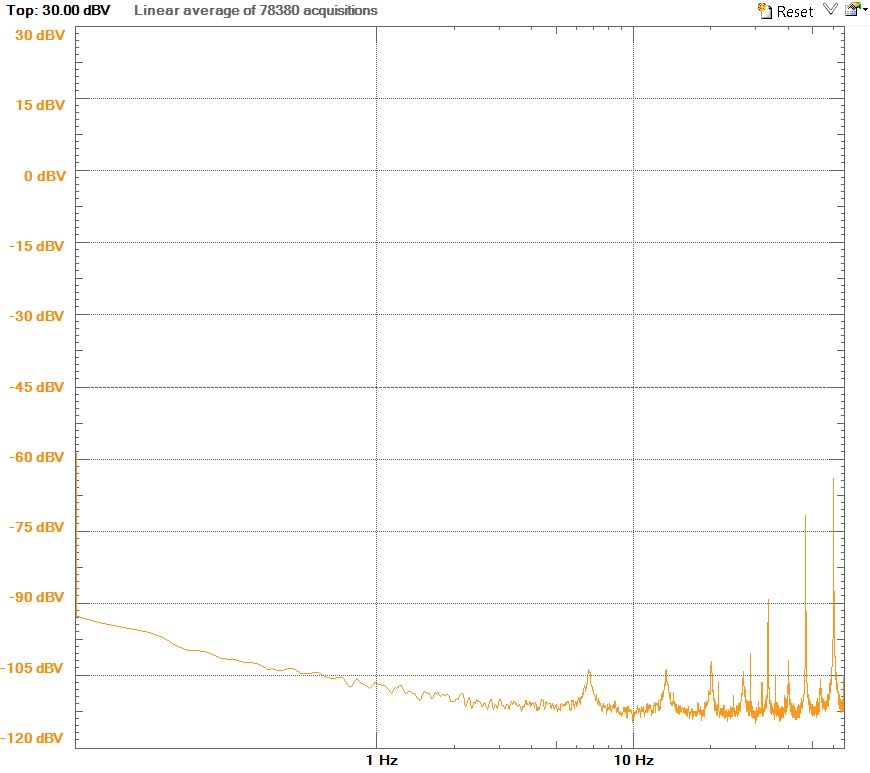

So they do, although where is the 50Hz coming from?
The European aether? I read there are still railroads on 16.666 Hz in Europe. This was just quick experiment, more to come.

But this is a real measurement and real data, I actually thought this first try would show nothing but noise.
Not a bad ADC on that Discovery!

I just came home tonight inspired by the LIGO success and cobbled this together with no expectations. Just fun no more no less.

Sweet! That's awesome. I would have expected needing a lot more sensitivity.
I see no Michelson-Morley here though. 😉
Thanks for that Scott. I was looking for something similar when I probed the ground in my yard with an ADC. What I found was mains AC noise, 60Hz and scads of harmonics.

Update,
Tried again this morning slightly different and made sure shorting my coil made them go away 🙂. I'm slightly bothered that the lowest peak is lower in frequency than usually cited so I still need to verify that this is not a false alarm. But a set of noisy low Q peaks like this are easily observable in simple DIY experiments. Maybe George found the site, it's in Italy found under a search for ULF radio. They have several PC based options. The power output transformer backwards was my idea for a signal boost. The signal is in pico-Tesla range.
EDIT just noticed the peak at ~7Hz is moving slowly higher in freq (a good sign?).
Dumb question, but is the drift in the signal, or something 'settling' in your measurement rig?
An actual frequency shift would be hard to account for since the clock is crystal derived and percents of frequency shift are unlikely.

That's what I thought, but was confused based on your earlier note that 7Hz is too low for the normal 7.8Hz reported. Of course I haven't yet managed to read the links Prof. George Google has found 🙂 so being unsure if the drift is normal was scratching my head as to cause.

There is not an exact frequency for the first S.W. mode.
2nd & 3rd mode also drift in frequency.
