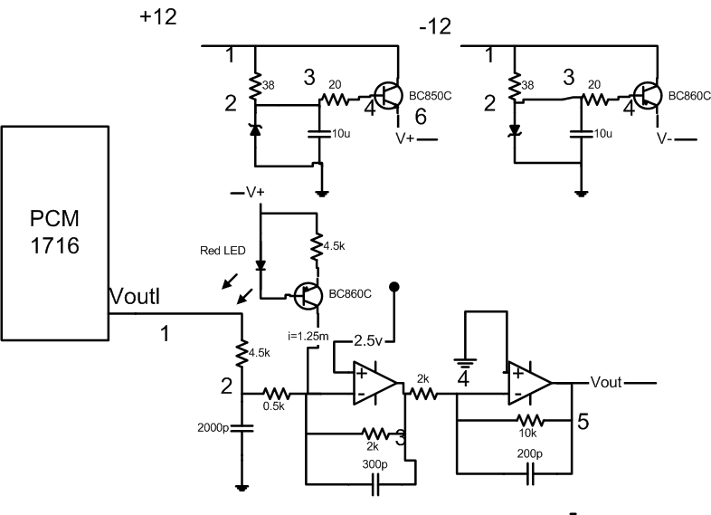

I beleive it is. But that means you loose resolution when you attenuate the signal. It might not be a problem if the DAC uses all 24 bits but i think at least the noise floor hits you if you do.
Anyway i said that i was fiddeling with the analog circuit in simulation and i have created something that should work without the dc blocking cap.
The thing that bothers me is that everyone does seem to use dc blocking caps despite the potential for sound degradation. I assume it has to do with either the problem of having to manually adjust the DC offset sometimes or the fact that you need to have two active components in the signal path where you could get away with 1 or 0 as Tor M suggested.
Anyway this is how i thought you could do it without DC blocking cap. The implementation is perhaps a bit naive but feel free to comment or suggest changes. Will build this when i get the time, if the protests are not too bad.
The filtering is not more than enough to make it stable.
The thing is that i will probably have to add another powersupply for the analog parts since it feels like the +-10v is not really enough.
There is a possibility to remove the last opamp if a inverted signal is accepted, does require a change in gain and currentsource.
There should be a trimpot in the currentsoure to adjust the DC offset but it is left out for clarity.

Konnichiwa,
Just a few quick comments.
First, a high quality Film Cap as coupling cap is much less soncially damaging than the other coupling cap, namely Cextl/Cextr, especially if you put a cheap 'lytic in there.
Why am I calling this a coupling cap? Because the DAC has a differential output the ouput circuit is an Op-Amp used as balanced to SE Converter with lowpass filtering thrown in for good measure (see attached detailed scheme from the earlier but similar design PCM1710).
BTW, you do not want to know what quality these on-chip silicon oxide resistors and silicon based capacitors are, you really don't.
Basically, as mentioned previously, I feel the sort of DAC like the PCM1716 is cripled at birth sonically sufficientl (CMOS Op-Amp, on board RC lowpasses, DAC itself) that it qualifies as karmic waste of space.
If you absolute MUST keep that dreadful thing, use decent Film cap's as Cextl & Cextr. You can always DC couple any buffers following the DAC and on board Op-Amp (be it a buffer with a gain of 2 or be it a J-Fet or Valve follower with no gain and an output 6db below normal which in most cases is not an issue) if you feel a buffer is needed.
If the load is low capacitance and at least 10 - 22k I would leave all this out, just use the best capacitor you want to afford for the Player for Cextl/Cextr and the two output coupling Cap's and make them at least 4u7F in value, this way you will be okay with loads down to 10k. On the output add a 51 Ohm "build out" resistor (to stop oscillation into capacitive loads) and a 100K Resistor to ground. Finished. Anything else you do cannot undo the cheap and nasty design on chip anyway.
If you do use the direct output I'd think it worth feeding the Vcc inputs via TL431 Shuntregs fed from +12V via a CCS.
But really, we are trying to dress up mouldering, decomposing pigs ears as silk purses, what's the point?
If pin 28 is high (+5V) then your PCM1716 gets an I2S input datastream, so simply fit a bunch of TDA1543 with reclocker and clock send back to the CD-Player (zero jitter operation), if Pin 28 is low you should be able to use TDA1543A or TDA1545 the same way, all no oversampling and the usual schematics & pcb's.

You really do not like this circuit!
I see the challenge in trying to do the best i can with the given circumstances, it is a cumbersome filosofy but that is what i am.
If i understand the biggest changes between 1710 and 1716 is that there is a 8 level quantizer instead of five and the pins that you could have used to extract current output is NC
As money shortage and time is my main concern i will pursue this modification first and if i am happy with it i will live with the inferior DAC.
Any thoughts of actively stabilizing the EXTx pins with some form of circuit, plus film caps, to vdd/2?

Konnichiwa,
Nope.
So do I.
I once had a little cheap DAC Kit with PCM1716. I found that the best I could do was to fit TDA1543's into the Op-Amp position, cut the relevant traces and hardwire a "Kusonoki" DAC (I used a stack 4 high).
I did try all the other options, including better Op-AMp's, PSU's, direct output, fiddeling with Extl/r caps etc. At the best I could get it to it was still completely dreadful next to a killer modified Marantz CD67 (until I fitted TDA1543 Non Oversampling that is). So I concluded simply that the PCM1716 is useless for quality audio.
BTW, the kit came with a NE5532 Op-Amp and the Kit Vendor contended that using a "better" Op-Amp would not improve the sound. They where right.
Yup. Looks to me like that.
And a TDA1543 alone will cost around $/€1 and a LM7808 $/€ 0.50 plus a handfull of resistirs and quality output cap's that you need anyway, so why not knock something up on veroboard?
Sure. Your "active stabilisation" becomes the signal coupling element. If you can make better regulators than I can buy capacitors for the same money and effort invested, more power to you.

Maybe i shouldn't even try.
The whole thing i wonder is how i can stand listening to the cd player at all, i cannot.
******* *******. The problem is that i think the setup of the DAC is done by a processor so i am not sure if i can use a 1543 directly.
Kind of makes me wanna go out and buy a DF1704 and PCM1704 and hook that up instead.

Konnichiwa,
Good luck. I tried on & off for nearly 6 Month and then decided to cut my losses.
By all means try, consider it a learning experience.
Really? I fond the 1716 sound always fairly unpleasant and uninvolving. Okay for background music, but not for "listening".
As said, check what the Dataformat Pin's are like (voltage at operation) and take it from there.
Don't bother. My current CD-Player has PCM1704 X 2 in parallel & PDM200 HDCD Filter, OPA627 Op-Amp's and Valve Buffer. I prefer the sound from the Ack!dAck (non oversampling TDA1545, simple Op-Amp I/V & sealed lead acid battery supplies) by no small margin.
