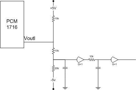

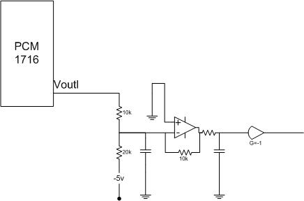

Anyway i have figured that i might as well rip out the whole analog part. I have tewo suggestions for analog stages does anyone care to comment.
The buffers are either 2604 or BUF634, maybe not a fair match but still.
OPamps are 2604.
Any drawbacks with either of these configurations other than the fact that the first one has the psu in the signalpath directly.

Hi!
Anyone know how much filtering theese dacs need?
The filter in my player seems to a third order filter at about 60kHz(A little guessing about the frequency)
I was thinking about something like the pre Carlos describes in the Chipamp section, with an suitable filter around it, as a outputstage for my player.
Do you think that would work?

Hi Tor.
I have considered a pot to adjust the offset.
I do not think i would use it n the first solution since it would be in the signalpath and i would like to avoid that.
The second solution is more interesting since it would be possible to replace the reference voltage and resistor with a current generator. It would be neat if i could make some form of feedback to adjust the current generator as a servo. The requirements would be that the cutoff frequency has to be small and i do not want to add too many components.

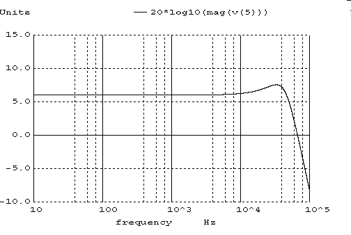

I also made some simulations of the attenuation in the analog stage, with a different OPA though (2604). This resulted in the following frequency response.
Maybe it is to compensate for the internal filter rolloff but i would prefer to straighten it out.

I am fiddeling, simulating mostly, with the idea to use a fixed dc offset compensation but it would require two opamps, both in inverting configuration though and one with a current offset at the output which is supposeed to be good (biasing to class A or almost).
I am not so experienced that i can estimate if a current source drifts or not. If not then i might get away with no DC blocking caps at all.
Wish i had the time to start modifying.
As for the remote. I would not use it to remove a preamp. Nobody i have heard of prefers the digital attenuation. I haven't played with it too much but a quick test indicated degraded performance.
Afraid i have no way to get the AD8620 in sweden.
