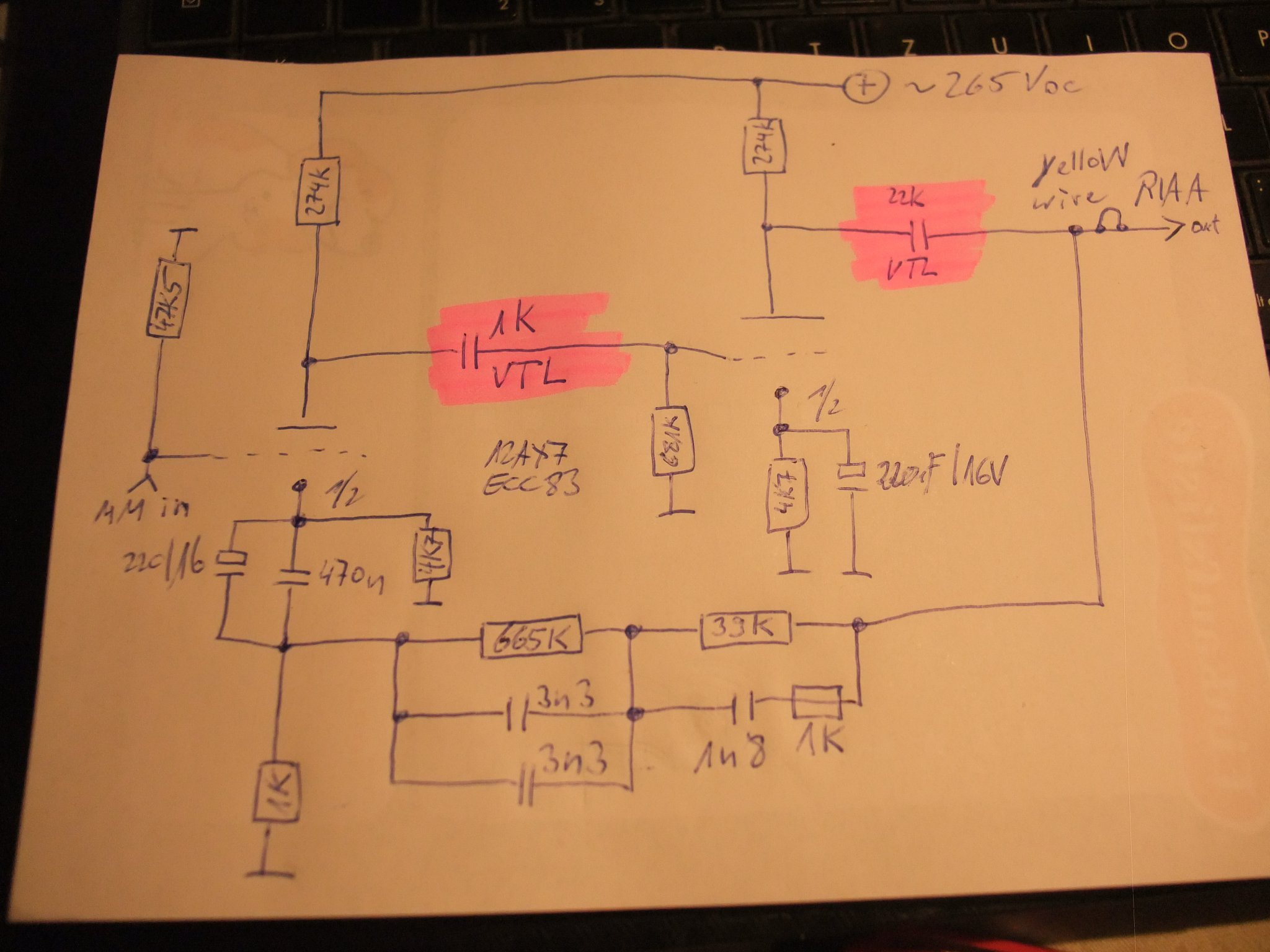

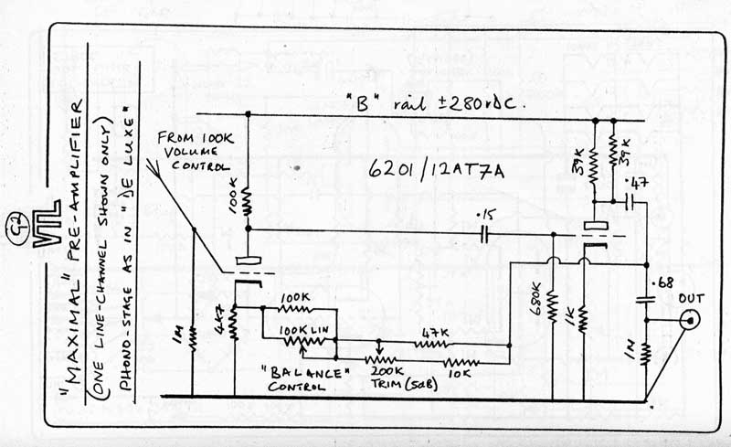

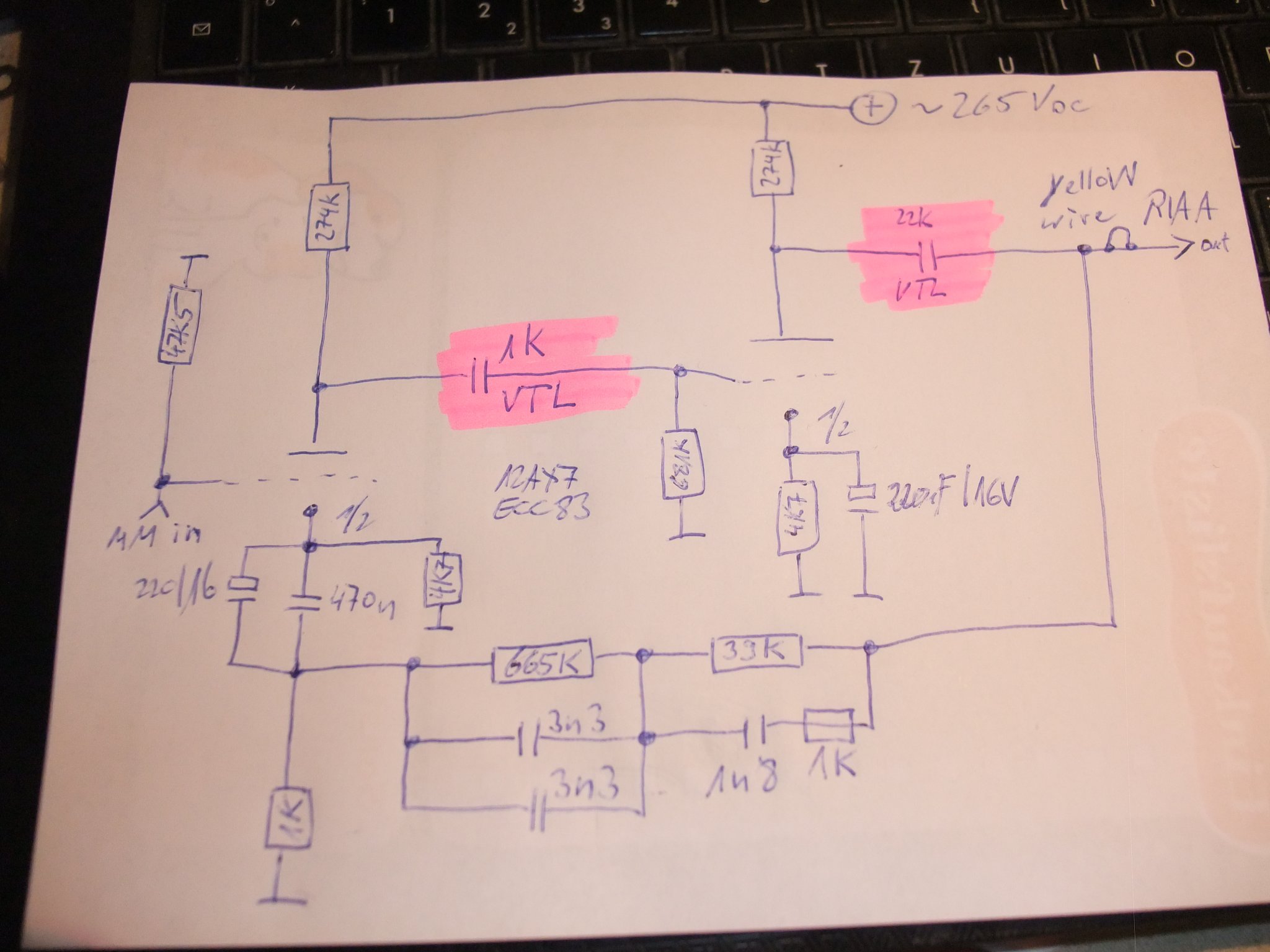

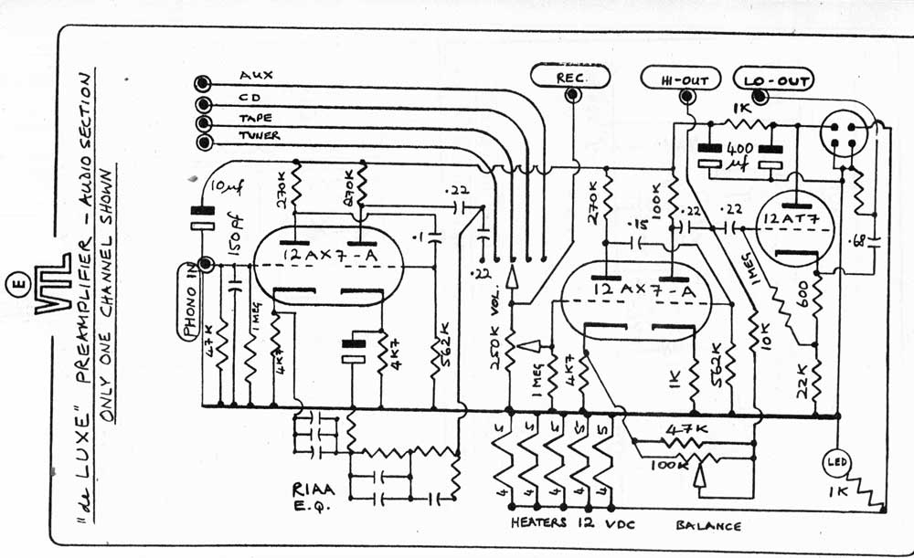

By the first picture of schematic (RIAA-phono stage) I miss the device for the input capacity. Which value was inside as standard ?ask ZM
in case that you have one in front of you - you can send me missing values in phono feedback loop![]()
Thanks for advice.
Thank you, very much.speaking of post #2 , first (left) pic is line stage , while second (right) is RIAA
150p is drawn and noted as input capacity governor
plus Herr Mueller effect

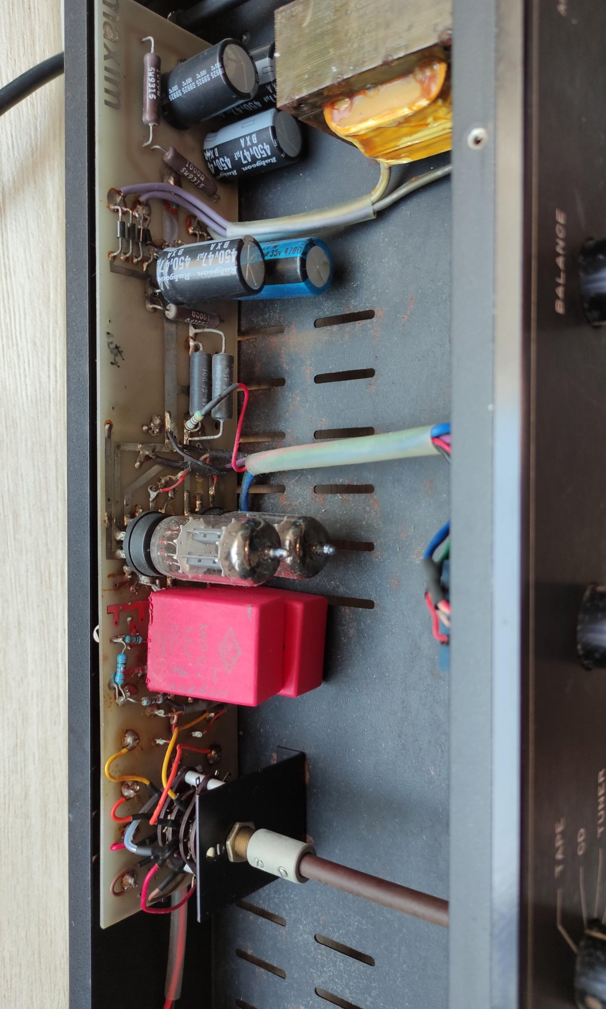

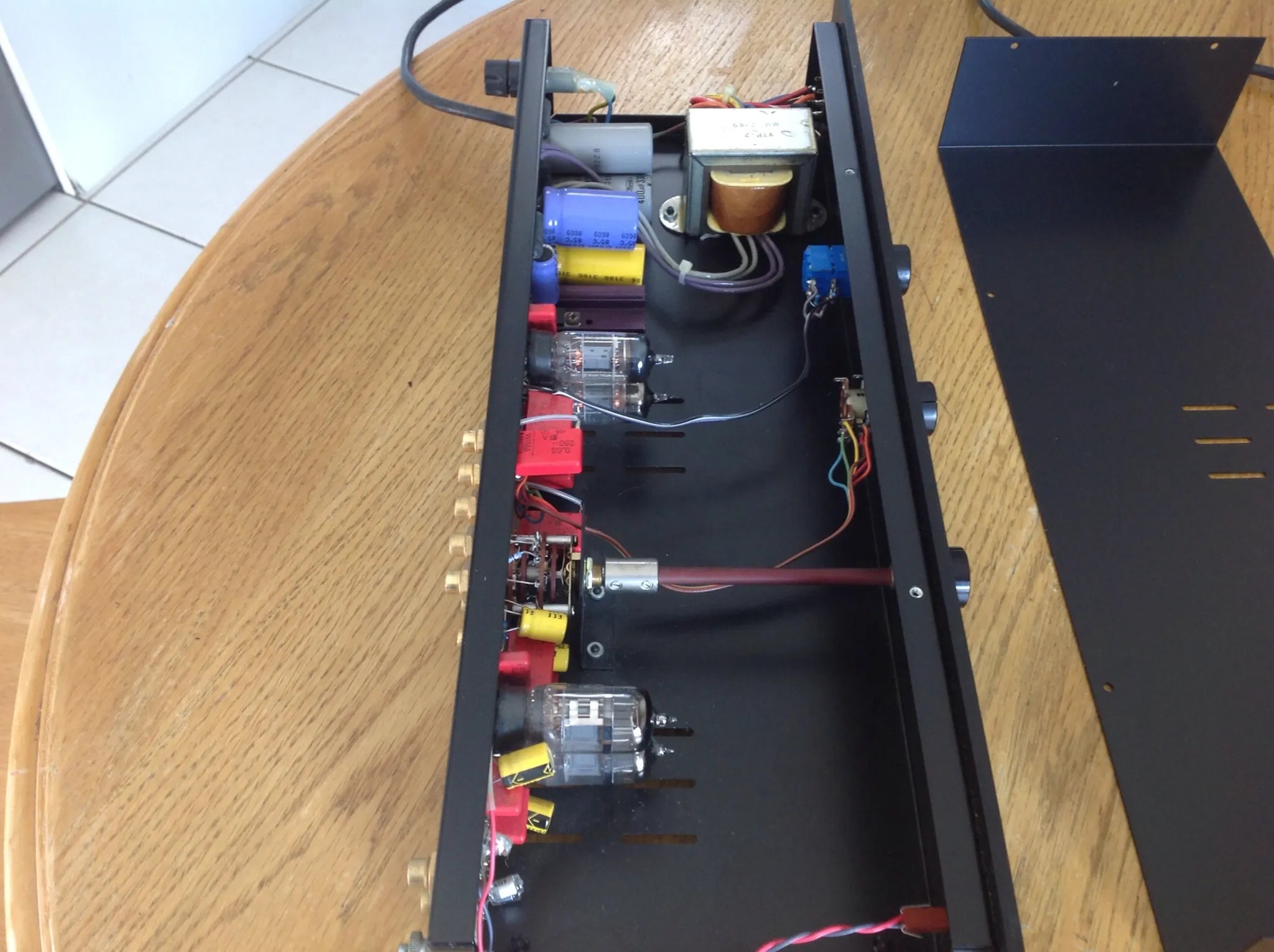

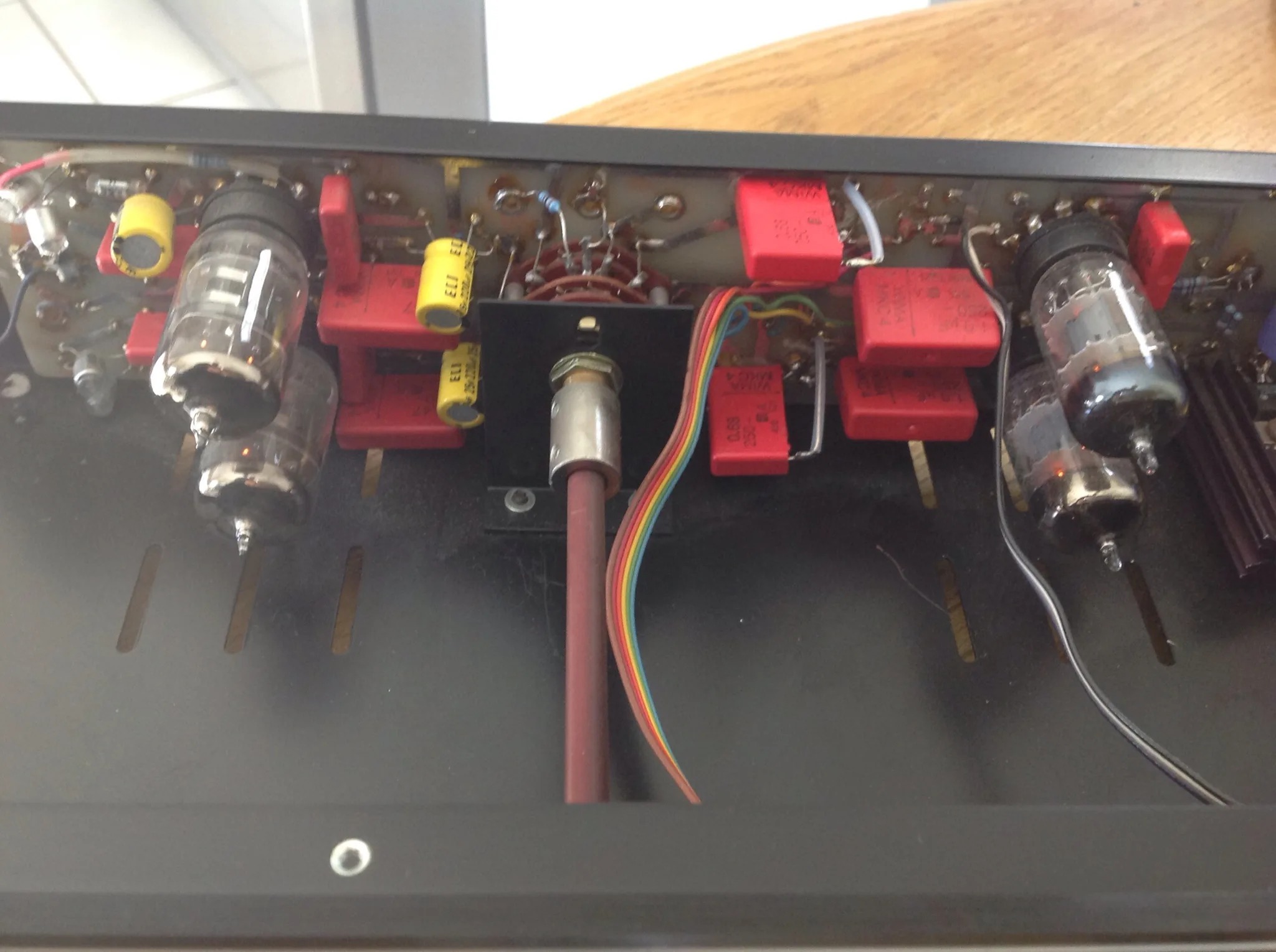

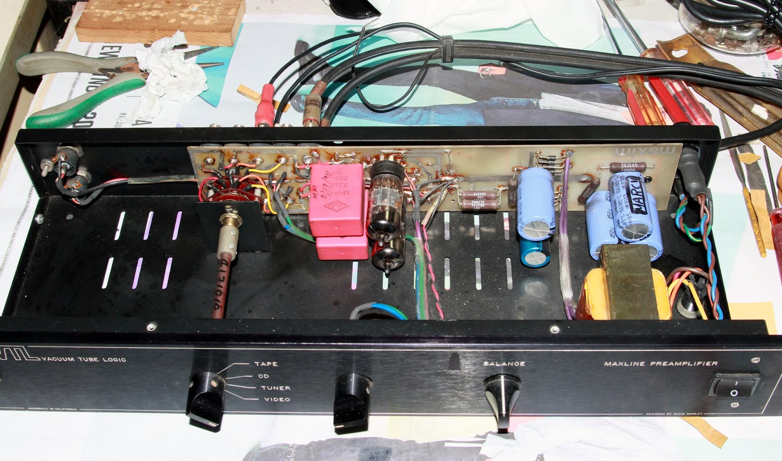

I am looking for images of the PCB, but the bottom view, so as the PCB layout.
Maybe this helps to avoid removing the complete PCB for troubleshooting, which is extremely time-consuming.
Thank you very much for upload.

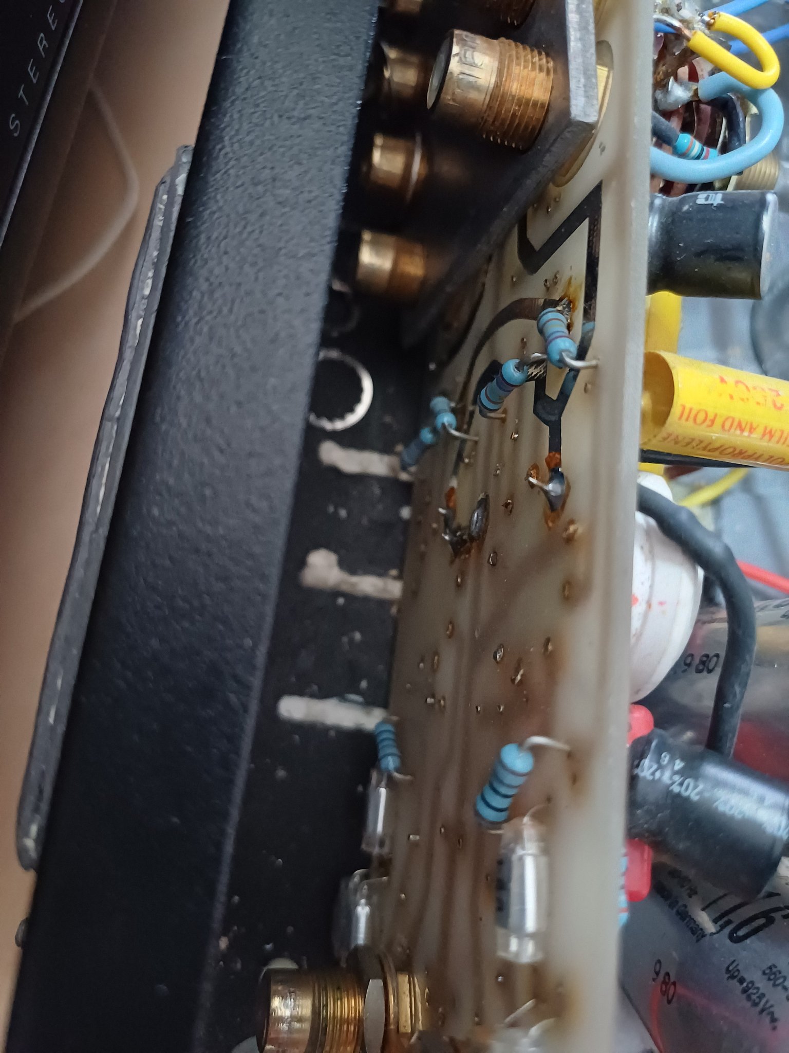

in the attachment (first image) the bottom view.I am looking for images of the PCB, but the bottom view, so as the PCB layout.
In the second schematic of post #3 there are no values noted for the RIAA equalizing network. Who know the values ?
Any experiences concerning replace the present couple capacitors (VTL labeled) by this one from Jantzen Audio ?

In the attachment my own created schematic of the device in question.in the attachment (first image) the bottom view.
http://www.jantzen-audio.com/superior-z-cap/
https://quint-store.com/media/files_public/75238661f2268347a6bdd066ec56d5db/Jantzen Superior-Z-Cap-List.pdf

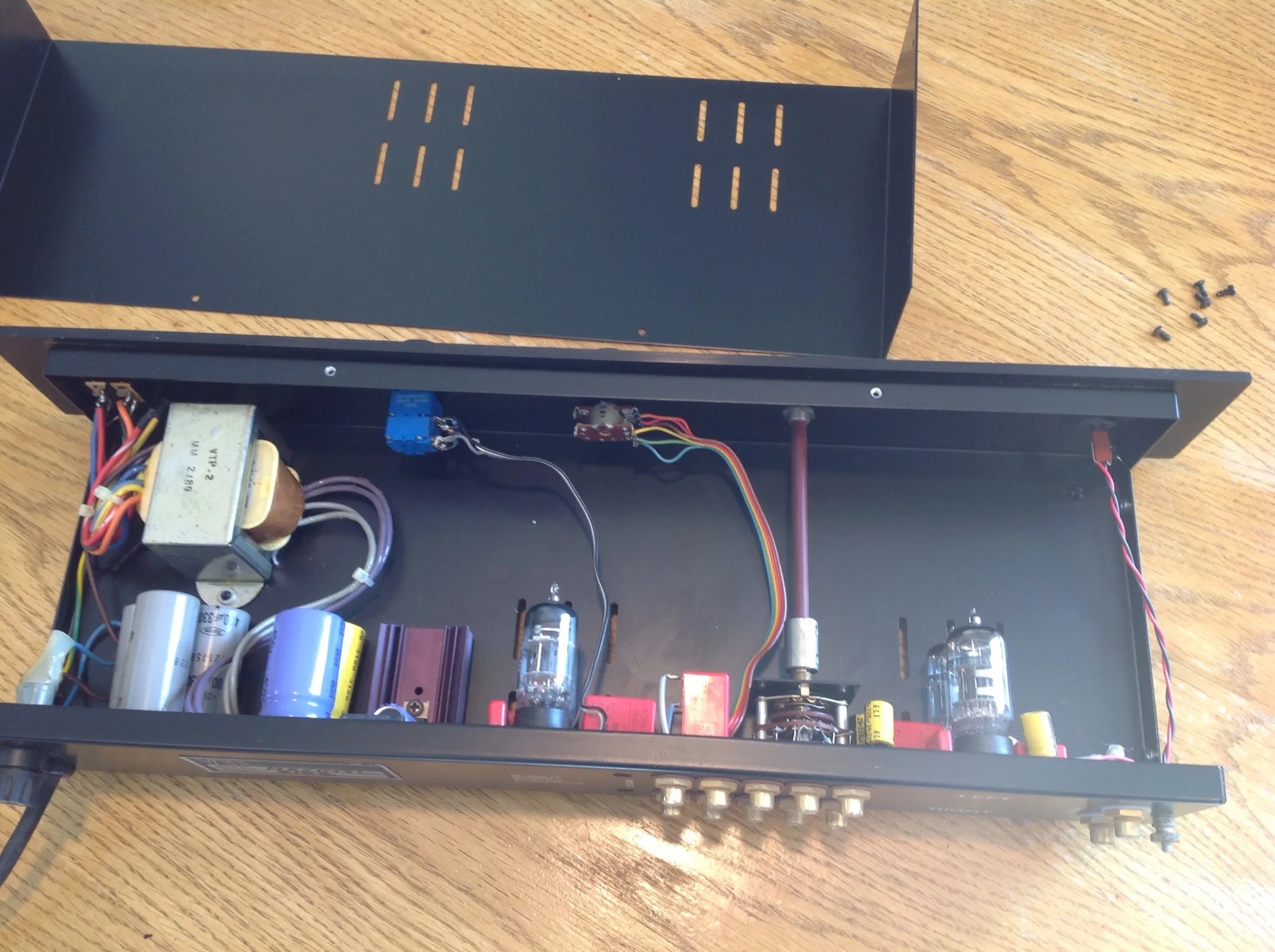

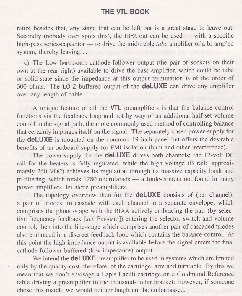

Main difference which I note to VTL's genuine circuit diagram are between
1) - the values of caps in the signal pad labeled with VTL (1K/22K = 1nF/22nF vs. 0,1µF and 0,22µF in the second schematic of post 3) and
2) - the not present cartridge input load capacitor in parallel to the 47K5 resistor (150pF in the second schematic of post 3)
the marked values on caps in the signal pad (1K/22K - labeled with VTL) haven't to do with those in real life. = 100 nF
Follow values I note by measuring with multi meter:
1K = 100 nF (0,1µF)
22K = 220nF (0,22µF)
P.S.: I want to know, what kind of bypass foil capacitor is a good choice to solder in parallel to the 220µF (between cathode and GND) - taking into account the limited space ?
Either one decide on an MKS/MKT version with a higher value or with the same size for a lower value - but then with the higher-quality - i.e. MKP/FKP version (due the low voltage condition on that point a 63V version is enough).

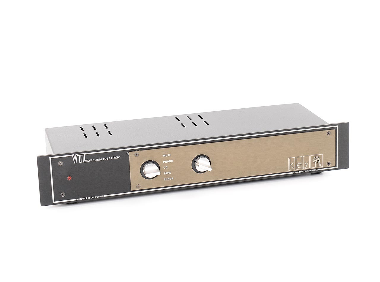

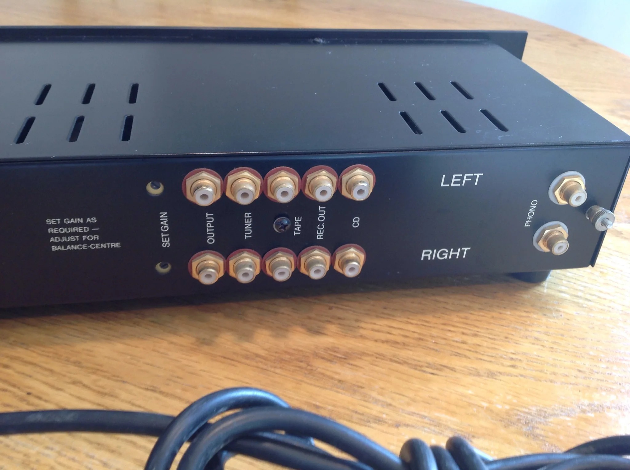

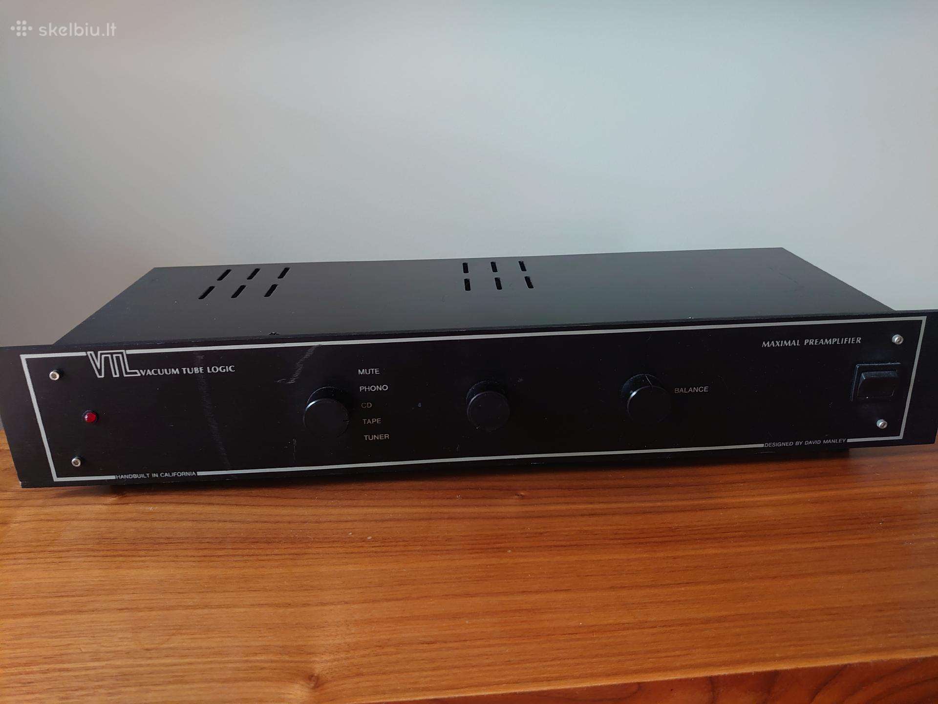

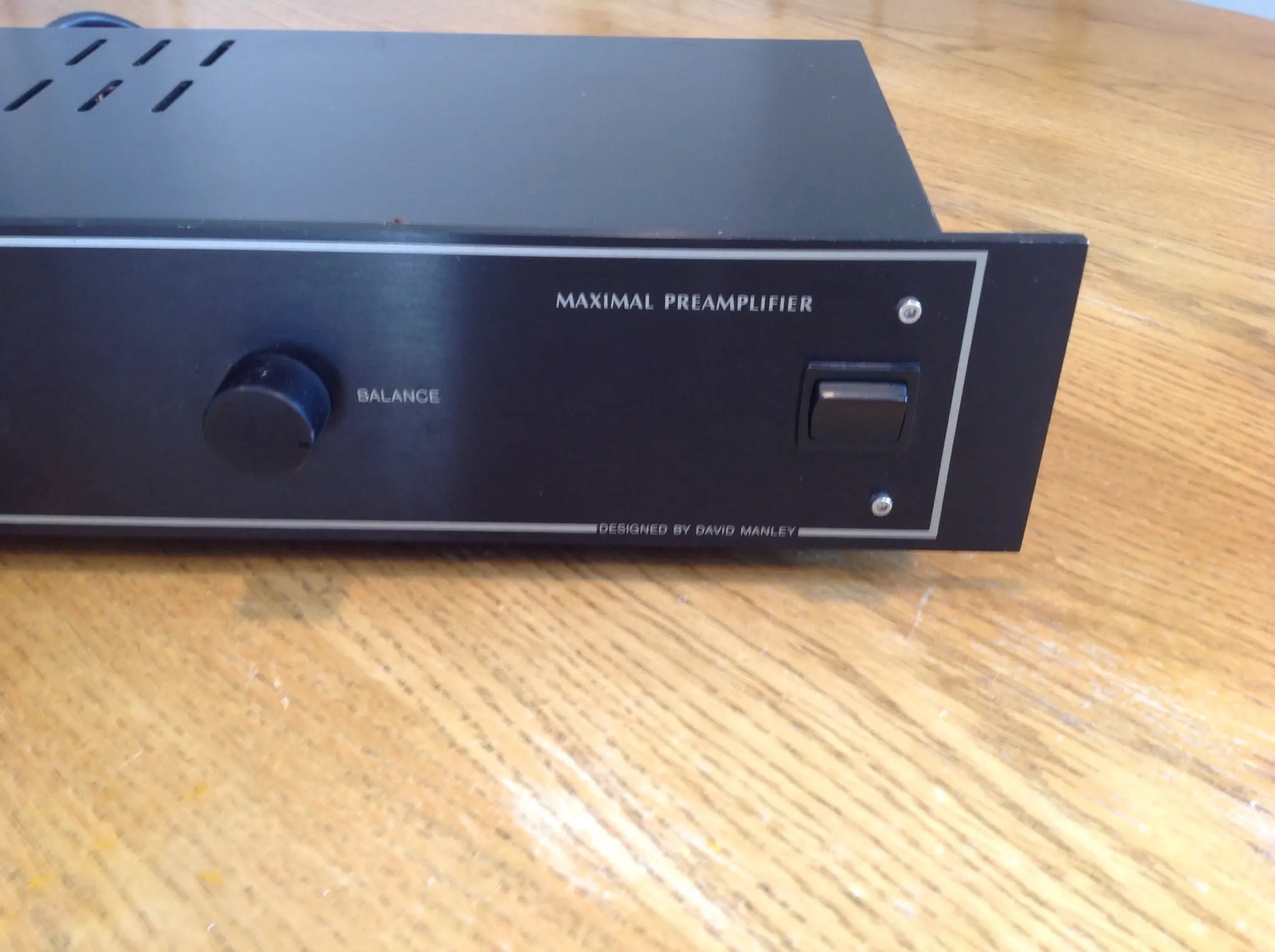

some images from various devices of this model

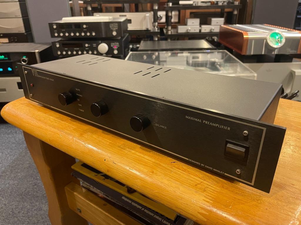

more images from various devices of this model

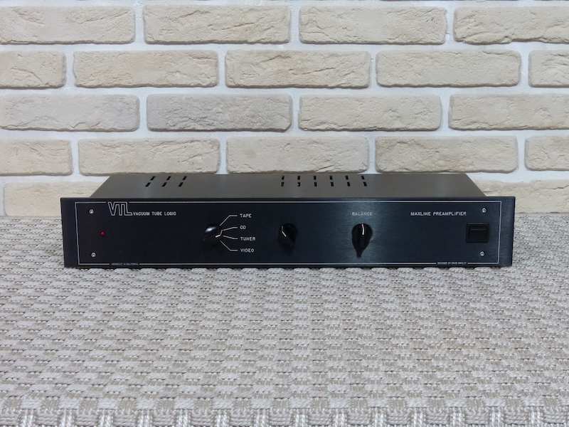

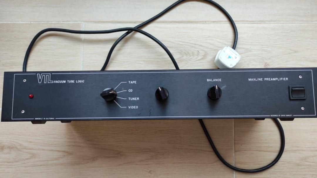

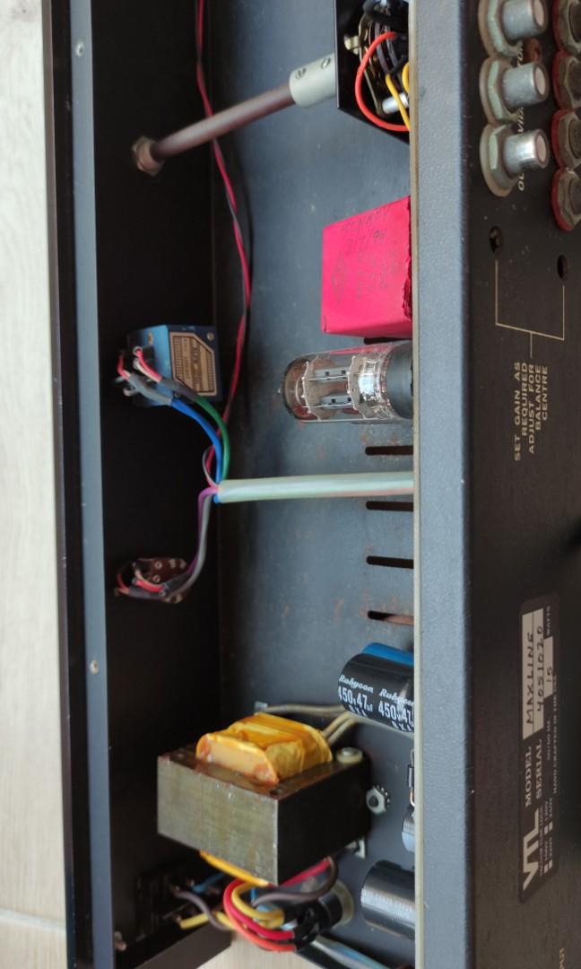

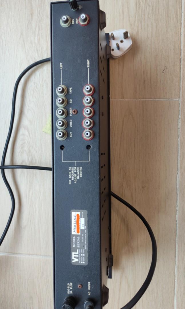

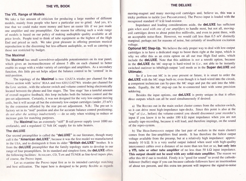

According internal images, the model "MAXLINE" is identical with the model "MAXIMAL" but without the RIAA-stage
