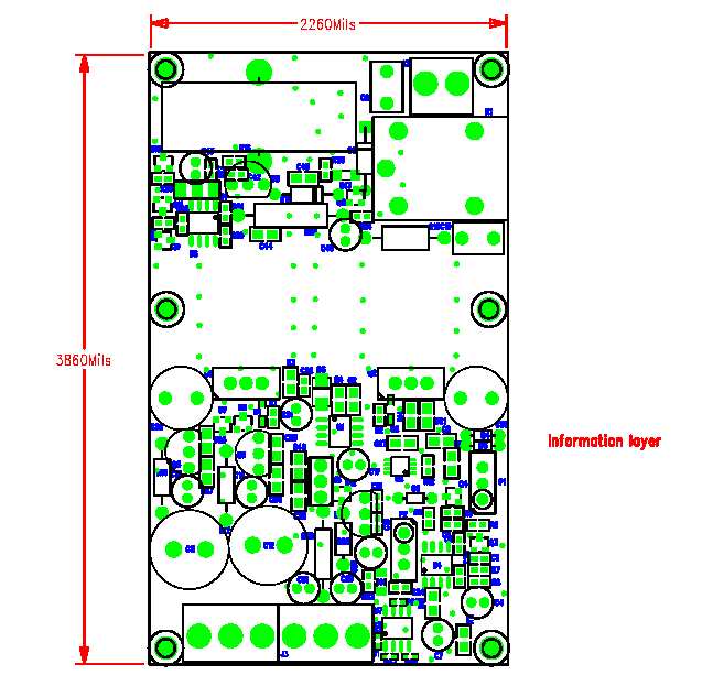

Hi All!
Pat!
I've also made an iraudamp1 without any protection. It's almost the same as you published first time in this thread (see the attachment). I used THS4051 from TI because here in Hungary I couldn't buy LT1220... IR2010 and MMBT5401 are also unavailable
. As last chance I replaced C7 with a 100u capacity and R7 with a 100k resistor. It doesn't do anything
. Could you help me?
As I observed the opamp couldn't push out voltage higher than 4V if it has 5V positive supply so Q2 never close so U3 always sense logically high level at its input (pin 1)... So, my question is if your LT1220 can push out voltage enough to close Q2?
Regards, lkadar

Hi, thanks for the interest in my project.
As far as i have tested, yes the output of the opamp was about close to +vcc, it is part of its specifications to be able to go very close to its +vcc swing. Maybe the opamp you use is not able to do so, you might try to add a resistor from B-E of Q2 as a pull-up, like 10k or so...
Did you check if Q1 is not part conducting ?
you migh try to disconnect the collector of Q1 and apply some signal to the input to see if it swing ok.
what is the gain of the BF942? might be the source of the problem, to duno.
i realy suspect that the opamp is simply not able to swing more than that. The LT1220 is precisely specified to do that.
They claims that the ouput swing voltage of the 1220cs is=±VS.

Hi all!
Pat!
Thanks for your help... It was my fault... I've put D3 into the PCB with reverse polarity
So, it works now with about 300kHz carrier... I'm going to change R6 (freq. pot.) with a higher resistance one to get higher carrier frequency. But there are some problems.
The first problem is that the coil at the output gets realy hot. I use T106-40 (Al=81) against the suggested T106-2 (Al=13.5). I think the problem is the toroid core gets saturated.
The second problem is when the input is shortcutted I change the output to 28mV in average with the help of R3 pot., but the output swings between 3.6V and -3.6V at the carrier freq. Can it be caused by the first problem?

Hi.
What is the vcc rails you have?
i have figured that below 25v rail, the freq. was lower than it should.
My inductor also gets hot, but only after 1h of playing.
i dont have my module handy, i think the 3,5v figure for the residual noise is higher than mine, a lot. You may have something wrong with either the inductor or the capacitor.
Mine work best with higher voltages like 30-35v rails. Freq. is 400.0000khz.
DC offset could be set with a multimeter, like a flike or so, like i did. I been able to set it a 0.0mv dc ofset, with something like +1 -1v rail residual noise,
hth.

How many turns are you winding in your coil? You have a T106-40, don't you?
I assume you know that the inductance is calculated as L(uH)=(N^2*Al)/1000
You should have something in the 15-40uH range. If you can tell us the number of turns, I can tell you the residual ripple level you should have for that rails voltage.

Hi!
Because its Al=81 (T106-2) and the requested inductivity is 18uH, the coil has 15 turns. And... yes... you are right. Rails are +-40V and the fileter cap is 0.47uF.

You should have around 2.66Vpp of ripple at 300KHz, or about 4.5Vpp at 250KHz with that values. (calculated with 6 ohm load, although it is very much the same on 4 ohm)
The heating of the inductor can be due to core losses. The ripple current in the inductor is about 4.3A pp.
If you use micrometal's software, you will find that, for a given current, voltage, and inductance, you have much higher temperature rise with T106-40 than T106-2, for example.
BTW: It is normal that your 12V regulator doesn't work below 25V rails, due to the series resistor that drops about 12V, so the input to the 7812 starts to fall below 13V and it doesn't regulate anymore. But I suppose you already knew that.

You must have some load connected to damp the resonance of the LC filter. Don't forget that the load is part of the filter. At least add a zobel network.
Have you tried with a 4 or 8 ohms load to see what the ripple level is then?
Tell us what you measure with load. It is specially important to know what the switching frequency is when you measure the ripple.

The heating of the output choke is due to excessive core loss. You must use a core with a much lower permability eg. the -2 material from Micrometals as suggested by Pierre or an eqvivalent core from Magnetics like the 55933-A2 (MPP).
