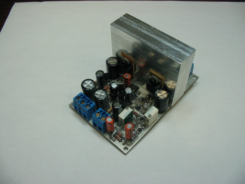

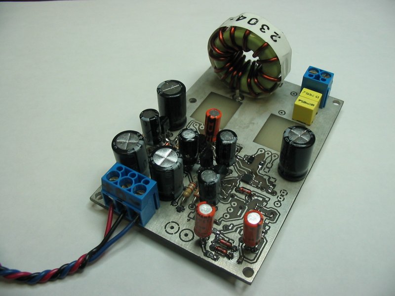

Hi, here is my PCB, i finaly found few minutes to do it.
I do pcb artwork for RF transmitters, as well as the design of them, so i cant mess that much with that. I am no beginner.

1.) Yes it was that statement from Bruno
2.) Pat's PCB looks cool. BTW: Knowledge in RF layouting is always a good thing when it comes to class-d amps.

wow, thats was quick...it is 99% complete, i have to machine the heat sink, and find a proper pnp transistor, i only have mmbt3906 where is it only 40v ceo...
thanks for the inputs.

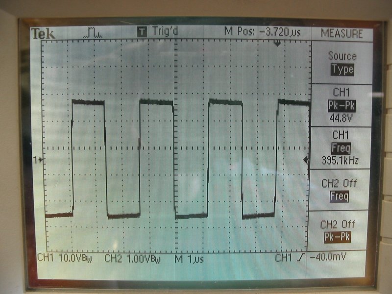

ok, one word: it works.
question tough...the bias adjustment of the op amp dont seems to change a thing, i tough i could be able to adjust the output of the amp, but it just operates at 0-5v triangle wave, no matter how it is set...so, what does it affect in this application??
The free running frequency is 395mhz...
