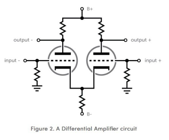

Like a standard tube diff amp? It actually works much better when both grids are driven differentially, since there is no common mode signal.
The negative supply for the common cathode resistor is important for best operation.
Diagram is from https://www.atma-sphere.com/en/resources-understanding-our-circuits.html

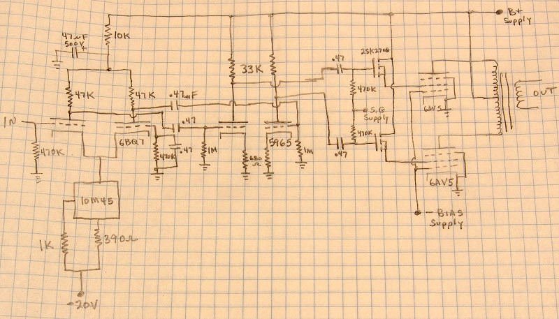

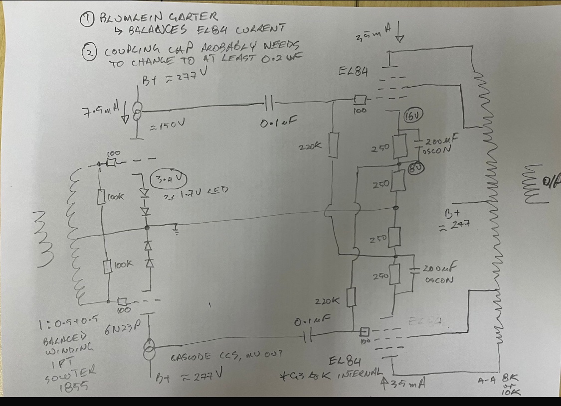

Here is an example of my earlier post. I subsequently changed to a single LED from the 2 LED string shown due to over distortion of the anode if it ever got a full 7V pk to pk input voltage with 3.4V bias and 7.5mA constant current for the 6N23P.
Voltages shown are measured values

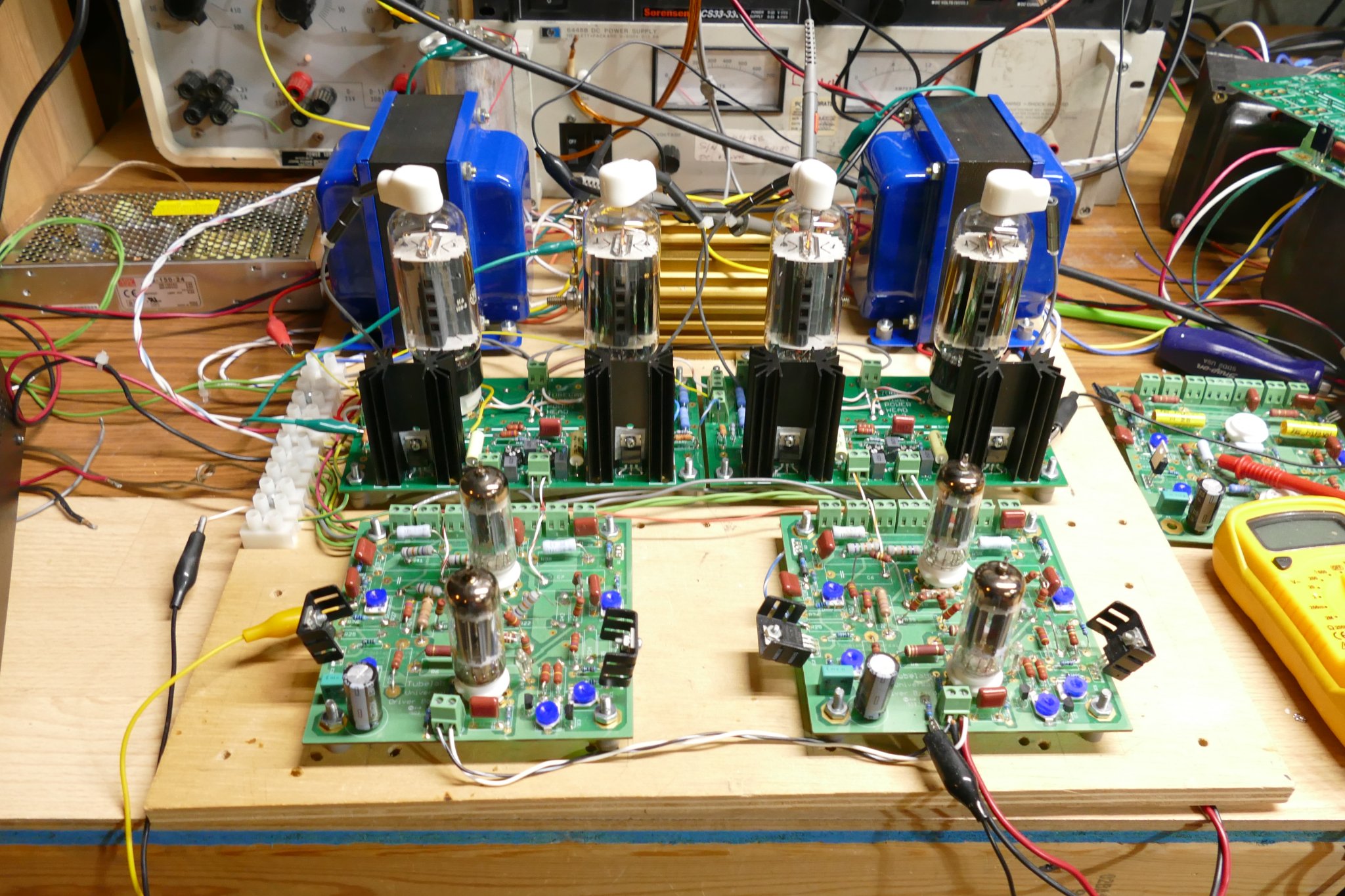

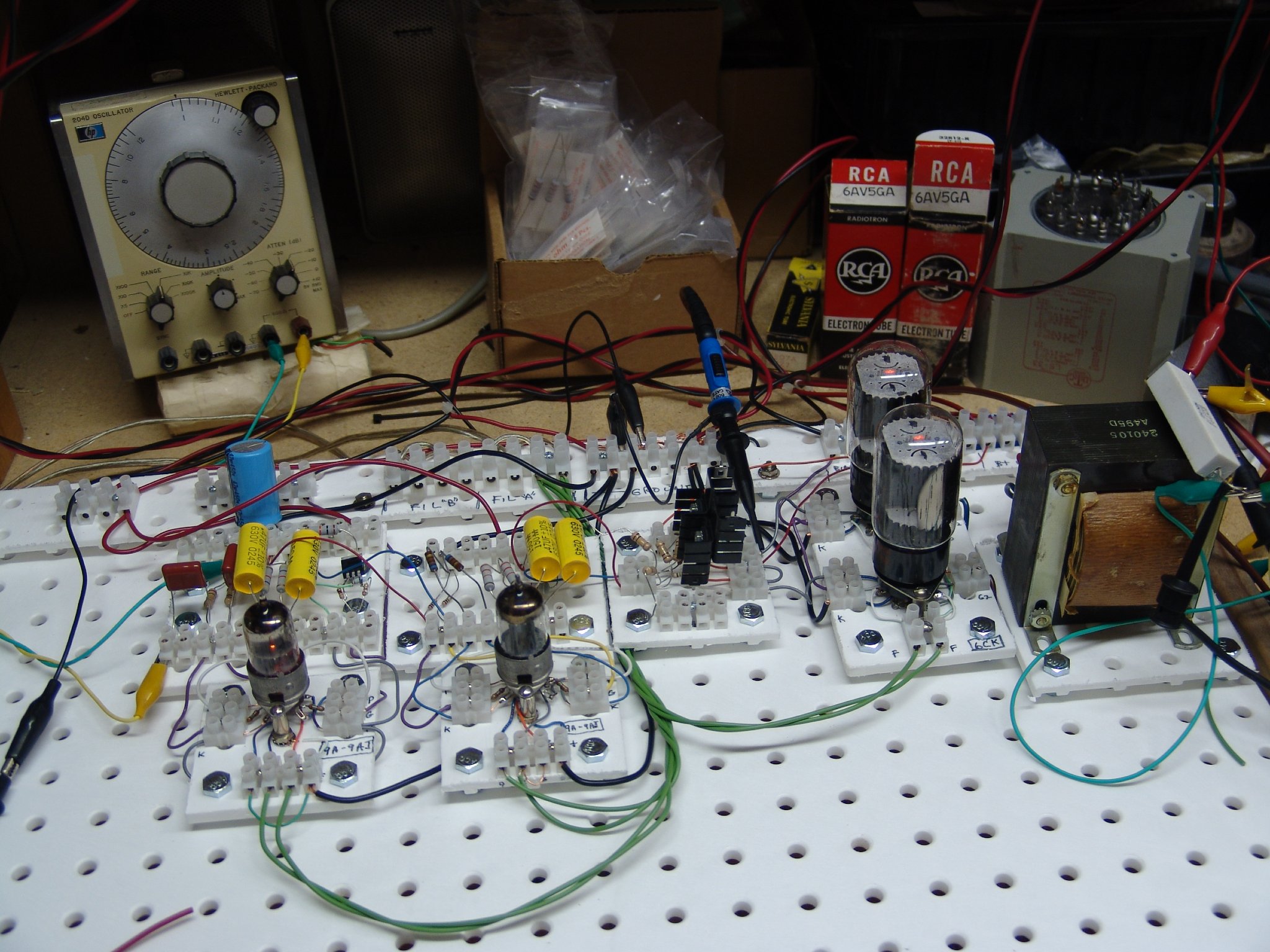

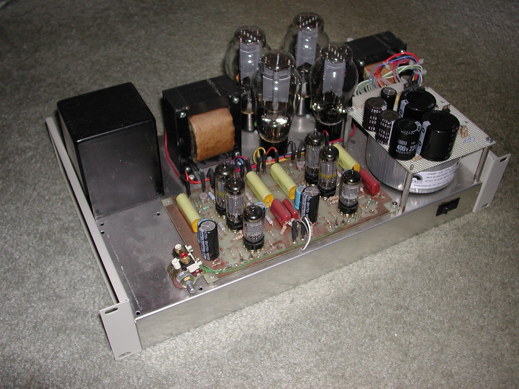

Here are several variations on a common theme. The concept had been proven successful with the 80 watt screen drive amp using a pair of 6AV5 sweep tubes back in 2005 and the 300Beast in 2001. What is now the Tubelab Universal Driver Board went through a long evolutionary period to become the board seen in many of my current experiments. There were many iterations of the design with different goals in mind. The design unfolds bit by bit in the 6L6GC in AB2 thread. My involvement starts in post #70, with the UDB concept beginning in post #94. This is an old thread. It details the design of an amplifier with several people contributing to the design and the builder of the amp in Australia. Lots of good knowledge gained for all, but it is a long thread that winds on for 9 years and almost 700 posts.
I made one-off DIY PC boards of the driver design at several places along the journey ending with the UDB board in 2015. Three versions are included here. The 300Beast had a unique driver board, and there were several test versions built on the Tube Lab breadboarding system I made in
The 2009 board was a test that included some experiments. The first stage is a typical Long Tailed Pair. The extra input to the left triode included a resistor for direct connection to the speaker output for global NFB. The pot in the cathodes is used to compensate for non identical triodes in the input tube. RC coupling was used to feed the grids of the second tube to avoid cascading DC offsets.
I put CCS circuits in both the cathode and plate circuits of the second stage to test some ideas. I had been working with screen driven sweep tubes a lot at the time, so I was looking for a way to get over 300 volts peak to peak out of two tubes. Obviously without the resistors across the CCS chips the circuit will have nearly infinite gain turning itself into an SR flip-flop. Ten minutes of testing revealed that you can put CCS's in the cathode, or in the plate circuit, not both. For a good fully differential design, put the CCS in the cathode The THD will be lower. The third stage is the PowerDrive circuit needed to drive the grids of a 6L6GC positive.
The TriPent board uses a pentode for the second stage for the high gain needed for directly driving a screen grid. I removed the coupling capacitors between the two stages, so offset correction is now needed. There is now an offset correction circuit connected where the second input used to be. Two identical LED's are used to create a matched positive and negative voltage sources. They should be close to each other for temp matching and the current through each should be the same, by tweaking the series resistors that feed them. The second input can still be used, but the two inputs could have a slightly different DC voltage so capacitive coupling might be needed. If direct coupling is desired, use the pot in the cathode offset correction circuit seen in the first schematic.
The 2015 schematic shows the current Tubelab UDB. By 2015 I had discovered that driving the screen grid of a sweep tube had an inherent failure mode that while unlikely in a typical music application, resulted in a rather nasty failure could fry lots of parts and did turn a 6HJ5 into a flash bang grenade and melted another. Screen drive was abandoned, leading to the Grand Unified Theory output board (two mosfets on every pin of the output tubes except the plate and heater) which led to UNSET. The need for 300+ volts of drive was gone, so the pentode second stage was no more. The LED's in the offset correction circuit were replaced with voltage reference chips. Theoretically better than LED's but I did not notice any change. The FB1 and FB2 inputs are used when output tube plate to driver tube plate feedback is wanted. Otherwise, the resistors are not populated. The question most often asked is, "why is there a neon lamp in the cathode of the input stage?" At first power on the negative voltage supply could be several hundred volts negative. The tubes are drawing no current because their heaters are cold, so the CCS chip will be saturated allowing all of that voltage to be present on the cathode, violating the H-K breakdown spec and possibly leading to failure. In normal operation the bulb will glow at power on, then extinguish once the tubes begin to conduct at which it becomes a 1pF capacitor.
I'm sure something can be put together from these three schematics to fit your needs. I built both Octal and 9 pin miniature versions of this design. Some people prefer octal tubes, but that limits you to a 6SN7 or a 6SL7 and a few mil spec versions like the 6SU7. There are many more choices available with 9 pin tubes, but in reality, for most applications a pair of 6CG7 / 6FQ7 or 6DJ8 / 6922 are sufficient for most circuits. If 300B's or other drive hungry tubes, or lots of feedback are used a 12AX7 for the first tube and a 12AV7 for the second tube work good too.

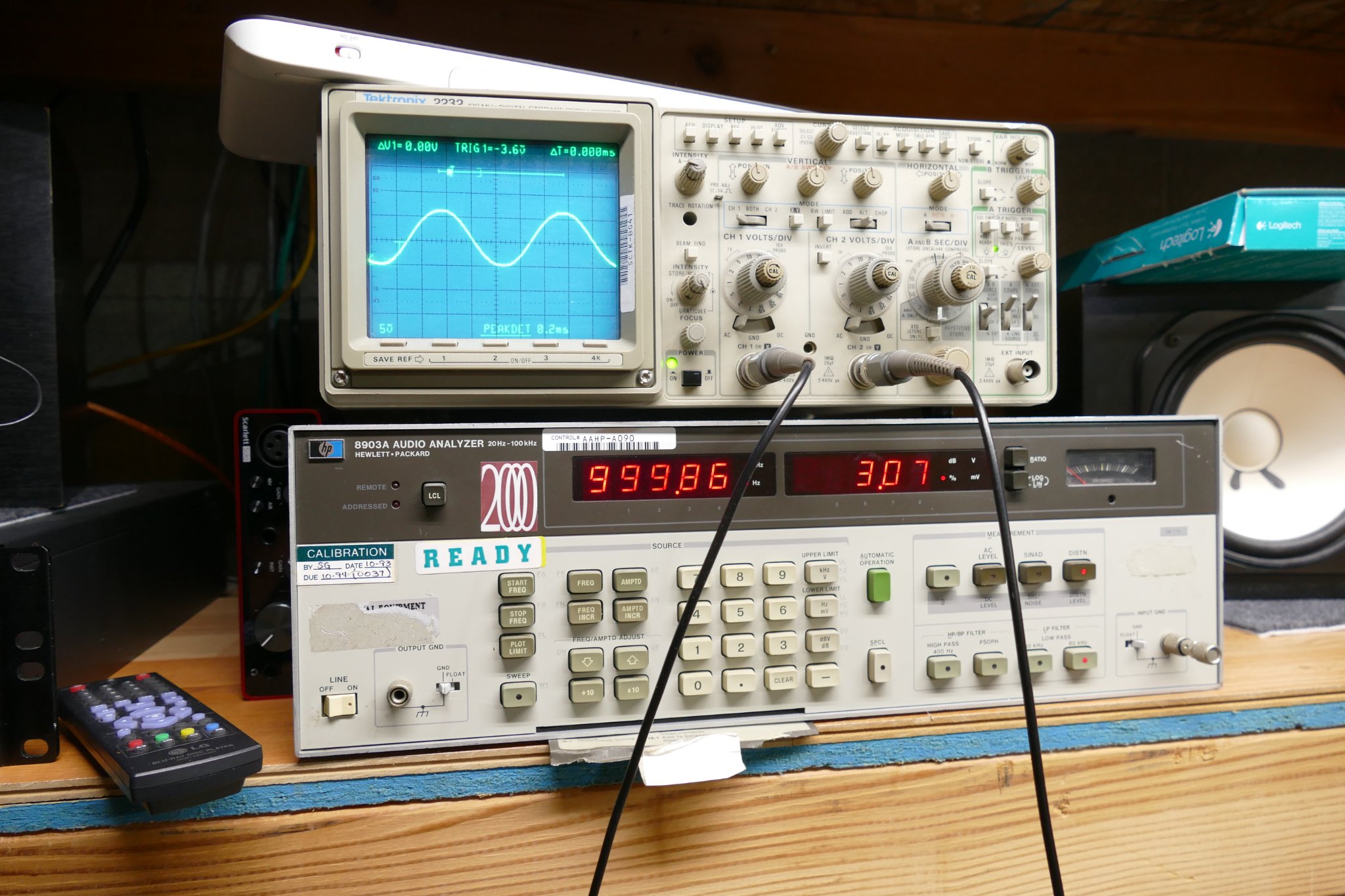

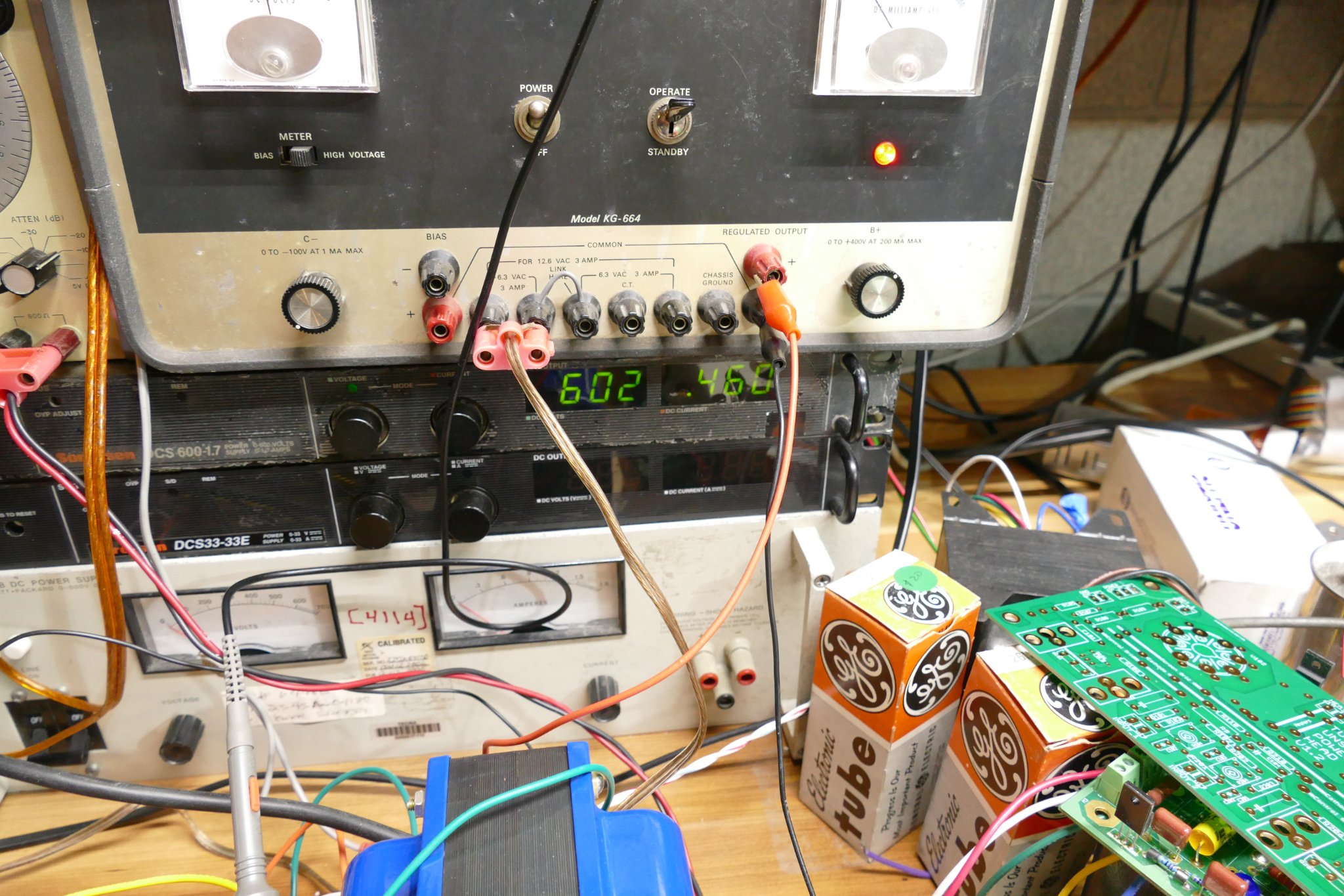

The UD Boards can push a pair of 26HU5 tubes to 202 watts at 3.07% THD on 602 volts in UNSET P-P.

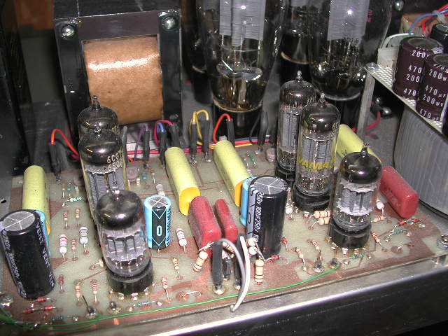

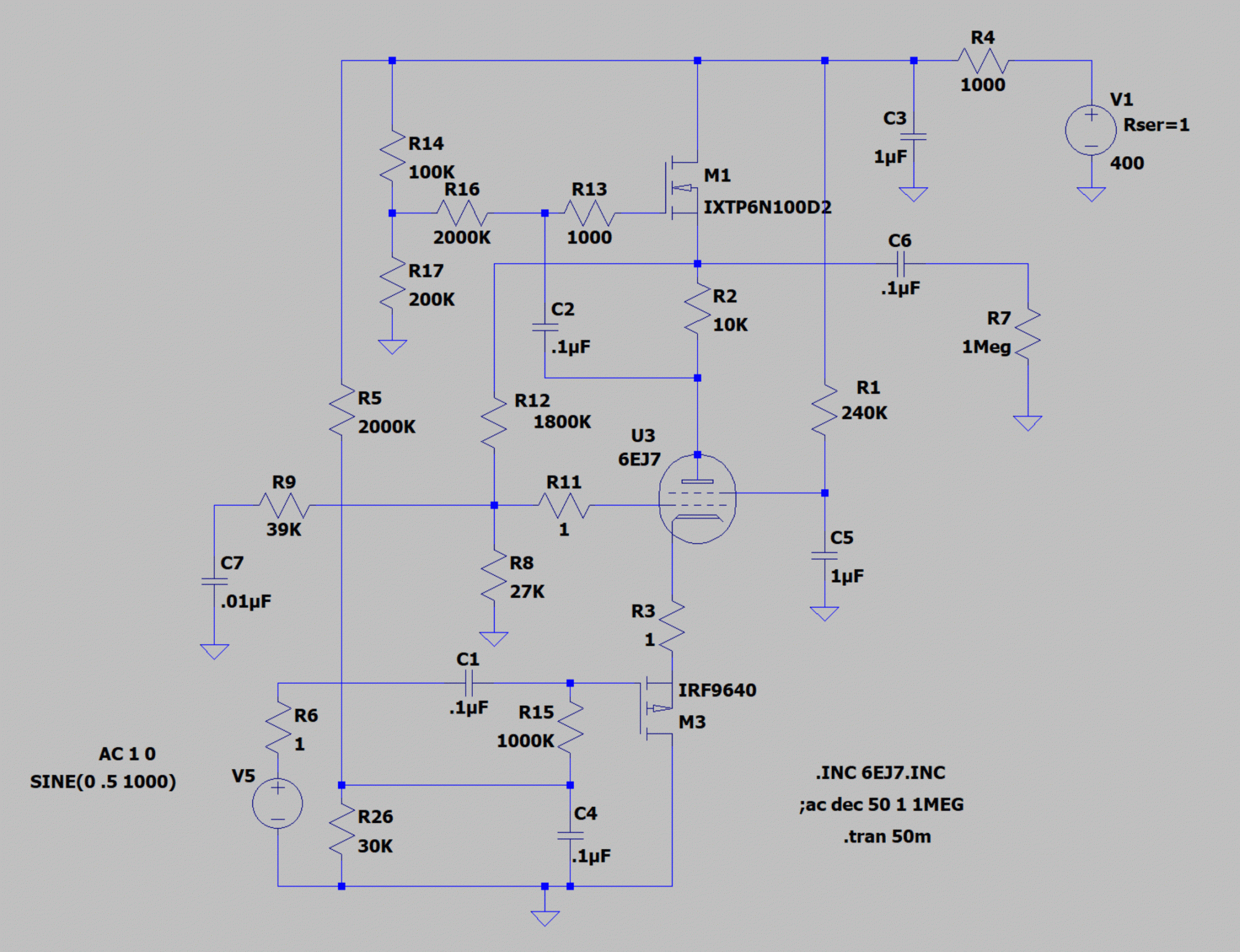

It has evolved to the circuit shown here. The bootstrapped plate load resistor provides the near infinite load impedance (R16 is the 2 meg pot). The R14 - R17 voltage divider sets the plate voltage. A pot can be used here to allow for a wider range of tonal mayhem. The "Schade" feedback (R8 - R12) with the signal input applied to the cathode allows for adjustable plate curves. R9 can be varied to set the feedback level and C7 adjusts the gain "tilt." The tube used is a 6AU6 or a variant with an odd heater voltage. The octal 6SJ7 is too microphonic. A DN2540 or just about anything I tried works fine for the plate mosfet.
