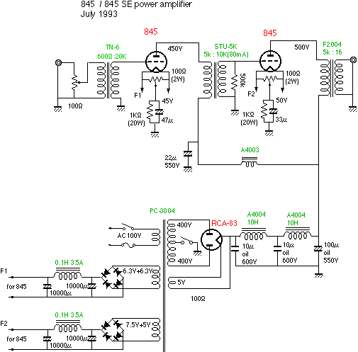

If you are open to the idea of driving a 845 with another 845, then there are copies of Sakuma's schematics floating around the internet. In theory this is a better approach since you get more distortion cancellation, but I have never built one to confirm.
The Sakuma is an interesting project. I didn't make the math but I think you get low power from a 845 fed with 500v (4-5W?).

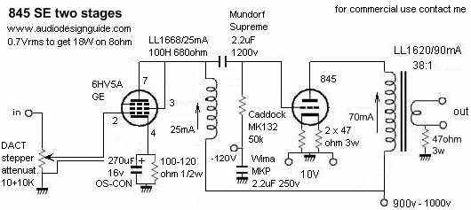

Truth be told, I'm not convinced it is an effective solution. In my opinion the only reason people build a 3 stage amp with a 211 driver is because they want to build an all DHT SET amp with 20 watts of power. For a 845 to put out ~20 watts you need about 300v peak to peak of ac voltage on the grid. Your average audio source usually puts out 2v rms which is about 5v peak to peak. This means that you need to amplify your 5v input signal to 300v which equals a gain of 60.
Most DHT tubes are usually pretty low gain. Usually less than 10. The 211 is unique in that it has a gain of ~12.
In a perfect world you could use a 1:3 input transformer to bump up your input voltage to 15v, then the 211 would amplify your 15v to 180v, and finally you would have another 1:2 interstate transformer to further increase your signal to 360v peak to peak.
Happy days right? Not so much. The miller capacitance of the 211 becomes a MAJOR problem. On it's own the miller capacitance of a 211 is about 160 pf which translates to an input impedance of about 60Kohms at 20Khz or 35Kohms at 30Khz. Most preamps that I know of can drive that load somewhat comfortably. However, because you have an input transformer with a 1:3 stepup, the miller capacitance is reflected back to the primary by the square of the turns ratio. So since you have a 1:3 step up, your miller capacitance at the input is 9 times that of the 211 grid or 1440pf. This translates to an input impedance of about 5K.
That's not a great load for a preamp to drive, so to compensate, people will add in a 3rd driver stage that acts as both a gain stage, and a buffer to drive the miller capacitance of the step up transformer and the 211. The 300b is a good choice here since we don't need a ton of gain, and it has a very low plate impedance of around 800 ohms.
It all seems like a good idea until you realize that something like a single D3a without any interstage transformers can drive an 845 to full output with a lot less noise, distortion, and phase shift.

In agreement with the two preceding posts, look up Grover Gardner's 845 amp. Replacing the interstage transformer and 211 tube with a parallel connected 6n7 driving a triode connected EL34 makes a lot of sense and will allow you to put your money where it really counts, into a state of the art output transformer.
A schematic with a D3a is something I have not found around yet, interesting solution. I have the doubt why you posted a schematic with the 6hv5a as a driver (nice shcematic!).
Sorry, maybe it's a stupid question but why the input/interstage trafo should introduce higher noise and distortion?
The transformer doesn't make the noise. The 3rd tube makes the extra noise.

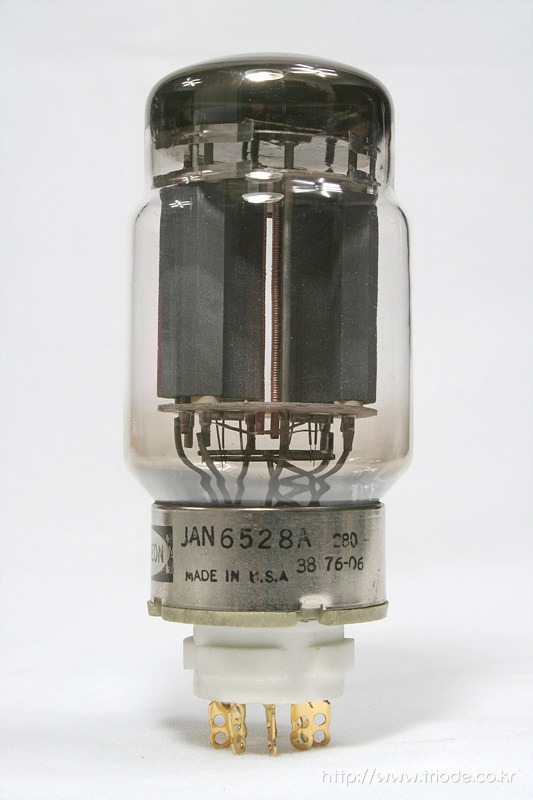

Some time ago I saw an 845 push-pull amplifier driven by a 6528 valve on the net. This valve has a very low internal impedance (245 ohms) and good gain with a mu of 9 (equal to an 801A). I am not able to do complicated calculations, but I like to imagine a possible 845 SE design where the 845 is driven by the 6528 via an interstage (a Lundahl LL1677-80mA designed to drive the 845 from a 300B). Also, if the total gain would not be sufficient there is always the possibility of adding (instead of a third stage) a 1:2 or 1:4 input transformer (Lundahl LL7902 or LL7902). Can anyone calculate how much oscillation the 6528 would be capable of as a driver?
