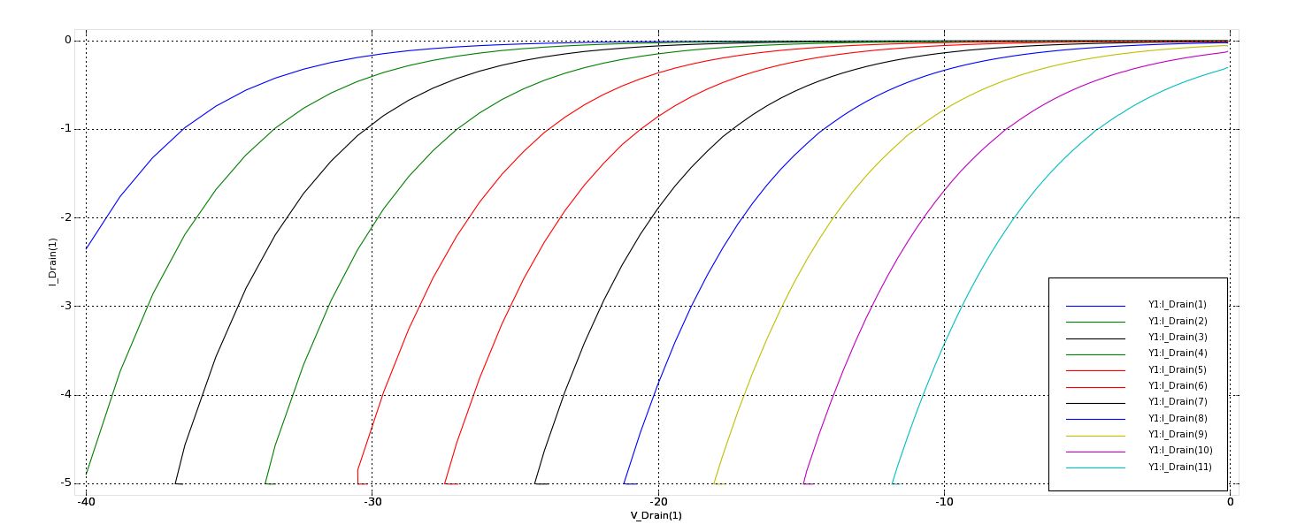

I recently listened to Nelson's Schade BAF discussion. Then I read ZM's M2/SEF thread. Below is the IXTN210P10T with 100K and 3K as the Schade resistors.
From left to right, Vgs = 2.7, -2.8, -2.9, -3.0, -3.1, -3.2, -3.3, -3.4, -3.5, -3.6, -3.7
I have an idea for this device in this configuration.

The curves threw me off a bit till I saw that x and y axis is labeled with negative values, my brain works better seeing |absolute| current Id and Vds values.
Bloody dumb brain.
I could make a calculated result of the absolute value for both voltage and current and plot those. Same process as plotting transconductance. That would require at least a few seconds of work in the curve tracer software. Call me giga-lazy.
Actually, I like to see the sign of what I am measuring. For a depletion mode part, the sign of Vgs is opposite of the sign of the current. I like to see that opposite relationship both in the spreadsheet results and the axes of the plots. The hardware is a pile of sourcemeters that can work in all 4 quadrants of V-I. Positive and negative voltage and positive and negative current (source and sink).

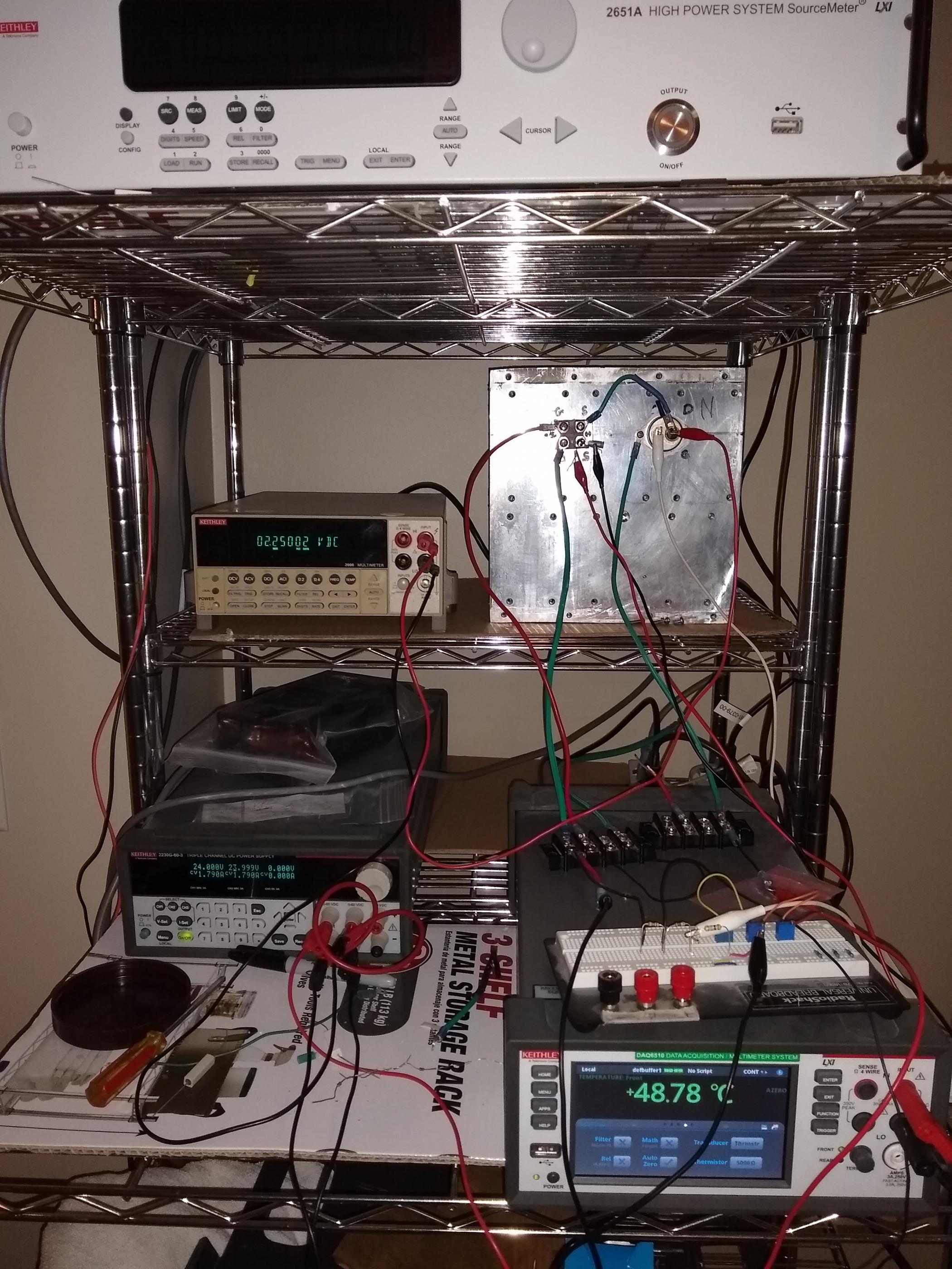

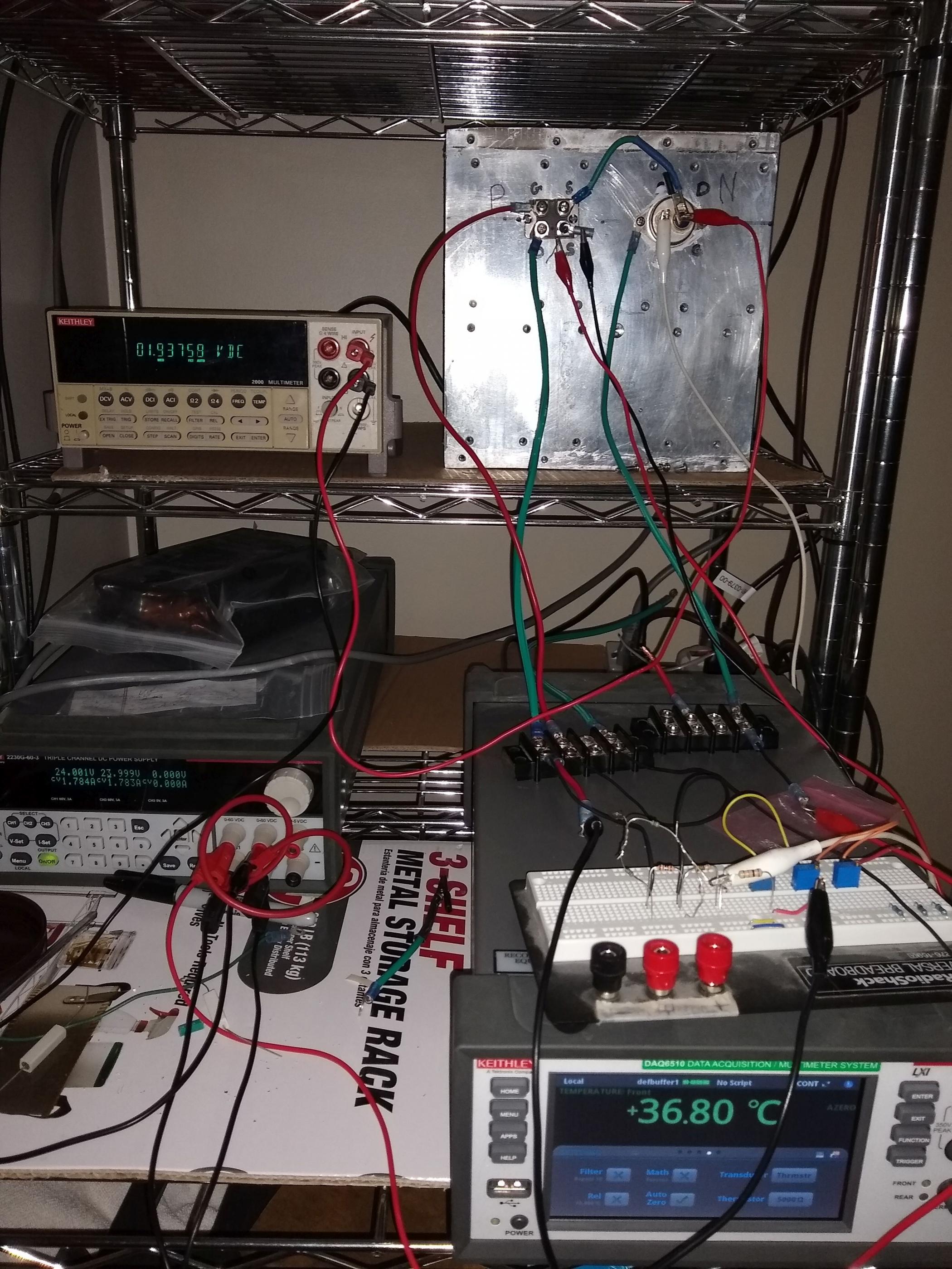

DEF + Schade P-FET + SIT
The Schade resistors are on the proto board in the foreground along with a 10k from SIT gate to ground. The 3K Schade resistor is between P-FET gate and SIT gate.
The picture is at 36.8 deg C. Ids 1.784 deg C.
At 45 deg C, Ids is 2.2A.
It is fairly simple to add resistance in parallel with the 220K Schade resistor.
Can this arrangement be called DEFiSChit ?
48.78 deg C. Removed the parallel resistor across the 220k resistor. Ids 1.79A. amps. I wanted to keep final current under 2A.
The DC offset is large; 2.25V. I am guessing that this can be corrected with a negative voltage applied to one or the other gate.
