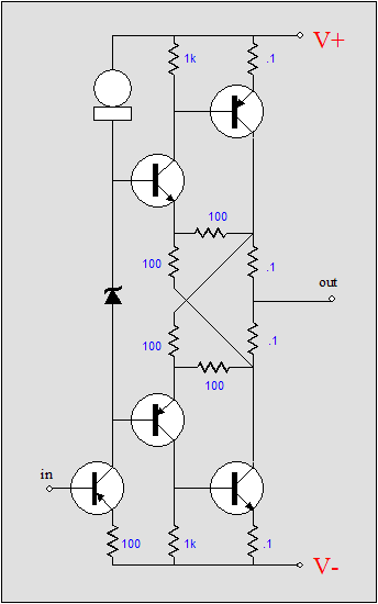

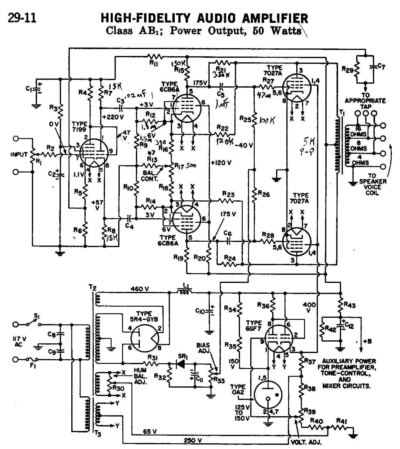

And then there's the new kid on the block: "Magic" Schade feedbacks or Output Voltage plus Differential Current Sensed Series Feedbacks. OV+DCSSFdbk or "Magic" for short. Gets rid of crossover distortion for class AB. (requires some overlap in output stage conduction, driver is class A differential)
European Triode Festival and Crossover Notch Distortion and New OTL Design
(2nd diagram up from bottom)
Hope it's OK to attach the diagram from Tubecad, Dec 20, 2006.
And then RCA RC-30 Handbook, page 696, attached.
Here the cathode feedbacks to the driver are the equivalent, except would need a CCS tail on the driver. The current sense resistors are implicit in the DC resistance of the primary windings.
edited to remove distortions!

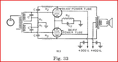

Back to the core of the question at hand, from everything posted here I still feel that what O.H.Schade described is now classical feedback with an input resistance and a feedback resistance. The equations can be derived if the Thevenin's equivalent of the preceding stage is used as the input to the gain stage with feedback.
The output impedance (including next stage grid resistor) becomes the input impedance of the feedback equation.
This to me looks like fig 33b for single ended or 33C for PP.

Not so fast...
The circuit in 33(c) doesn't depend on the output impedance of the preceding stage to determine the feedback ratio. It subtracts the feedback voltage from the drive voltage at the node where the voltage divider tap connects to the coupling transformer winding. The feedback induces no current in the input circuit. This one generally requires a lot of drive voltage.
There are at least two other ways to get feedback from plate to grid. One of these is with an input resistance and a feedback resistance forming a divider, the tap of which is connected to the grid. In this circuit, the output impedance of the preceding stage is added to the input resistance. If there is a grid resistor, it's bootstrapped by the feedback and only a fraction of it's value contributes. This type generally needs a lower drive impedance and substantial drive voltage (to drive a pentode power amp stage with low output impedance).
The third topology I can think of is perhaps a special case of the second, where the driver dynamic load is mostly made up of the current through the feedback resistor. Examples are the Tabor from Gary Pimm and the DCPP amp from Pete Millett. The driver pentode acts as voltage-to-current converter loaded by the feedback resistors. Thus the grid-plate voltage of the output stage is a function of the input voltage to the driver pentode stage. The RH84 etc. do this using a triode driver. That's actually not so bad because the triode's Ri as well as any grid resistor or driver plate load resistor are bootstrapped by the feedback. This type is to me most efficient in terms of overall power gain for the circuit effort; the input pentode only needs to swing the output pentode's grid voltage. As a plus it offers the potential to get differential feedback in push-pull mode to smooth out the crossover distortion (or operate closer to class B). This one also produces the lowest effective plate resistance, close to 1/gm.
