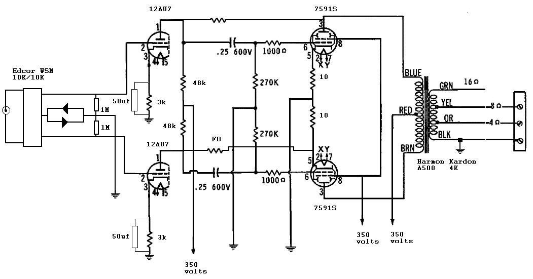

Hey guys I'm back to working on this amp. I've used the Edcor WSM 10k-10k as an input transformer twice now. Both Pete Millet's two stage 6SN7 uniamp front end. One driving 2A3 and the other driving Ad1's. Both sounded very good to me and those who heard them. Plus I think they are about $10 each.
Any way, I've come up with a new schematic using 12AU7 and 7591. I did the calculations and 7591S needs minuscule current to drive it and only about 34 volts pp so 12AU7 can be run conservatively. So I've attached that schematic here.
By the way its running fixed bias at about -17 volts which is not on this schematic.

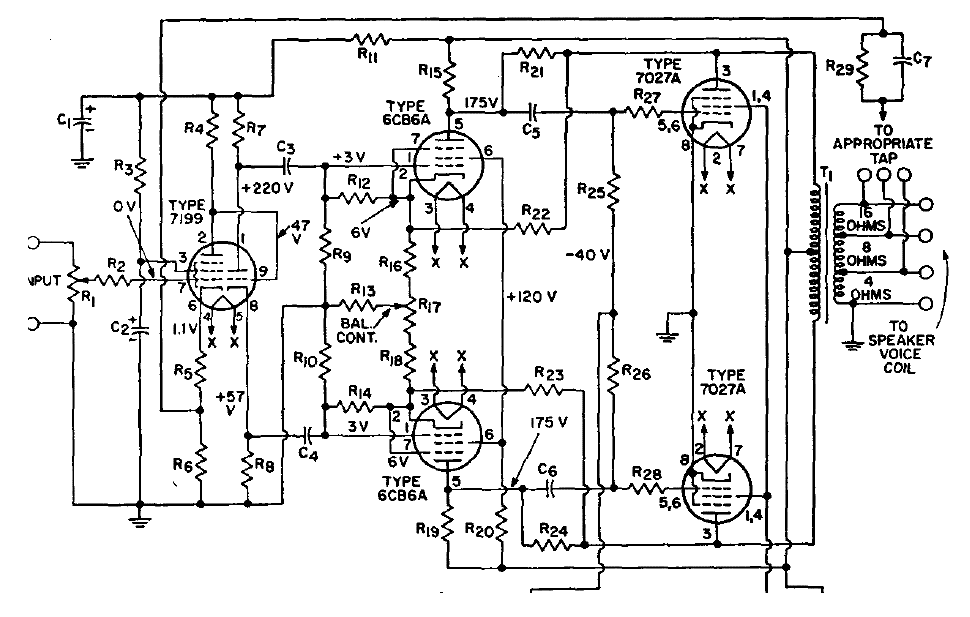

And a question? SY turned me on to this schematic in a earlier post (see attached). I've built a couple RH84's and liked the sound. All of the RH amps use plate to plate feedback. The attached uses Schade feedback at the plate and the cathode. It also uses global feedback. My question is what is the effect of feedback at both the plate and the cathode? In this case R21 is 330k and R22 is 150k. Does Schade feedback conform to a formula? Or is it trial and error?

Is a high Rp neccessary to use Schade feedback?
What people call "Schade" feedback is parallel applied voltage feedback. O.H. Schade actually used series applied voltage feedback in his paper, so it is technically incorrect to call plate-to-grid or plate-to-driver plate feedback "Schade feedback."
Parallel applied voltage feedback lowers the input impedance of a stage and makes it very difficult to drive. You can take a couple of approaches to solve the problem. You can drive it with a very low output impedance and set the feedback ratio by placing a resistor in series with the low driving impedance. That is the approach I took here. It gives very consistent feedback and very low distortion in an output stage.
Another approach is to choose a driver tube that has a plate resistance equal to the desired input resistance to the feedback network that you desire to create. The resistor doesn't actually exist, but you are using the plate resistance of the driver as that resistor. It is a very elegant design trick.
The driver tube operates into an almost vertical load line with very little voltage swing, so you need to select a tube that has evenly-spaced curves into that nearly-vertical load line. This is why pentodes are generally recommended. This is also why the Kitic designs receive so much criticism; Kitic chose tubes that don't have evenly-spaced curves into a vertical load line. Also, rp of the driver tube in the RH designs will vary wildly (compared with a pentode) throughout the signal swing, which will give varying feedback with signal swing, which will give varying damping factor with signal swing. All of these are things that we normally try to avoid.
So it is certainly possible to choose driver tubes that will give much less distortion than the RH designs and much more consistent feedback ratio, but a lot of people seem to like them anyway and they have quite a following.
Keeping the triode cathode unbypassed linearizes the spacing of the curves, so it is definitely advisable, but you could apply the same trick to a pentode and come out ahead.
