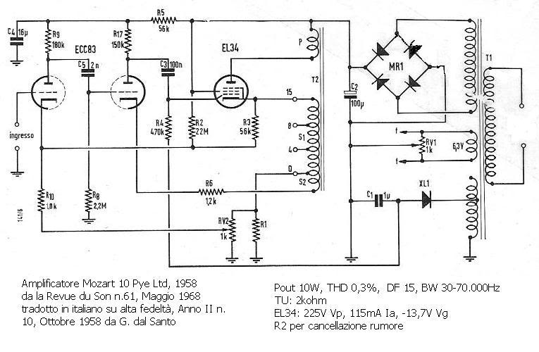

I built a anode shunt and joined cathode amp. It needed careful measurement to get it right. As soon as loop feedback was added I felt it unworkable. UL without loop can be very good and seems not to ring. I have used 82% triode and was pleased it so like triode with useful extra gain. Loop feedback is better if Pye Mozart style. If analysed it looks as if no feedback is being used. I used 16 dB. The output winding 16 R output was used rather than a new winding. I suspect it would allow coupled cathodes, I didn't try. The RCA shown here is a repeat of 1938 designs hybrided with the use of 7199 moded TV tube. The Dynaco could be moded this way. Most do not realise the Dynaco is the RCA idea they used to sell 7199. Hafler just got the ideal price verses quality correct with his own UL used. Perhaps he gave RCA the nod.

Looks like the secondary is the CFB winding for the Pye Mozart

One thing I did was make the output stage SE in PP out, that is g1 of EL34 No 2 is grounded and the pair are a long tail pair. This requied 56 V rms drive. Just what I wanted as it was to be a 211 driver for another day. That allowed PYE Mozart style feedback into the driver pentode. In the end that one ended up triode in to get a nice harmonic balance ( I never did the feedback ). I had UL option which if zero feedback can work. My speakers have no real need for damping so happy to go this way. I got 12 W triode so was happy. I would guess 20 watts UL and 40 pentode. 450V HT. The transformer a Danbury sold by Maplin. The pentode looked workable. With some Kitic feedback I think it could work. The output looked SE in style. My better choice. If not a transistor amp is fine. 1% THD at 12 W no feedback I seem to remember. I would love to post it if the file can be found. After a computer rebuild half seem missing although do turn up in weird places. I tried a 20 % mismatch of valves and had an even better results at 10 watts. The transformer didn't mind. I suspect it's BH curve actually better ( before I get told off this is my specialised field ). If you think about it that is possible. DC Biasing as in cheap tape recorders. M6 metal will cope with that. Sure you can hear the music in the core as a result. One could try 400 kHz also. That should be better and would favour balanced valves, over to you guys on that one as I have said all I can without getting told off by my boss.

I always do feedback by guessing. Not much at first and an oscilloscope to be sure. Even a wirewound resistor is enough to show problems. Back off 6 dB when you find them and 6 db more by ear is usual. That is 12 dB less than the oscillation point, if that is at - 10 dB have a redesign. The reason zero feedback amps sound better is applying feedback with a transformer in the way needs PHD maths or hours of testing. The Mozart trick seems to side step that a bit. Obvious why it should if drawing the reactive parts of an amp as filters. It doesn't take much to get the amp to ring. If UL sounds nasal you have ringing. Most often you do. Last book of GEC designs 1972 show they understood that. Transistor amps always sound best with high feedback levels if an OK design. Valves don't as the transformer is the killer problem. The Schade-Kitic feedback is a very very good idea. Damping factors > 3 already useful ( Wireless World 1955 paper cone speakers like 12Lta use, other Magnepan SMGa ). Ordered distortion < 1% is inaudible ( sorry transistor guys it is ), read Hiraga. If you have panel speakers they might be 0.1%@ 90 dB 1 metre. With an OK CD ( If only, Quad CD67 not bad with 20 bit Crystal DAC ) one can have perfection and not use feedback. Don't try with Quad 2/22, they need feedback, Dynaco also I suspect although less so. The sound without belongs to Joe Meek.
