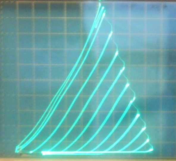

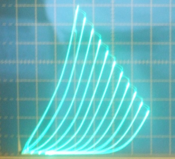

Here is an enhancement mode Mosfet, FQP2N90, with 30 Ohms in the source lead, configured with the same Schade setup as before. (100 K Fdbk R with 20 uF series cap, 22K grid/gate drive R) It has a protection Zener across gate to source and a gate stopper R in front of that, which may be conducting slightly on the leftmost curve, affecting its slope a little.

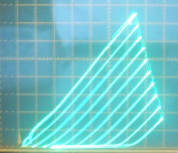

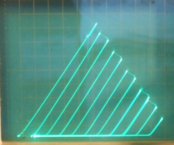

2nd pic is a similarly Schaded Mosfet with a damper rectifier tube in series with the source lead.
By the way, not all damper rectifiers work this smoothly, many have funny irregularities in their conduction curves (not shown on the datasheets either), I had to select the tube for this beauty.
The more consistently clean damper/diode tubes are ones with a filament, rather than an indirectly heated cathode. Although this particular tube was a selected indirectly heated one (better current capability). I do wonder if the usual indirectly heated cathode tubes (triode, pentode) have similar emission irregularities. I have "cured" some badly curved dampers by overheating the heater for a short while. Maybe that is what "burn-in" does for other tubes.
I think if I were making an OTL amp I would use these "triodes".

The 1st pic above was using 50 mA/div Vert., and 20V/div Horiz.?? (Hmmm, maybe not, the slope of the peaks is different from the presently attached curves)
The 2nd pic above was from several years ago, using a different Mosfet, so I'm not sure what the scaling was then. At least 50 mA/div Vert. I would say. I do recall that the damper tube used there was a 6CG3, which can handle substantial current.

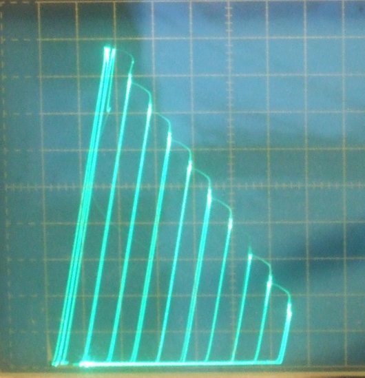

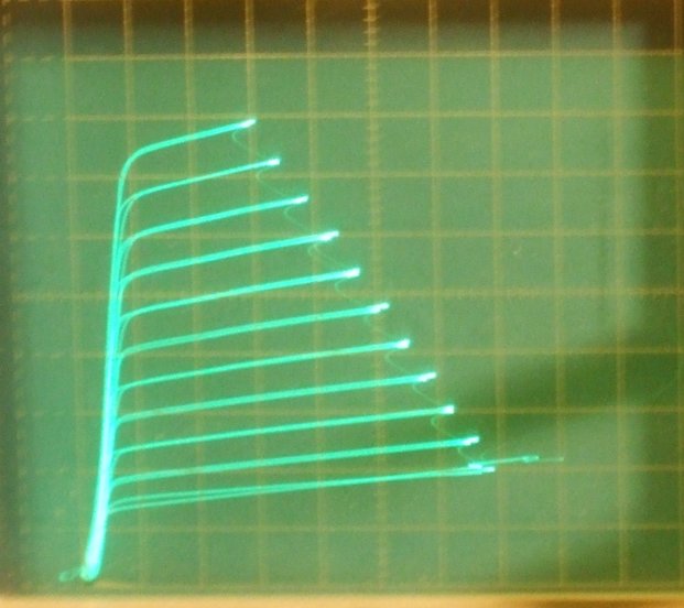

Attached here, is the FQP2N90 Mosfet again in Schade mode (50 mA/div V, 20V/div H), with a 6BY5 damper tube (single section) in the Source lead, NON selected. This is typically what you get if you just pull a damper tube out of the box. Note the "curvy" curves. The majority of damper tubes I've tried (several tube types) have the same kind of "bump" in the curve at moderate current. Over-heating the heater for a while can often fix this or at least improve it some.
I wonder what it would sound like? And do other indirectly heated new tubes (triodes, pentodes) typically have this same sort of conductance curve out of the box? Which maybe straightens out after some burn-in.

Wow. Absurdly linear all the way down to zero current, "plate resistance" on the order of 180 Ohms, and a reasonable amount of gain.

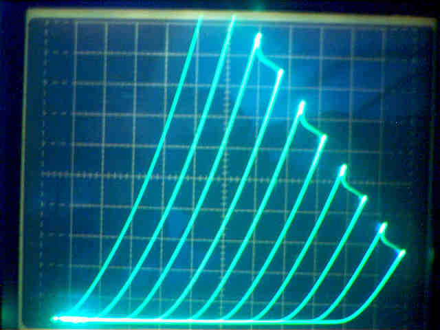

Here is a random 6DQ3 damper with the FQP2N90 in Schade mode. Not too bad, but some slight extra waviness in the curves. 50 mA/div V, 50 V/div H
I bought a box of 150 each of 6CD3/6CE3/6CG3 and 6DQ3/6DU3/6DT3 ($0.35 each) back when they were on sale a few years ago. Somewhere in there are probably some nice ones for Schade Mosfet degenerators.

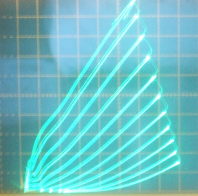

3) 21HB5 with g2 drive and Schading to g1 (20 mA/div Vert)
Looks like some rollover in the curves. Similar to what happens in real triodes, where the feedback and drive are on separate electrodes with different power laws.

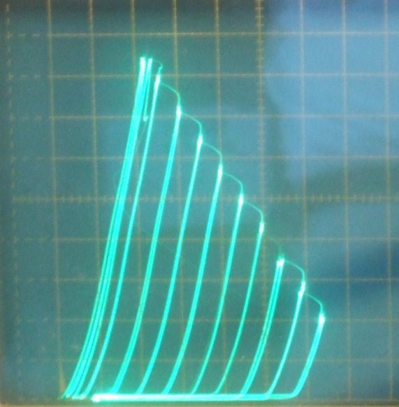

5) 21HB5 with the usual g1 Schade and drive
(Old reliable)
