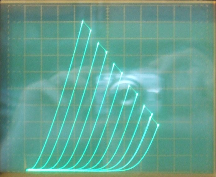

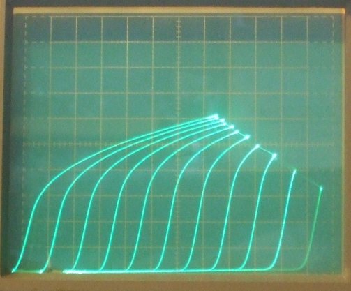

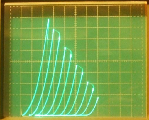

Here are some curve traces for a 12HL7 beam pentode (or beam tetrode for the finicky). This tube does not have aligned g2/g1 grid wires, but does have a frame grid for g1.
1st pic is in "pseudo" triode mode (screen to plate): 0.5 V/step on g1, 5 mA/div vertical, 20V/div horizontal.
2nd is in "pseudo" triode mode: 1 V/step g1, 10 mA/div vert., 50V/div horiz.
3rd is in Schade mode with 100K and 22 uF cap feedback from plate, and 22K from tracer g1 stepper. 2.5 V/step from tracer, 5 mA/div vert. and 10 V/div horiz. 100 V on g2
4th is in Schade mode, everything the same 100K, 22uF and 22K, same 2.5V/S, 5mA/div, 10V/div, but 50 V on g2 this time. Clearly you need enough Vg2 for the peak current needed.
As you can see, the Schade mode is super linear. However, the internal Mu of the 12HL7 is around 25 (in the "pseudo" triode mode curve sets), while the Schade mode configuration here is around 4.54 Mu, so the Schade has got 5.5 times as much N Fdbk here. So one would expect it to be pretty darn good. I don't think I've seen any real triodes this good!

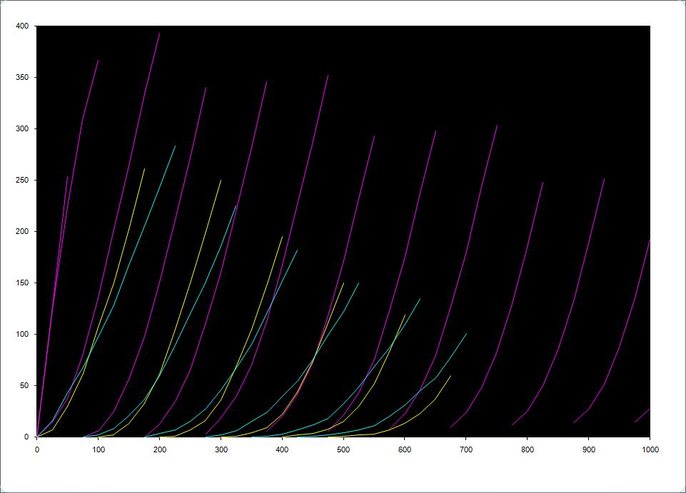

I think I have shared this with you before, probably multiple times, but I followed the procedure in Schade's "Beam Power Tubes" paper for plotting plate-grid feedback curves for 20% feedback on a KT88 and plotted this against KT88 pseudotriode curves and 300B curves, all on the same scale so that they can be easily compared.
Cyan is KT88 pseudotriode, mu is about 8. Yellow is 300B, mu is about 3.8. Pink is KT88 with plate-grid feedback and mu of about 5.
KT88 with plate-grid feedback can outperform a 300B every which way by having a lower rp, better linearity, and higher gain. (Oh, and they're much cheaper, too)
Ever since then, I have been using high-gm beam tubes as output devices and I no longer dream of building a 300B amp.

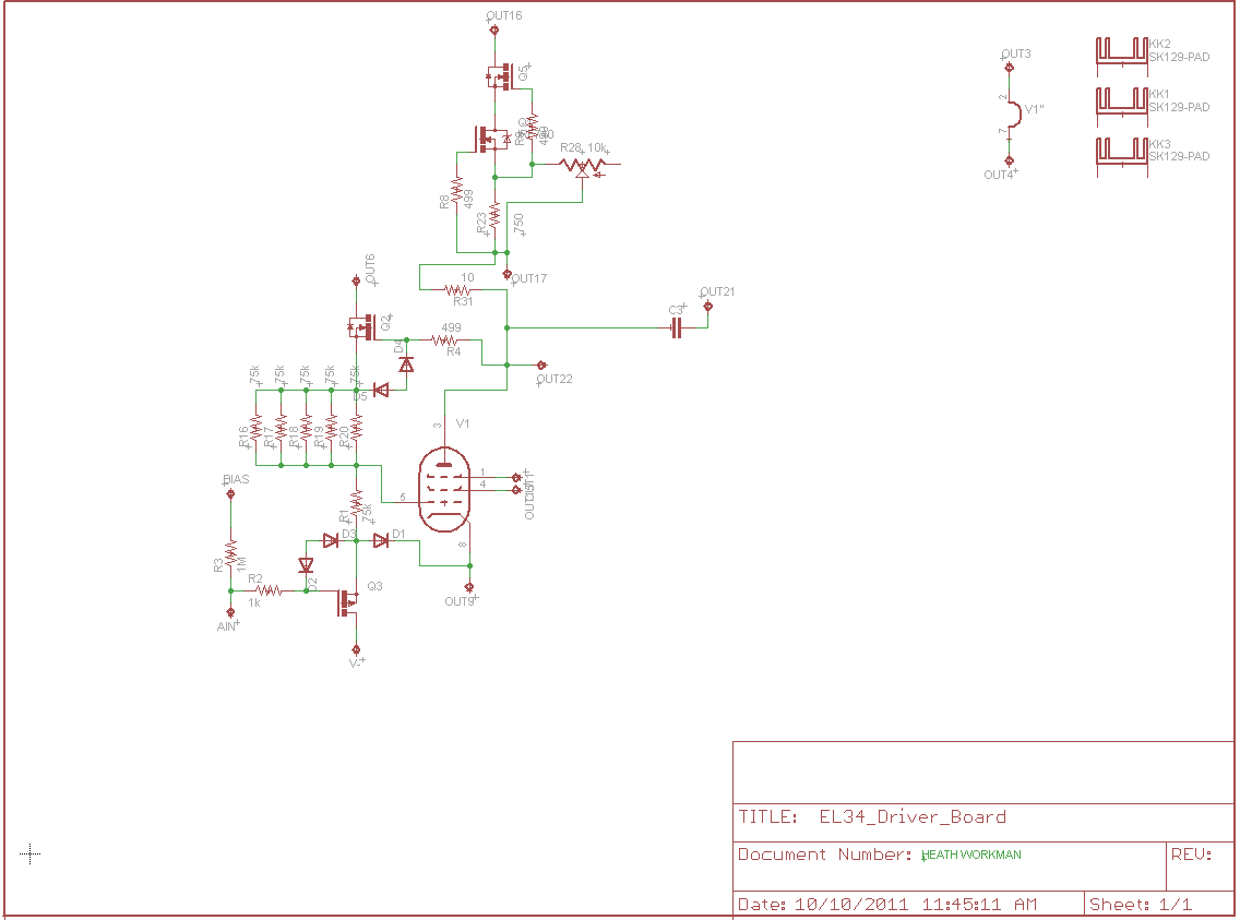

I've been meaning to do an experiment. I want to make a PCB to turn an EL34 (a pretty inexpensive and easy to find tube) into something that can develop a really large voltage swing at low distortion. Something to drive cathode follower output stages and the like.
I did the schematic entry and layout but haven't had it made yet, but this is what I had in mind.(I still need to fix it so that the output comes from the source of the n-channel fet follower and not the anode) I'm hoping it would perform better than the 841-based driver I made for my Unity-Coupled amp.

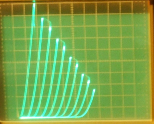

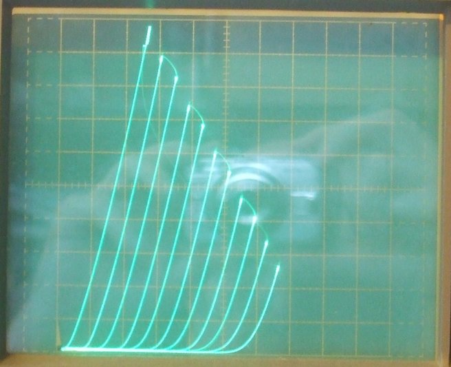

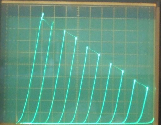

Here are some traces for 36MC6 in "pseudo" triode and Schade mode.
Both are 50 mA/div Vertical, 50V/div Horizontal, and 7.5 V/step, with 82 V on g2 for the Schade version (2nd pic). Internal tube Mu is 4 and the Schade Mu is around 4.54 again (same 100K with 20 uF cap plate Fdbk and 22K grid as before), so comparable Fdbk gains.
Sorry for the poor focusing, my Fuji camera is refusing to focus on the tracer screen lately, took almost 20 tries to get these pics. Maybe tomorrow in the daylight it will work better. The curve tracer has got one selector switch that is acting up too. My old Kodak DVC323 camera used to take perfect pictures every time, but I can't find the software for it online anymore after changing operating systems on the PC. (I have the driver, missing the application softw.)
I just noticed that the Schade curves (above, right side) for the 36MC6 are showing higher Rp than the triode curves. And the triode curves are reaching higher current peaks too.
I think this is just a matter of adjusting the screen grid voltage for the Schade case, when the screen voltage is adequate to get the same peak plate currents, the Rp's look the same. I'll have to watch out for that when plotting curves to compare.
It does look like the Schade curves are more equally spaced than the triode curves, and have less tilt over at high Vp than the triode curves (for the same effective Mu and gm). Probably because the Schade case uses the same electrode for both input and N Fdbk, while the triode case is using two electrodes with different power laws.

In post #27, the data from SpreadSpectrum shows that the curves near Eg1=0V are bunched up, which also shows up in my SPICE sims as well, but there does not seem to be such bunching-up effect on your curve traced scopeshots, what might account for the difference?
It is because, despite all of the feedback we are still operating as a pentode here.
So first, we can look at the Vg1 = 0 line of the *pentode* characteristics and we can know that:
1) We will not be able to go out of that area under that curve *above the knee* without providing Vg1 current.
2) If we try to go out from under the Vg1 = 0 curve *below the knee* we will get nowhere. At that point, grids are swallowing up the vast majority of additional electrons flowing from the cathode and they don't make it to the plate. We can't go to that area and if we try really hard, we just melt grids. We have reached saturation and feedback won't help us get past it.
So the curves bunch up a bit as we get close to the saturation line.
Ahhh, of course.
So actually my plots are starting at some positive plate voltage (like +50 V maybe) instead of 0 Vp.
I just tweaked the position knobs until it all was centered on the screen.
So one needs to avoid too low a plate V or one melts the grids here. Mainly the screen grid. Maybe a good stopper R on the grid 2 will suffice. (Actually, the tracer leads I'm using have a 120 Ohm stopper resistor in the grid 2 lead already. There is also an adjustable current limiter on the screen V supply.)
