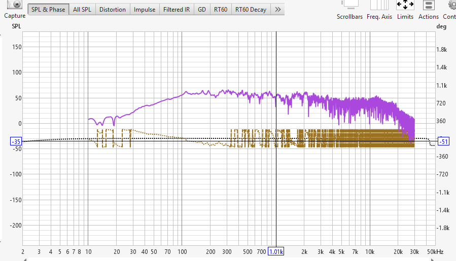

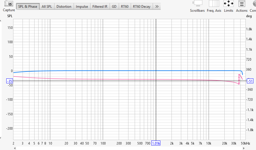

the Scarlett 2i2 in double loopback on the two channels / 1/4 jack to Canon in, for the creation of the file has finally given the expected response. today I bought a guitar amp and as a gift I received the ECM8000. calibration of the card, beautiful linear and the first test / freehand measurement, television on and without the calibration file set for the microphone.
A standard presentation would use 50 dB span on the y-axis. Anything looks linear when using 420 dB ;-)
