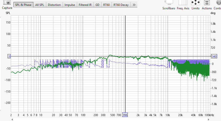

Eccessive variation in a measurement !
this is the result of the graph

"Eccessive variation in a measurement !" - What measurement did you try to do - a sweep?

Gai is a typo - it's Gain / pot that adjusts the Input level of the microphone. I'm not doing any real measurement at the moment, I'm just trying to calibrate the Scarlett and it won't calibrate.
