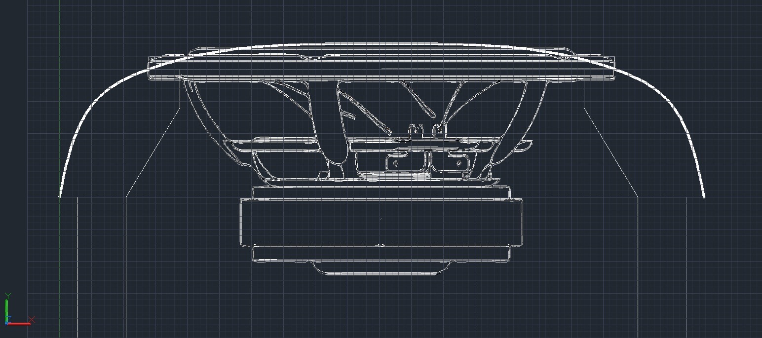

Empty test boxes finished ...large roundovers sculpted from XPS....

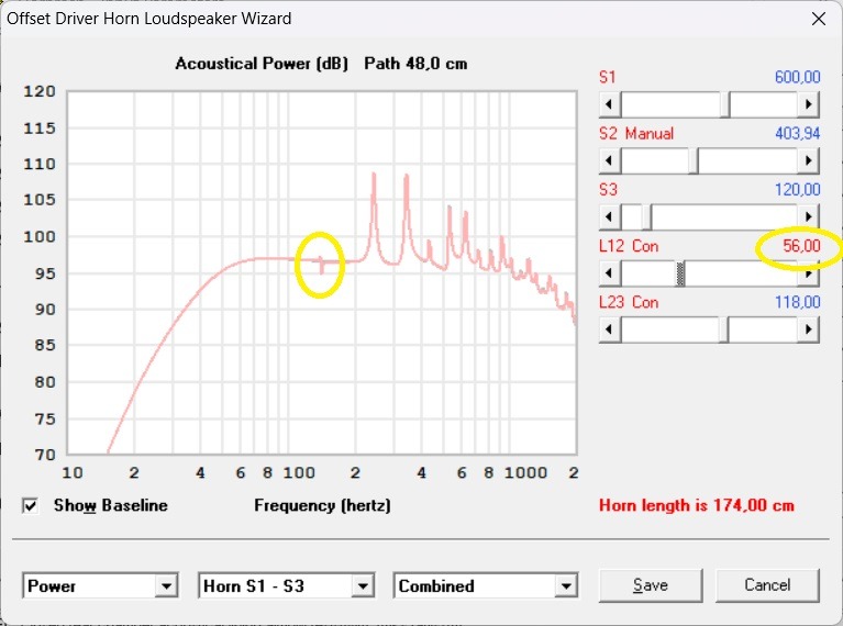

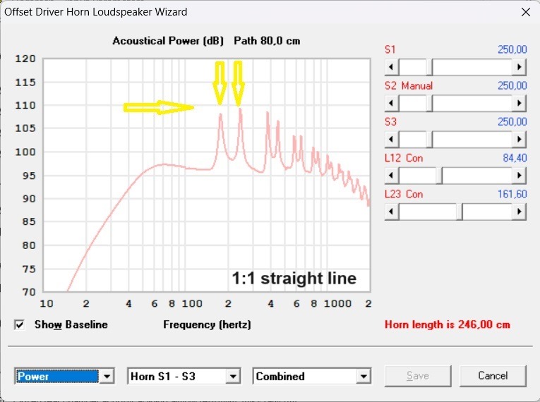

DATS impedance sweeps of empty boxes.... Tuning is at 32 Hz, which is 1.5 Hz lower than according to Hornresp simulation. But real box has fold and terminus is not into the free air but close to the box wall so effectively length is a little bit longer. 3/4 WL resonance should be around 135 Hz, but offset of 56 cm is good so no resonance wrinkle. Response measurement of terminus will show if this resonance is fully supressed. 5/4 and 7/4 WL resonances are clearly visible exactly where they should be at 230 and 320 Hz. It is nice to see correlation with simulation, it gives me confidence that I'm on the right track...Also i'm happy that both boxes are virtually the same.
There are some small parasitic resonances around 200 Hz (internal heght of the box resonance?) in both boxes and of course resonances of 18W drivers around 800 Hz, like in datasheet. It can be seen that this area is composed of one wide and two narrow wrinkles. What I like very much, with drivers in free air or inside the box, is that there is nothing above 800 Hz. Revelators are really drivers with no breakups at the end of their passband...this should help to make simple crossover to the tweeter.

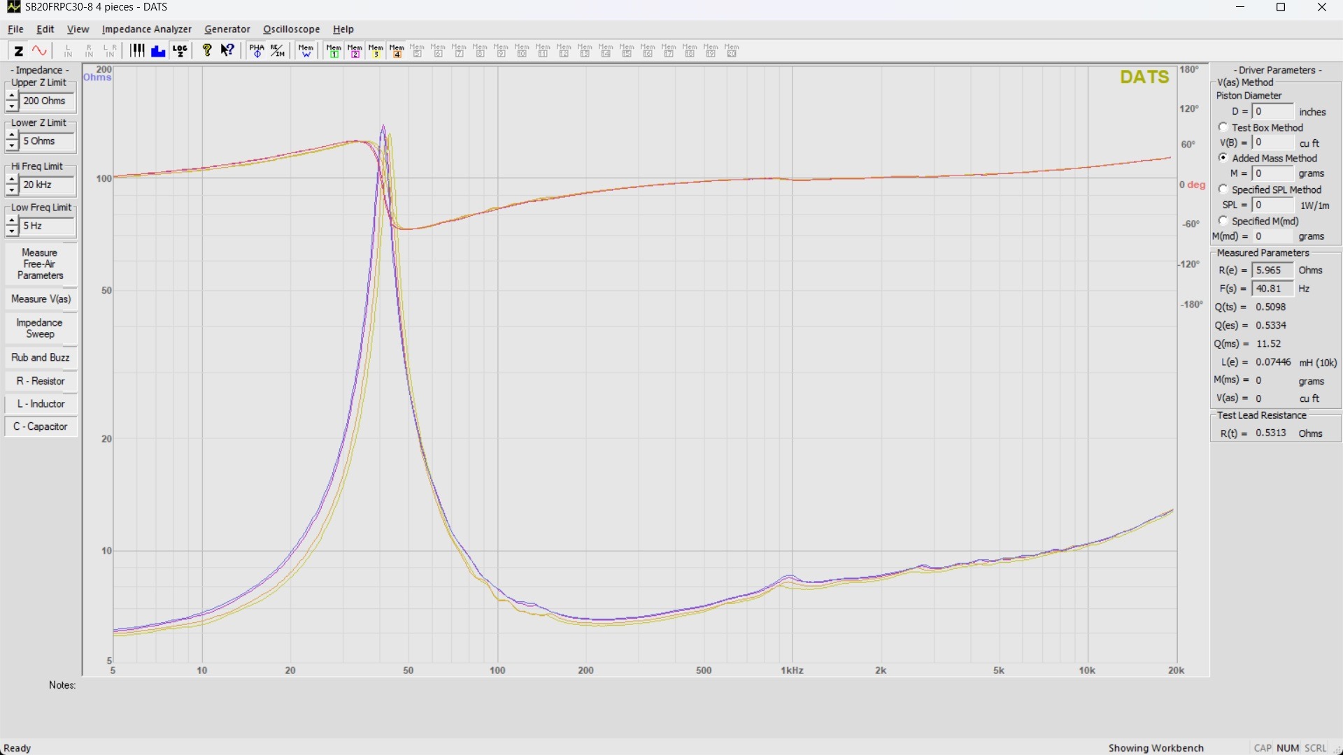

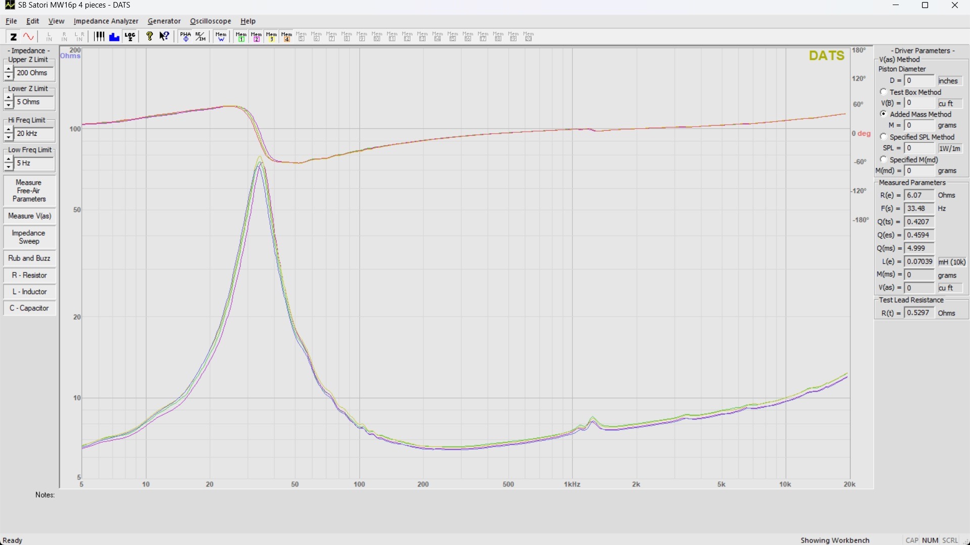

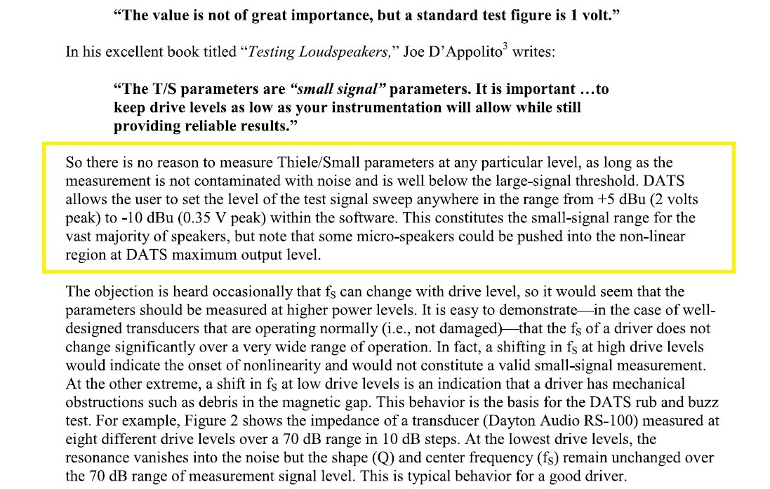

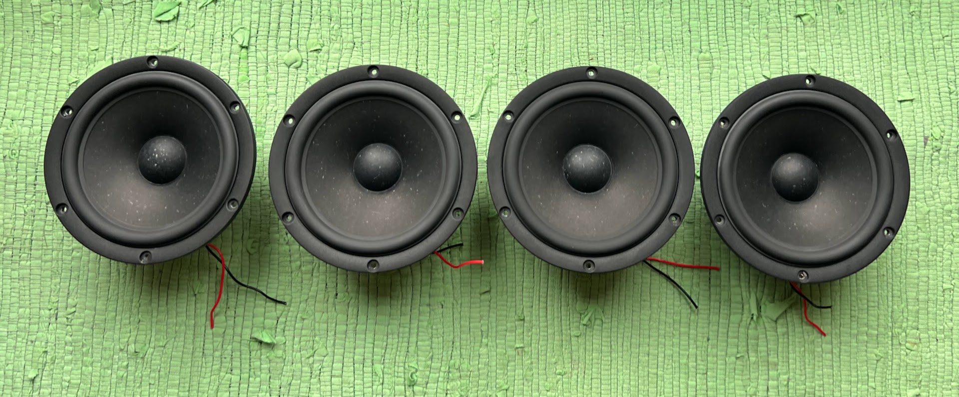

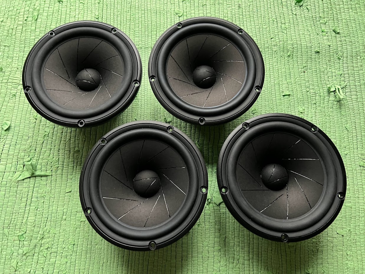

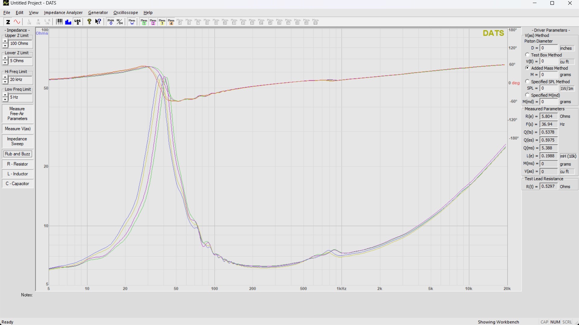

Revelators measured with DATS after some break in period, streched a little bit with 20 Hz signal before measurements. In vertical position, properly clamped, Vas measured with added mass glued to the back of the cone...I didn't want to leave any marks on the front side...9 dBu or 2,82 V used for sweeps.
Qes higher, VAS lower as expected. Fs around 33 Hz, not 28 Hz like in datasheet. They should really change datasheet because no way that these will ever come to 0.39 Qes and 0,36 Qts or 58 L of VAS...
Pair produced in 2023 is closer to specs and has lower Fs, pair from 2022 is a little bit more off. Hope that with additional playing suspension will loose more so they come closer. I made also sweeps with -2 dBu and 4 dBu. With lower levels Fs goes 1-2 Hz higher. I think that 2,82 V is more representative. Also when you do measurement immediately after 20 Hz test signal values come closer to the specs...

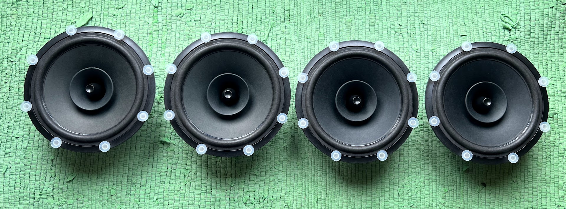

Oh, and thanks to pkaudio for his comment on sealing the tweeters.
They are not OK. Insted of 500 Hz Fs bump I have some kind of vented alignment with two impedance peaks... bass reflex tweeties ...😍
