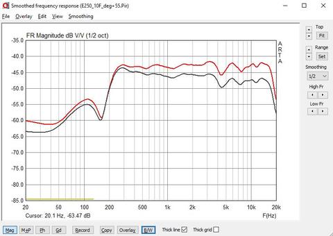

If your looking for “effortless” sound then I’ve had good experiences with putting the 10F/8424G02 in a front horn. Below is the response I get after EQ...black being the summed response of all off-axis measurements up to 60 degrees off-axis. So a good power response into the room.
Yes. Very smooth. No bottom, and the top is rolled off. The 10F/8414 (?) is closer to a FR.
The 8424 is officially a midrang eand it is very good at that.
The 8424 does fit into a very small optimum miniOnken.
http://www.planet10-hifi.com/downloads/nScan-Ken-1v0-071115.pdf
Frugel-HornLite might be able to extract some measure of bass.
