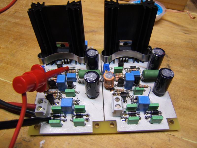

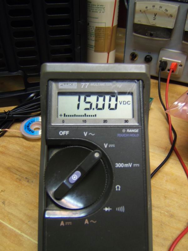

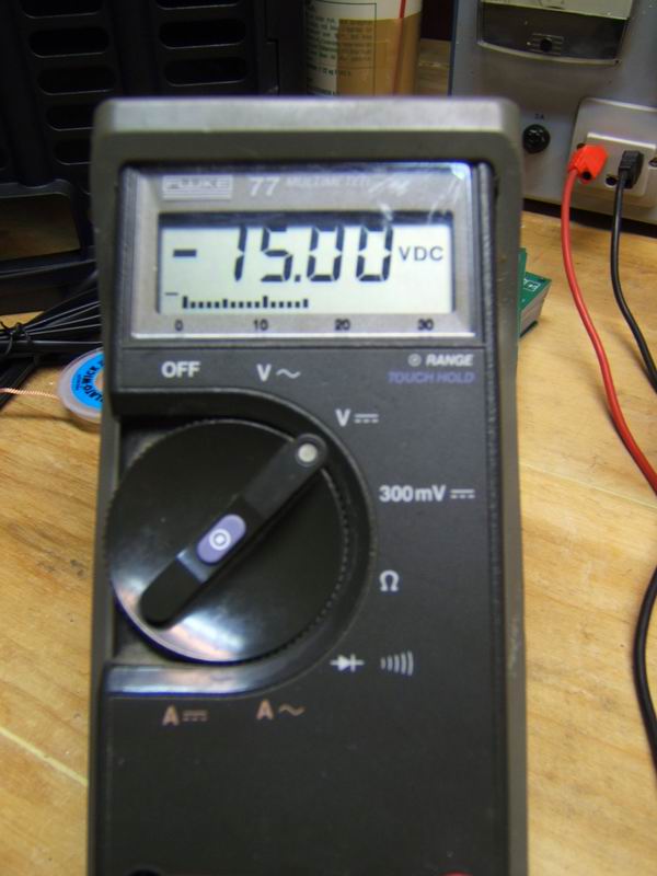

I got the proto boards yesterday......
They seem to work ok, I have to change a few minor things.
Here are some pics
\Jens
Use heat sinks
Testing has shown the need to use a higher voltage transformer. With a 15VAC transformer, the bottom of the ripple was low enough that there was not enough voltage left for the regulator to work with and some ripple showed up on the output.
For 15 volt operation, we recommend an 18VAC transformer. The group buy transformer will have dual 18V secondaries.
This choice, like all engineering choices, has other consequences. The biggest impact for us is increasing the power dissipated in the pass devices.
For reliability we now recommend using heat sinks for virtually all applications.
