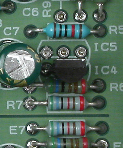

I would like to see the option to insert 431 in lieu of Volt Ref. Is an extra pad all that is required?
Then, see if there's room for the two resistors to make it adjustable.
This would delete the need for trimming the other side of the LTP.
It's easier to design in LM431 and then use a LM329 than the other way around.
The picture shows how it looks like when you have a LM329 in a LM431 footprint.

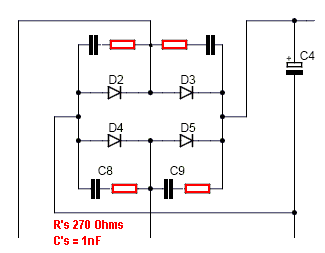

just a suggestion -- you could place a pair of vias between the leads of the caps across the diodes -- this would allow the "constructor" to use an RC snubber (whose value is determined from the transformer leakage inductance) instead of just the 100nF cap across the diode as illustrated in the schematic. Make sure that the drill diameter is wide enough to accomodate the component lead.
