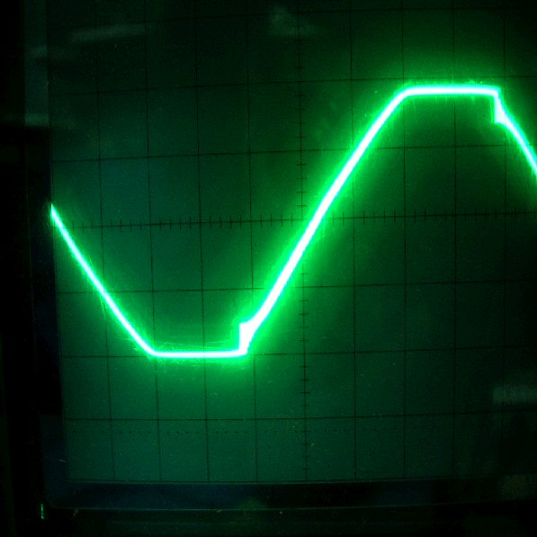

I did hook up the old scope to do some measurements.
Regulator adjusted at 15,00 V load 200mA.
When using a 20Vac 80VA tranny i got excactly 15,00 Volt load or no load.When heating up the voltage dropped 10mV.
With my old scope i couldn't find any 100Hz ripple at the output.
I did find a 5MHz ripple of 1mV PP. I'm not shure where it's coming from.I used shielded test leads.
The input AC just showed a just visible flattening of the sine wave.
Lowering the input voltage to 14.5Vac had no affect on the output voltage.The 5MHz ripple increased to 2mV PP.
The input AC showed clear flattening of the sine wave and some switching artefacts.Couldn't get a clearer picture due to reflections etc.

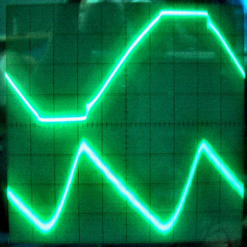

That posted waveform is what exactly? The low voltage AC input to the rectifiers?
Seems almost like a dead short on the transformer when the rectifier conducts. Then the sudden drop in voltage as the rectifiers turn off.
Could you post the post rectifier waveform for comparison (preferably in phase with the input)
just to clarify.
The 20Vac power input reduced to 14.5Vac has caused the HiFreq to double from 1mV to 2mV (seems almost inconsequential) and causes that very clear flattening of the AC input waveform that you posted.
Kro,
Do you have differential probes or has your scope seperate grounds for the two channels?
There is no direct connection from the AC side of the bridge to ground on the board, so I don't fully understand your measurement setup.
\Jens
\Jens
Jens, i used just one ground.(negative side of the rectifier).
I was aware that i couldn't use both ground because it creates a shortcut over the bridge.
I tried separate measurements on one channel.First before the bridge and than after the bridge and the results are excactly the same.
