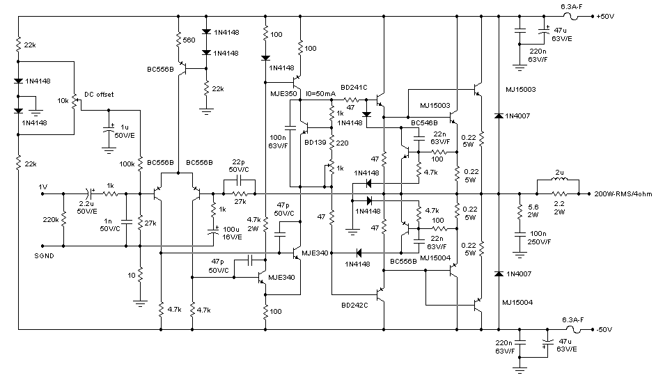

edl said:

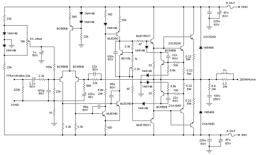

Dear PM650,
a better realization attached.
Best regards,
Fully version attached,
200W-RMS/4ohm, d<0,1%, 10Hz-30KHz

PM650 said:This is a bit off topic, but I would be curious to know anyones comments on this amp schem compared to the Studio 350:
http://www.mustangmods.com/data/2197/amp_schematic.jpg
The reason I'm asking is the amp can be purchased in kit form very cheap ($30) with heatsink, and it seems to be similar to the 350 at a glance.
Let's buy the kitset, and upgrade that this way.
The offset circut can be cancelled, if the DC-offset in the output isn't bigger than +/-100mV.
It will give you 200W-RMS on 4ohm.
mikeks said:Deeply compromised design...![]()
Yeah, I know it, but it designed for PA, and I wanted to keep it simple, using easly available parts.

the amp is firstly designed for MJ15003/MJ15004 output transistors. If I use 2SC5200/2SA1943, the currents could be lower, because the 2sc/2sa pair has higher gain.
Anyway the circut works fine with 2sa/2sc outputs too, but 2×12mA current in the second diffamp is unnecessary. We can use only for example 2×6mA, and than the MJE340/350 transistors shouldn't be heatsinked.
This design is not the state of art, but as I wrote, for PA purpouse its enough.
But we can keep the currents higher, with heatsinked MJE trans'. Higher current here means better quality.
If the offset isn't bigger than +/-100mV (in the most cases it not higher, but I don't matching the transistors, so it can be), the 100k resistor (that goes from the offset-circut to the input) need to be eliminated, because offset adjust is unnecessary.

Can i use anther output transistors for the SC 350? i have 4 pairs Mj15024 / Mj15025 mounted in a DIY Case.
