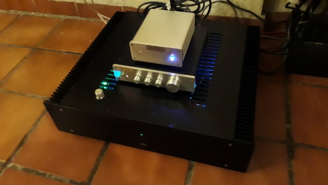

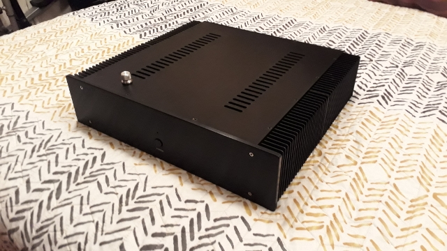

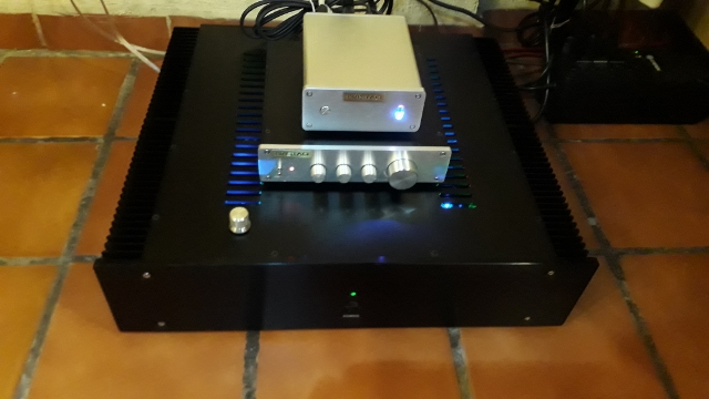

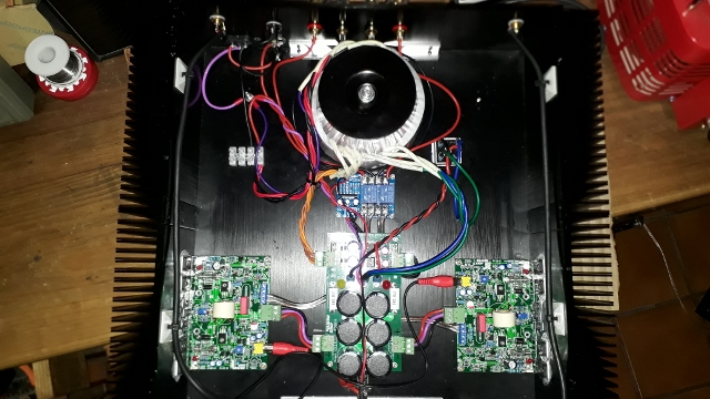

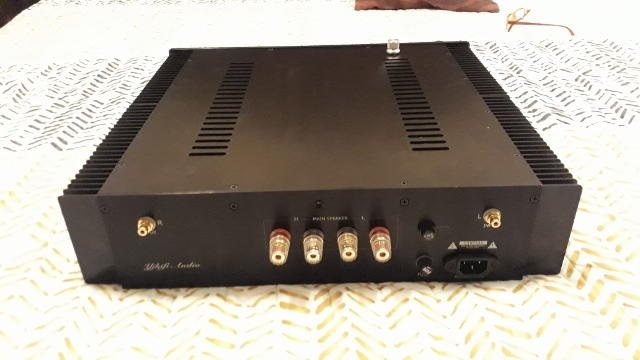

Finally finished the SC200 in stereo. The case is a bit on the large size but its all there was at the time.

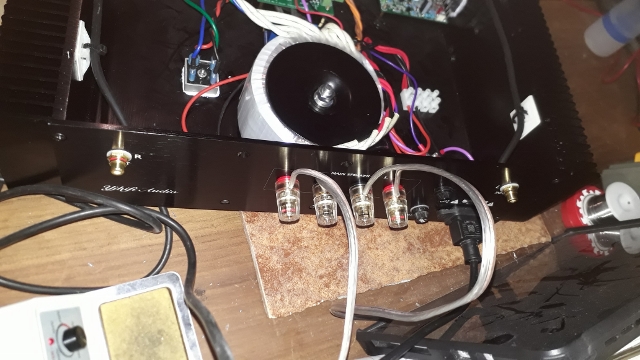

I think I may have made a mistake with the transformer placement and was worried how it would affect the sound being right up against the speaker wires.
I tried to be tidy with the wiring but no chance. Wires all over the place and not sure about wire twisting but I guess I was lucky; no hum whatsoever. It sounds like a dream into 4 Ohm Uni-Fi UB5s; crystal clear and precise.
I had to put the 10k Stepped attenuator in the top cover as the front plate was way too thick for the thread.
Any constructive criticism/layout comments are more than welcome!

The case came with four heatsinks. I never realized they were split when I purchased the case.
I had thought about using thermal compound where the heatsinks are joined together by a screwed plate; however, even one of the heatsinks is larger than the size specified in the SC200 magazine article.
I may replace the rear heatsinks with two pieces of thick flat aluminium and use thermal paste at the joining plate overlap (if it doesn't look too ugly) and use the spare heatsinks for another project.
I've had it on for quite a few hours at high volume, much to the dismay of my wife but it doesn't even get hot.
Still not convinced which way to go though. Probably be too ugly without the uniform heatsink on either side!

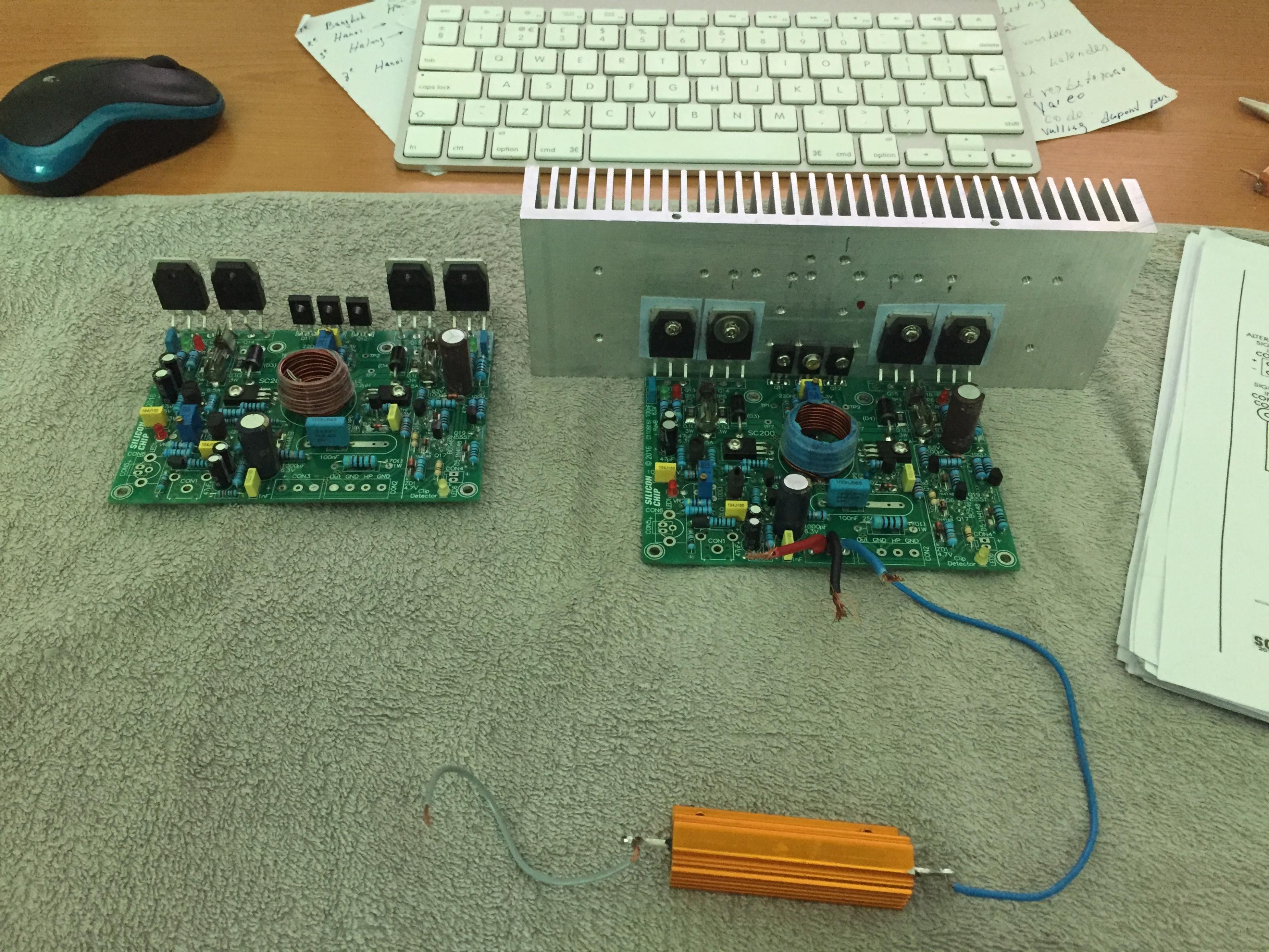

Here is my experience, I have made 2 times the Q-watt without any problems.
But sometimes you like something differents, so I order 1 stereoset SC200 including the difficult parts.
After building and testing with a separate powersupply with adjustable currentlimiter, both prints are not correct working.
First it is impossible to adjust offset at output, I'm reading something about 280mV, second quiescent is also not possible to adjust.
It is strange, both prints gives the same problems.
If I connect a load, (8ohm) at the positive side the current is rising to 60mA, while the negative side still stay at 10mA.

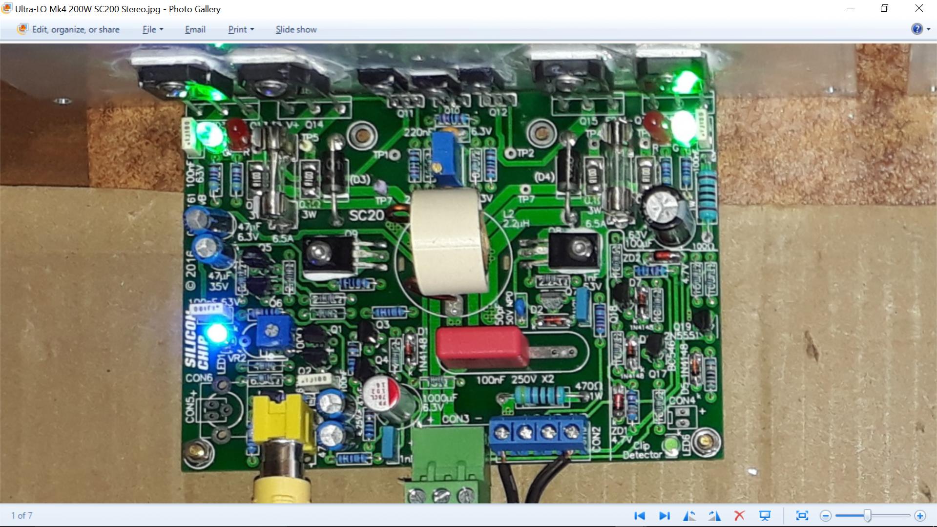

Your Quiescent Current pot VR1 appears to be upside down!
Probably not related but the unmarked resistor above VR2 on the board should be 330 Ohm.
Check the other test voltages on the schematic. Email the guy’s at Silicon Chip magazine, they’re very helpful.
