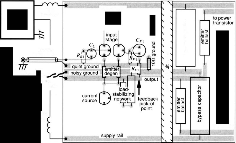

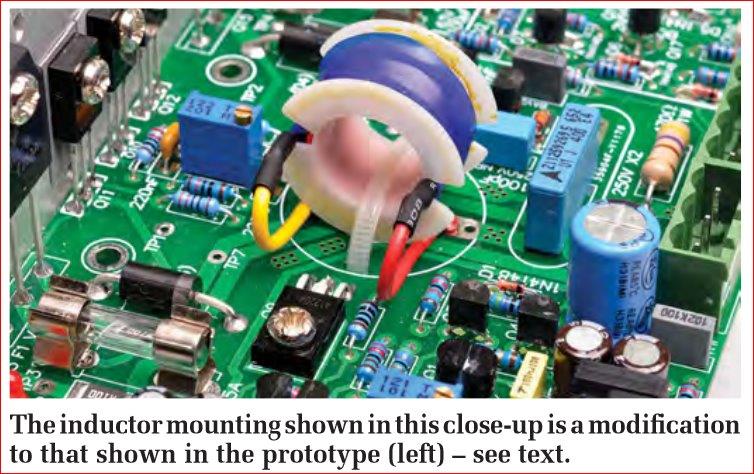

For the SC200, why did SC change the O/P inductor orientation from vertical to horizontal? It also changed on the ULD as I recall.
Looking at the Right-Hand Rule and Cherry's paper on mutual induction distortion, I don't see how a B-field parallel to the PCB (plane) is better than perpendicular.

The AES paper was rewitten as an ETI article.For the SC200, why did SC change the O/P inductor orientation from vertical to horizontal? It also changed on the ULD as I recall.
In that ETI article the fig3 PCB layout can be clearly seen.
It was posted here a few years back, but I don't know what Thread.
Having re-read the Cherry paper I now realise where my current thinking on local supply rail decoupling started from.
Cherry's and other articles appear occasionally in the DIY magazines and much can be learned from them.
I have found the same diagram in another Cherry article:
page 18 of "ironing out Distortion".
It was a Wireless World (Jan 1995) extension to D.Self article.
