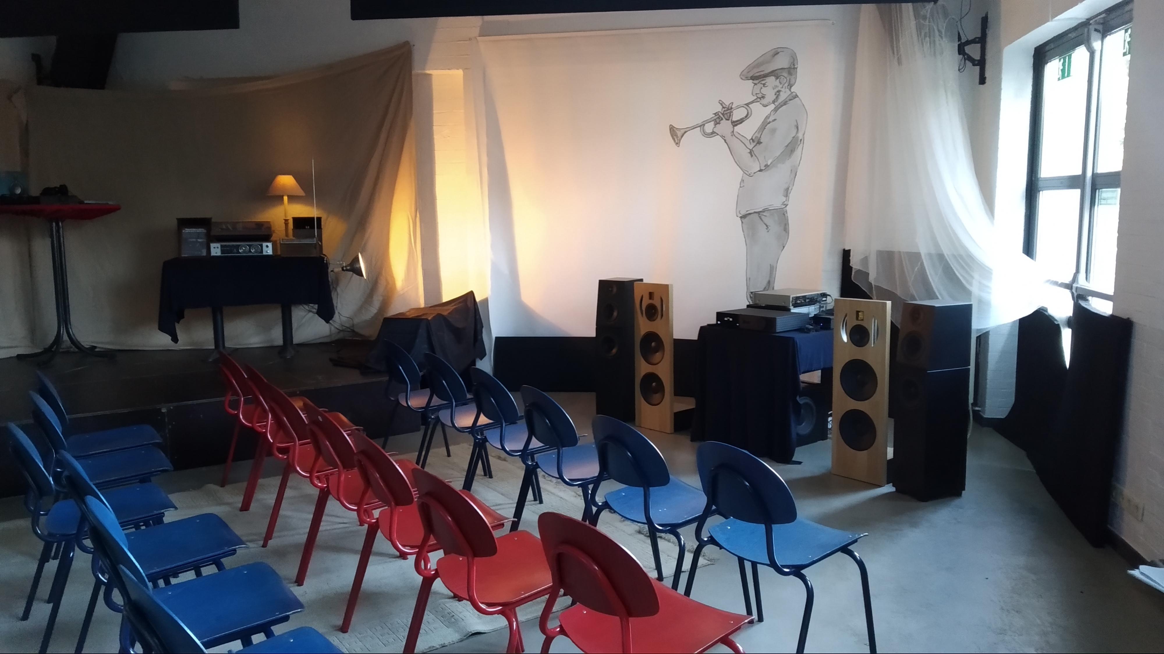

I made a set based on 761 earlier this year and demonstrated it against a clone of the Daudio C-1 open baffle. I find them both comparable in regards to price, looks and performance. For me the OB wins the game with both classical music and jazz music as long as you don't need the highest dynamics because the 761 plays like 12db louder compared to the C-1.
Anyway, the 761 is a good sounding system that needs some attention in the low frequency range, it must fit with the room acoustics and the amplification. I ran it over a Lyngdorf TDAI-2170 with room perfect and that sounded great, although it was somewhat bass-heavy. It had no difficulty to play loud and clean with over 50 listeners in the room.
The open baffle on the other hand sounded better in every aspect but needed a subwoofer to fill the room with sufficiant low end.
In my honest opinion, OB is hard to beat, but ... you need at least 1 meter free space behind the speakers and preferably some DSP or room correction possibilities to compensate for the acoustics.
