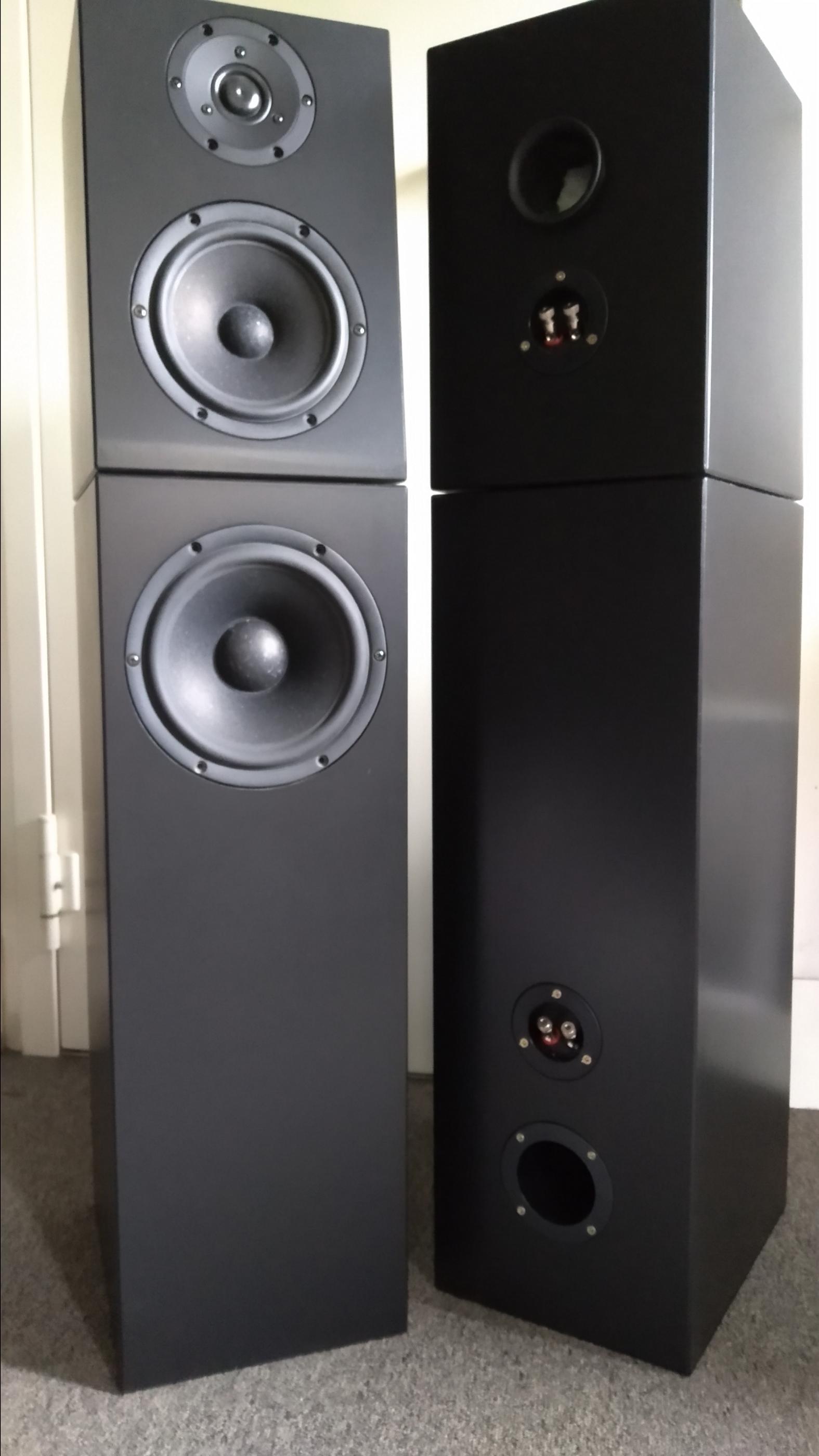

I came across this topic searching for 'Troels 761'.
For what it's worth;
Couple weeks ago I got a rental request for a speaker system to present Classical music on a private location from today 'till the end of the month.
The listening room will have 35 people listening to the music for 2 hours. Speakers to be placed close to a glass wall.
As I only have some OB speakers and full range satelites available at this time, I decided to build an easy and cost friendly floorstander for this purpose.
Instead of doing my own design, I went to the SBA 761 as the concept fitted in what I had in mind.
Finished the speakers on Saturday and they are running in as we speak.

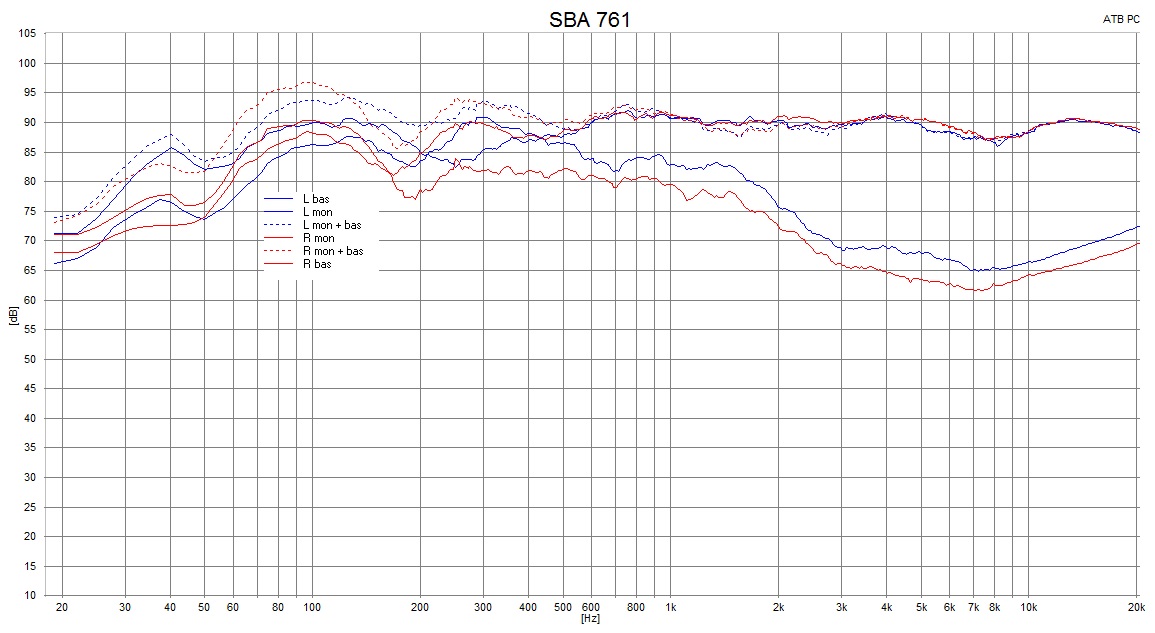

My first impression is that this floorstander has balls! take into account that I'm used listening to OB, so the dynamics of the 761 are impressive to my ears.
There is lots of bass, not sure if I can get more slam and sub out of it after running in, doing some tuning with reflex pipe and dampening material.
Mids are great, I don't like midrange coming from small drivers, so the 16 does it well.
Treble was disappointing when I listened to the first tracks (before running in), there was a clear audible sibilance. I'll check in the next days if that goes better. Looking the measurements I notice an spl increase from 10K to 15Khz, I might suspect that this could be the source for the sibilance.
I copied Troel's design but made 2 separated enclosures, one for the 6+1" and one for the 7".
I also used a plastic reflex pipe in the back panel for the bass enclosure.
The monitor front panel is angled in my units and I decreased the tweeter resister accordingly to compensate for the off axes spl loss.
Installation will be done in the next hours, presentation tonight. I have good confidence that sound will be okay for the classical music.
I'll try to drop a line with my findings in the next days.
They will run on a Marantz 6006 or otherwise Lyngdorf with room perfect if there are acoustical problems (bass) with the room.
As for the attached SPL graph, this is an 'in room' measurement at 1 meter distance using ATB software, the strange behavior below 300 hz is room measurement error.
Some pictures on the construction work can be seen here SBA Satori mon&bas - Google Photos
