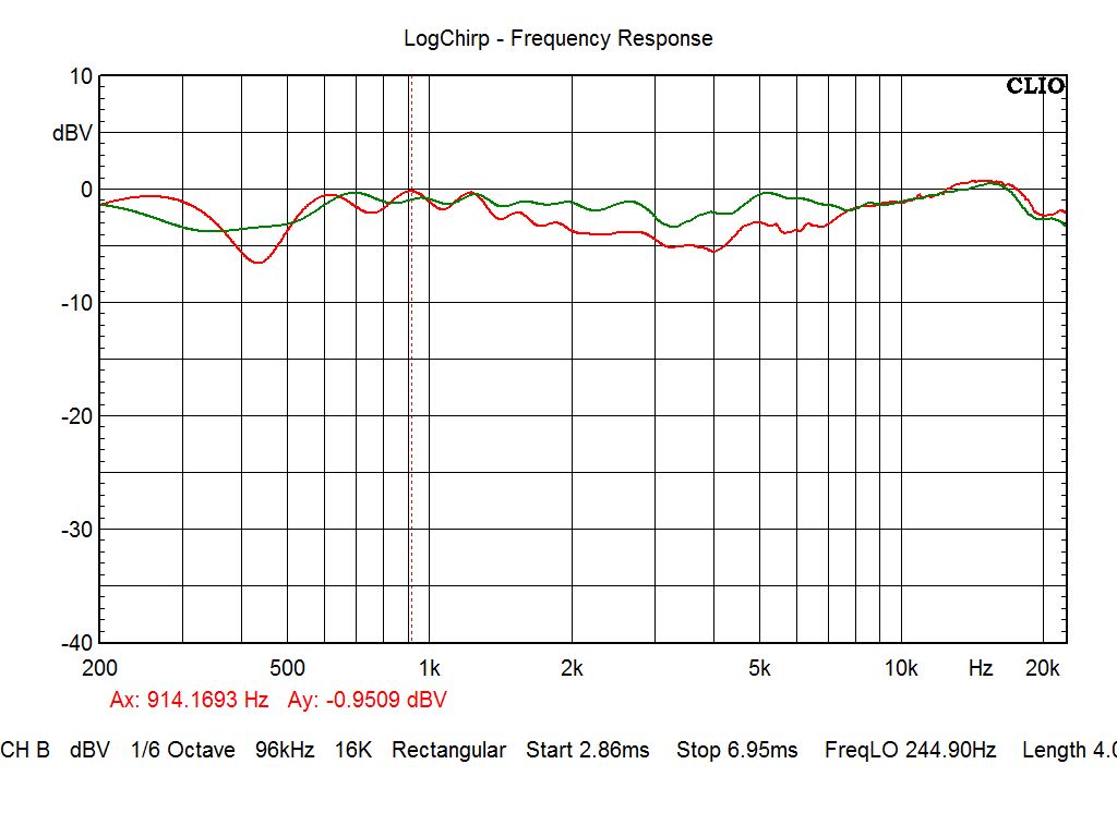

How does the BROMO sound? Any comparision with other DIY builds or commercial speakers?
Bromo sounds quite good, but a bit "soft on midrange", vertical off-axis also is not optimal there. It lead to new build with same drivers and new crossover:
SB Acoustics EKA Ceramic Kit by StereoArt
Attached image: Red on the graph is original Bromo, green is EKA Ceramic by StereoArt. Unfortunately while measure mic calibration was not loaded (take off @10K about 1-2dB).
You may compare EKA Ceramic by StereoArt to Marten Oscar Duo - about same SB Ceramic drivers, but DIY sound better and measures better then 7000$ Marten
