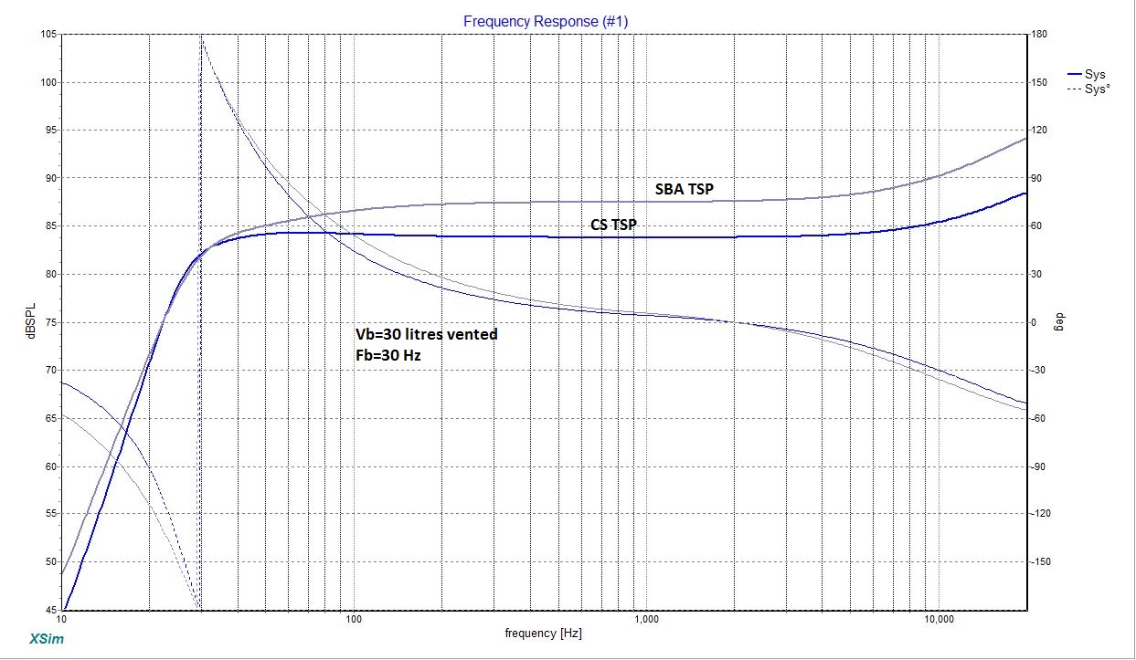

Differences between official and privately measured TSP by CS
I reckon this kind of a comparison speaks a little better what the main issue may be. I have simulated it in Woofer Box Model and Circuit Designer what the response would have been like with manufacturer data and the ones measured by CS member as shown in sample one of the opening post, then exported it as frd in XSim. Even though the data in frd's were only until 1000 Hz mark, XSim plotted it all the way up.

Hi Lojzek,
My cabinets are (or will be) floor standing MLTL types, so a simple box model simulator won't give a very accurate prediction. They don't take into account the cabinet geometry and associated standing wave effects, or the frequency dependent absorption on the stuffing material, or the fact that the stuffing may not be uniformly distributed. You really have to use a true TL simulator to get a reliable result. I use the MJK software.
The drivers as they stand probably would work very well in a conventional TL (either Bailey or tapered), but I already have the wood cut to size for the cabinets (at significant expense), so I don't want to have to start from scratch.
