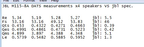

I hope you're right - I measured 4 JBL drivers with DATS2 and they were consistently off compared to JBLs figures. Using JBLs numbers gives a much smaller box. 😀
I bought the DATs2 as I often end up with drivers out of old speakers and thought it would be useful to be able to measure them for new projects. So far none have been that close to manufacturers specs (when available) 🙁

Fair enough - If my measurements are correct I'd either need each box to be an extra 160L per speaker, or use the smaller 'jbl' spec box and nearly twice the amplifier power with EQ. You're correct that I probably can't discern the subtle differences but I'm adding a high pass to the speakers roll off and would like it to happen at the correct frequency to work with my processors fixed 80Hz value.

Yes indeed, and these SB drivers are a good example of that. The fs is slightly high, but the Qts is much larger than it should be. As you say, using the manufacturers figures would give completely the wrong cabinet topology.
